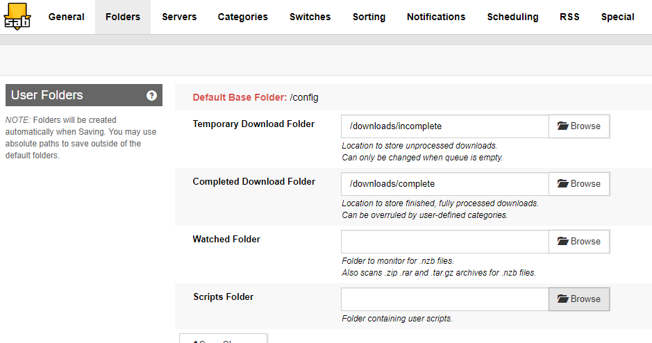

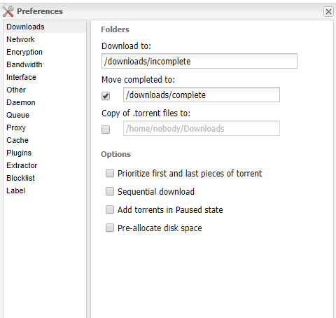

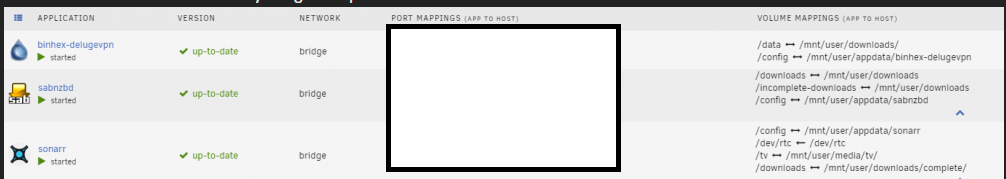

  • When deluge is finished, it's telling Sonarr that the file is stored in /data/completed/..., but you don't have /data/completed mapped to /downloads/completed on sonarr or radar  Add that mapping, and

You error states unable to import xxx from /data/.....
You can tell deluge to download to /downloads, but since you don't have /downloads mapped in the template, it winds up being stored within it's image, and doesn't matter what you do but sab will never have access to it.
Change the container path for /data in deluge to be /downloads
But, deluge (and Sab) may remember the original download path you had set when you queued up files (if it was originally set to use /data in its settings)

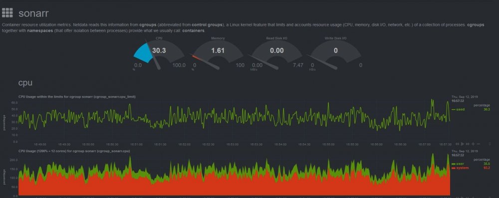

Hi All
Im getting 100% CPU usage on Sonarr almost constantly. Does anyone know why?
I have limited the sonarr docker to 4 cores to reduce the impact but not sure what to do. Radarr is doing the same thing.

16 hours ago, lordvaderxiii said:
Hi All
I get this all the time. I've asked in various threads about it, but I've always come up empty. It seems to only affect some people. In my case, it's caused by NzbDrone.exe running a ton of threads. I limited mine to 2 cores because it makes my CPU temps go crazy otherwise. Restarting the Sonarr docker will temporarily solve the issue. I have a script running every couple hours to restart the container. It's bandaid, but I haven't figured out how to stop it from happening.

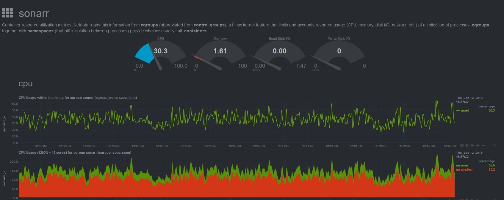

On 9/12/2019 at 9:31 AM, lordvaderxiii said:
Hi All
Here is a pic of the cpu usage
