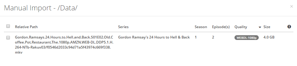

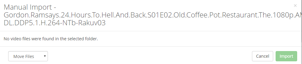

Wanted page manual import:
Activity page manual import:

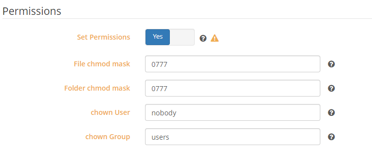

I'm encountering an odd issue  When Sonaar creates a season folder, Emby is not able to write into the folder.  Normally when I had Emby handling the autoorganize, it would create the folder, copy the video file to the folder and then create an nfo file and a thumbnail.  I stopped Emby from doing the copy of the file, which Sonarr now handles.  But after Sonaar copies the file, Emby is unable to create the thumbnails.  If I create the season folder first via logging in and using MC, Sonarr will copy the video file and Emby will create the thumbnails.  So Sonarr must be creating the folders with some permissions but I'm not sure how to change or fix this.  Any idea?
Settings - Media Management - Advanced Settings
Ok thanks, will make those changes.  I'm guessing that won't change any existing folders once I save that.  Is that correct?
Still having a small problem.  In the Sonarr forum I was asked if I'm running Sonarr as Nobody.   When Sonarr is installed, when it runs what user is it running as?  When it copies a file to disk, what user owns the file?  I've been looking around but other than putting in Nobody in the Permissions, I don't see anything else.
