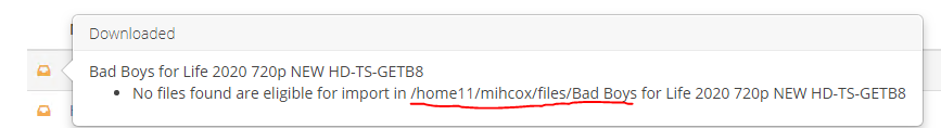

I have had my server running for a while and noticed a problem using the "Remote Path Mappings". I have the external share set to "/home11/mihcox/files/Completed/", but when i go to the import page i get the following error:
I have my "Remote Path Mappings set to a remote path of: /home11/mihcox/files/Completed/
What i see on the Activity page: No files found are eligible for import in /home11/mihcox/files/Doctor.Who.2005.S12E05.HDTV.x264-PHOENiX[eztv].mkv
Error Shows: Import failed, path does not exist or is not accessible by Sonarr: /home11/mihcox/files/Doctor.Who.2005.S12E05.1080p.HDTV.H264-MTB[rarbg]
Why does the location i have configured not match the location it is looking in, it is missing the “completed” folder

That is not my issue. See the screenshots. The location that i set in "Remote Path Mappings does not match the path it is looking for.
I dont see how what you linked explains why the location i set does not match the location it displays back to me. This external location i have confirmed exists,but it does not list this EXACT location as the location it is looking in.
Radarr is looking for the file /home11/mih... but it doesn't have access to that.  It only has access to /downloads.  The link @jonathanm gave you applies
Maybe i dont understand what youre suggesting. This is for "(AKA Linking between containers)". This is not my case, i have one local container, and one external container on a seedbox. I used the following guide for setup from spaceinvaderone:
Again, apologies if that applies to me too.
Whoa, context switch, I was probably wrong then.  Thinking about it...
