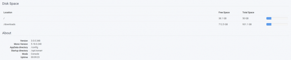

I seem to be having some strange issue with my /tv folder mapping that is preventing Sonarr from creating new folders or something.
So I recently replaced a 4TB drive with an 8TB drive and the rebuild process took about a week. During that time, something happened and both Sonarr as well as Radarr threw up lots of missing titles. I knew they were there, as I had just watched one of them days before, but I suspect it was stored on that drive that I had updated.
Even though unraid tells me the contents of the disk is emulated, I was unable to access the disk and (like I said) things on it were not accessible from Sonarr/Radarr.
During this rebuild process I also noticed Sonarr/Radarr being unable to import newly added things. It was find with replacing items that I already had (and it already had access to) but importing new items from Sabnzbd were throwing up an error. I assumed it was because of the disk that was being rebuilt so I waited.
once the rebuilding of the data was complete, I restarted unraid and sonarr/radarr were able to see those things that it had previously marked as missing
the thing is, during this time I noticed that in the System section of Sonarr/Radarr, it was not showing the media folder for them. here, you can see the folders I have mapped right now in the sonarr UI (attached image 003 screenshot). but in unraid's docker editor page (attached image 004 screenshot), you can see I have the /tv folder mapped as well (it just isn't showing up in the sonarr UI and I think that is causing the importing issues

I think this was due to some corruption. I used the webui to check my disks and fixed 2 of them that reported errors. I'm no longer having issues importing items with these (I still don't see the tv/movie folder in sonnar/radarr webui though, but maybe that's normal)
thanks for the great work everyone!

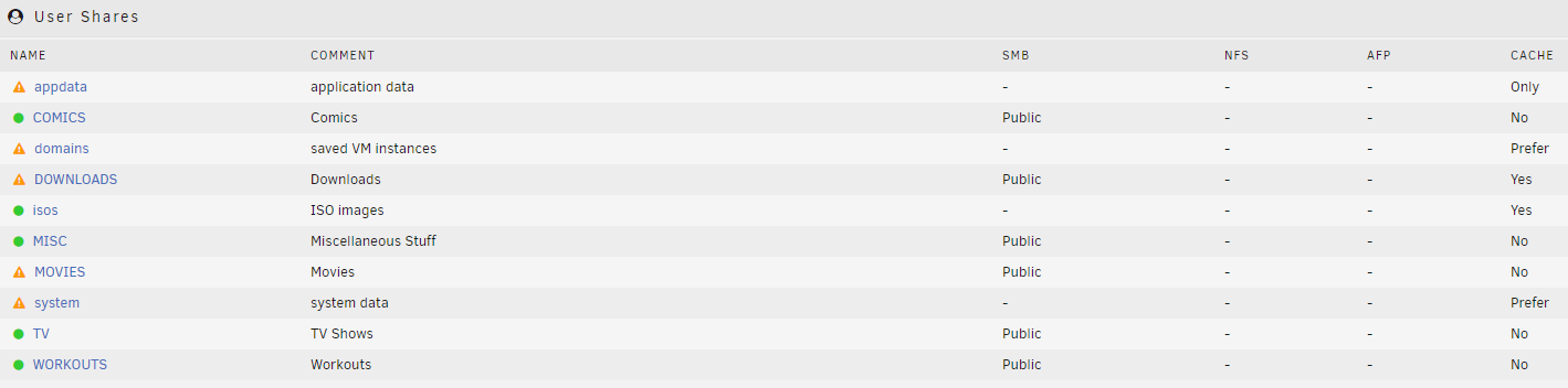

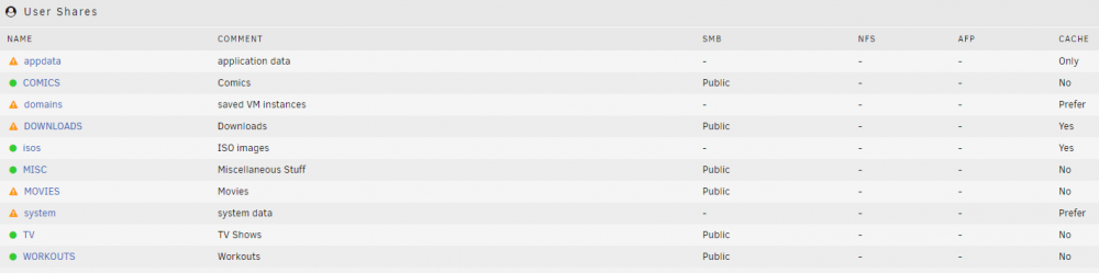

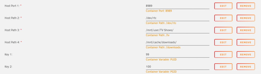

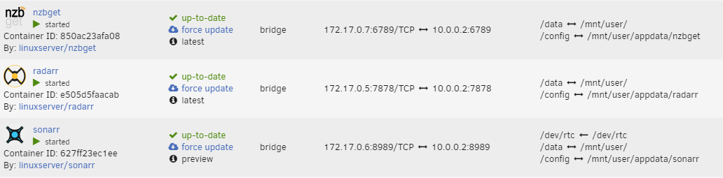

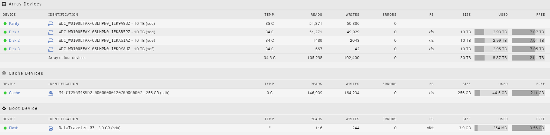

I'm running into an issue that I'm trying to remediate, but I'm getting stuck. I am running the normal combo of NZBGet, Radarr and Sonarr and I had everything "working" appropriately but I noticed that whenever NZBGet would finish a file it would take Radarr or Sonarr forever to finish moving the file. From everything I searched for it looked like it was a hardlink issue and that the best practice was to point the mount for each docker container to the root (/mnt/user) and then navigate from there within each application to the appropriate shares. Once I did this, the speed issue was solved, but now I'm dealing with another problem (I'll stick with Sonarr since I'm in this thread). Now, when the download finishes in NZBGet (all work done on the cache drive, appdata share set to cachedrive ONLY) it moves the file to the TV share, but it also puts it in a new folder on the cache drive called TV. I have the TV share setup to cachedrive "NO" so I am not sure why it's creating a folder on the cache drive called TV and then the subsequent folder under there. I'm wondering if I need to re-setup my shares.
I'll edit this with a couple of pictures once I get this approved. Thanks!
Edited by slackmountain
added pictures
The reason for this is because you're using a mapping of /data <--> /mnt/user
The way every OS (including Unraid) works is that when moving a file, it first attempts to rename it to accomplish the move.  In this case, you're attempting to move a file from /data/completed/... to /data/TV Shows/...
Because both references are within /data (the same mount point), the rename will succeed.  This has the result that the file never actually "moves" and may in fact be technically outside of the constraints imposed by included / excluded disks, the use cache settings etc.
Your solution is to ether set TV shows share to be use cache:yes, or to go back and use separate references for the downloads and for the media share.  I wouldn't consider the time it takes to physically move the file from the cache drive to the array as being "forever".  If you've just spent the time to download a file, the extra time required to move it into it's final resting place shouldn't be a major issue.
Yeah, thanks for double checking my work and I decided to just deal with the file transfer delay. I think long term it won't be a big deal, it just becomes an issue when I'm trying to do mass file upgrades (from 720p to 1080p) on all shows in all my folders. I'll just slowly do these a folder at a time rather than hitting the entire share. Thanks again!
Real quick followup. I went out and picked up a new SSD (Samsung 860 EVO 1 TB) since my 250 GB Corsair SSD was 8 years old and kept filling up whenever I was grabbing large files. There is now a night and day difference in performance, so I'm wondering if there was some bottleneck/issue with the old SSD. Nice to see it humming along now and barely using the CPU at all even though it was pegging every core previously!
