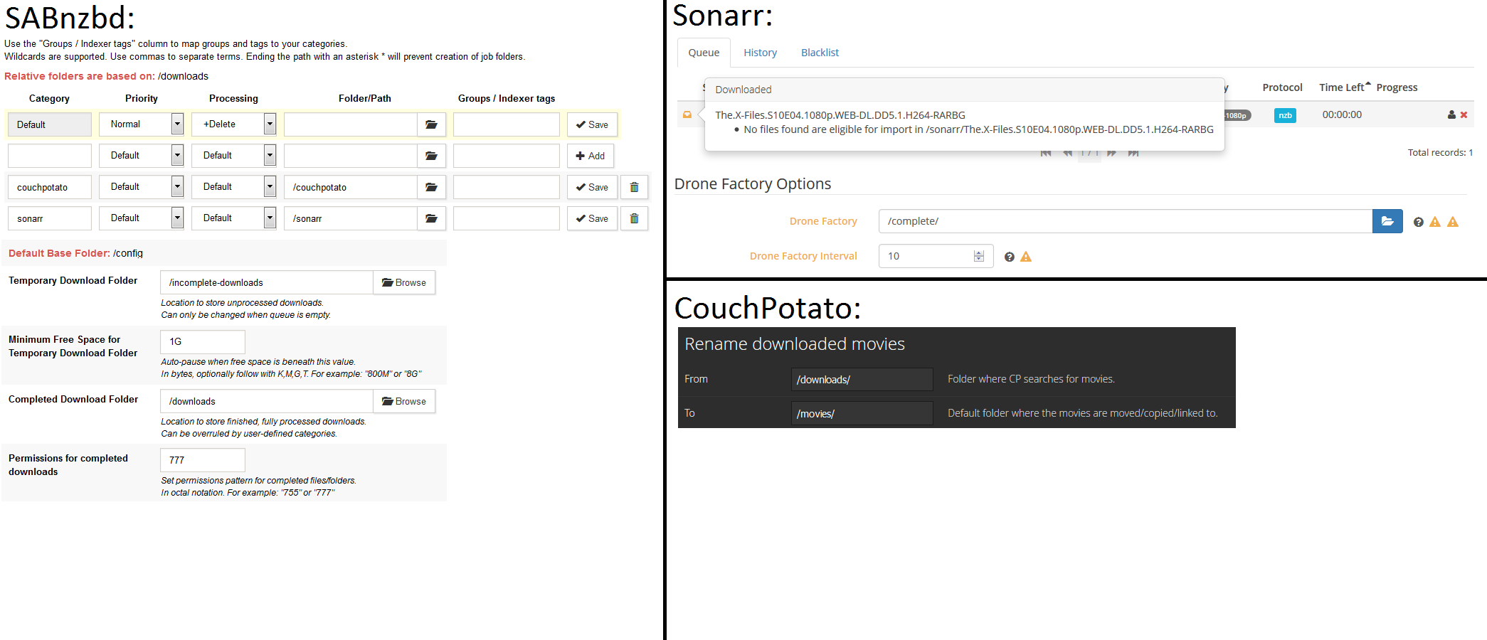

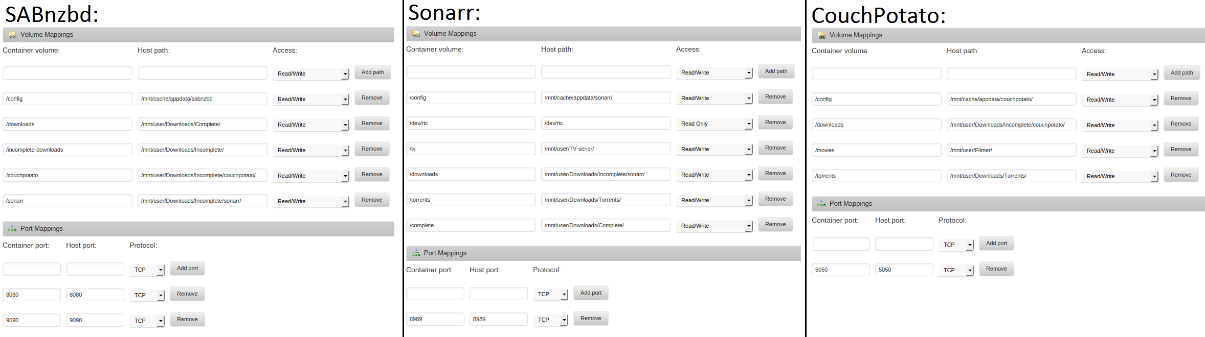

Hi, I am having problems with Sonarr and moving them to my TV folder after SABnzbd finishes the download. My setup works 100 % for CouchPotato, but Sonarr refuses to move the finished downloads. I get the following error message in Sonarr when it tries to move the download SABnzbd has finished: "No files found are eligible for import in /sonarr/(Series name)"
I have attached a screenshot of my unRAID volume mappings for SABnzbd, Sonarr and CouchPotato (I included the CouchPotato setup because it works).
I have also attached a screenshot of my settings within SABnzbd, Sonarr and CouchPotato.
Does anyone have any idea why Sonarr fails at importing the finished downloads?
Edit: Is there any point in using separate folders for Sonarr and CouchPotato, or should I just keep it simple and use a Downloads/Complete folder for both? The reason I set it up this way is because of my old setup on my Windows server, which followed this guide: http://www.cuttingcords.com/home/ultimate-server/newsgroups-and-sabnzbd - If you have any default or standard setup you would rather recommend that I use, feel free to enlighten me :-)
Personally I find /downloads ==> /mnt/cache/downloads across all containers works for me.  It is static and then when I'm configuring anything in a container I have the same starting point if that makes sense.  Otherwise it gets way too confusing.
So if sonarr and sabnzbd are both mapped as /downloads  then if you tell one /downloads/sonarr then when they communicate they're both referencing the same location...
Looks like Sonarr is erroring trying to find /sonarr, which you don't have mapped in Sonarr's Volume Mappings (from the screen shot, you may have it mapped to /downloads)
This is how I do it and my setup works flawlessly for Sonarr and Couchpotato.
Thank you, using /downloads/ instead worked great!
