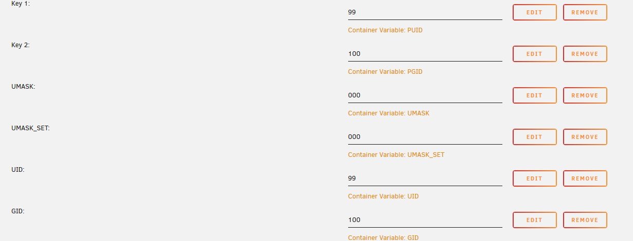

UMASK value and files permissions incorrectly set, or at least I believe them to be.
I originally had the Binhex version of Sonarr installed, but wanted to use v3, so I 'migrated' to the linuxserver version by changing the Repository value to linuxserver/sonarr:preview and hitting apply. This all worked without a hitch and all data was kept and everything worked as it should.
I recently noticed that a lot of my file permissions on unRAID were set incorrectly, so I fixed all those using chmod and chown. After noticing this I set all relevant dockers; NZBGet, Radarr, NZBHydra and Sonarr to have the UID = 99, GID = 100 and UMASK = 002. Based on all the info I've read a mask value of 002 should give 664 for files -rw-rw-r--. However, after the file is imported by Sonarr and renamed, the file permissions keep showing up as 644, -rw-r--r--.
I did notice that the Binhex version of Sonarr has the UMASK key value as "UMASK", where this version is "UMASK_SET". I have since modified this, reloaded the docker, but the files keep showing up with -rw-r--r--.
My last ditch effort would be to completely remove Sonarr, install it again, and start over to see if this fixes the issue.
I figured I might as well ask here 1st to see if anyone has any input as to why this would occur. I looked at the file through the terminal, while it was still in NZBGet and the file permissions are what they should be -rw-rw-r--.
Anyone have any ideas?

I am having the same issues with sonarr permissions. Everything seems to have the wrong permissions. I did a clean install of the preview branch.
At this point I have to run the permission fix tool every time I want to mess with the files.
6 minutes ago, LateNight said:
@unRAIDuser7 @TexasUnraid have you tried the "Set Permissions" option in Sonarr, as explained at:
I saw those options but no explanation of how they work so I didn't mess with them. Still pretty new to linux and don't fully understand the permissions.
From what I know 777 is full permissions and what I would want on the files, so why does that show 0644 and 0755? Wouldn't that limit permissions in some way?
Also, seems there are 2 ways to adjust permissions in linux, one allows you to set permissions and the other only allows you to subtract permissions? I was not sure which one this used.
I just took the brute force approach and added every permissions variable to the docker I could find and so far it seems to be working
Sorry, should have linked to the second response and not the thread.
I was also having permission issues until I enabled the Set Permissions option. I did change the chown User to 99, and chown Group to 100 but it appears either works.
If I have anymore issues I will try that then, although in V3 most of those options have been removed, you only have the file chmod option now.

In the end, this is what I ended up doing, setting the permissions within sonarr/radarr itself.
I don't understand why the UMASK variable doesn't work from within the docker settings. If it doesn't work, then why even have it in there?
