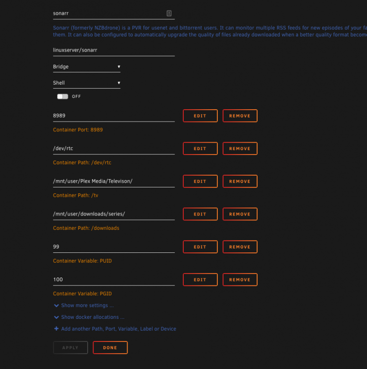

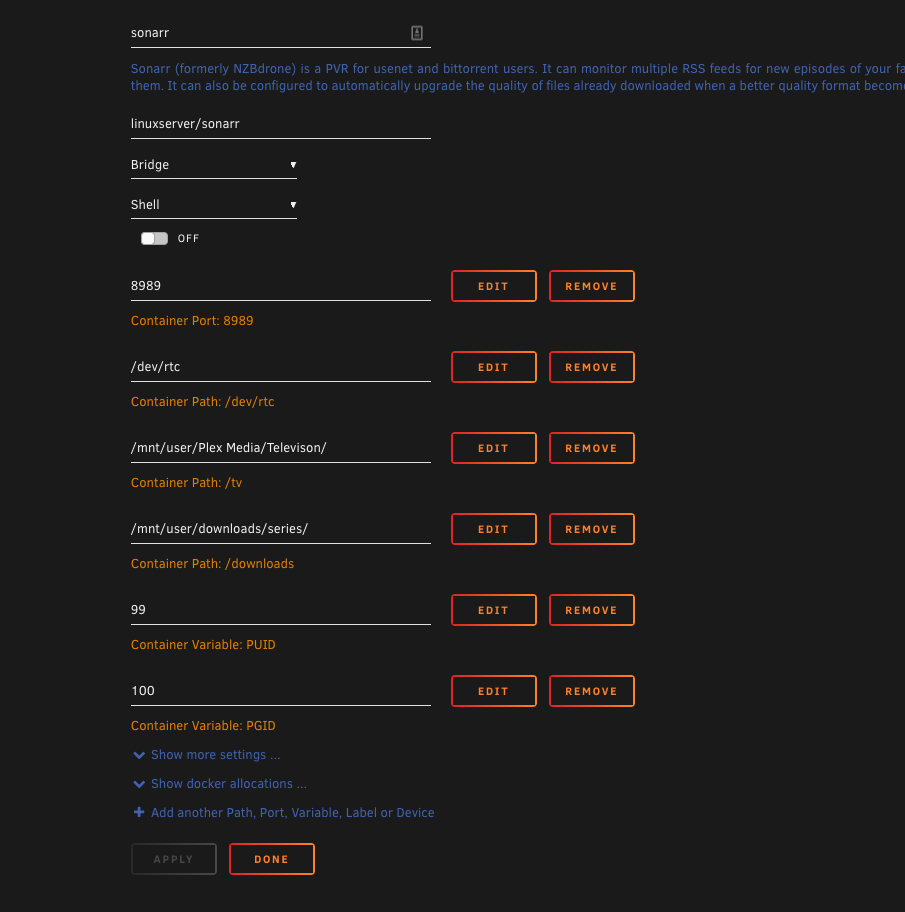

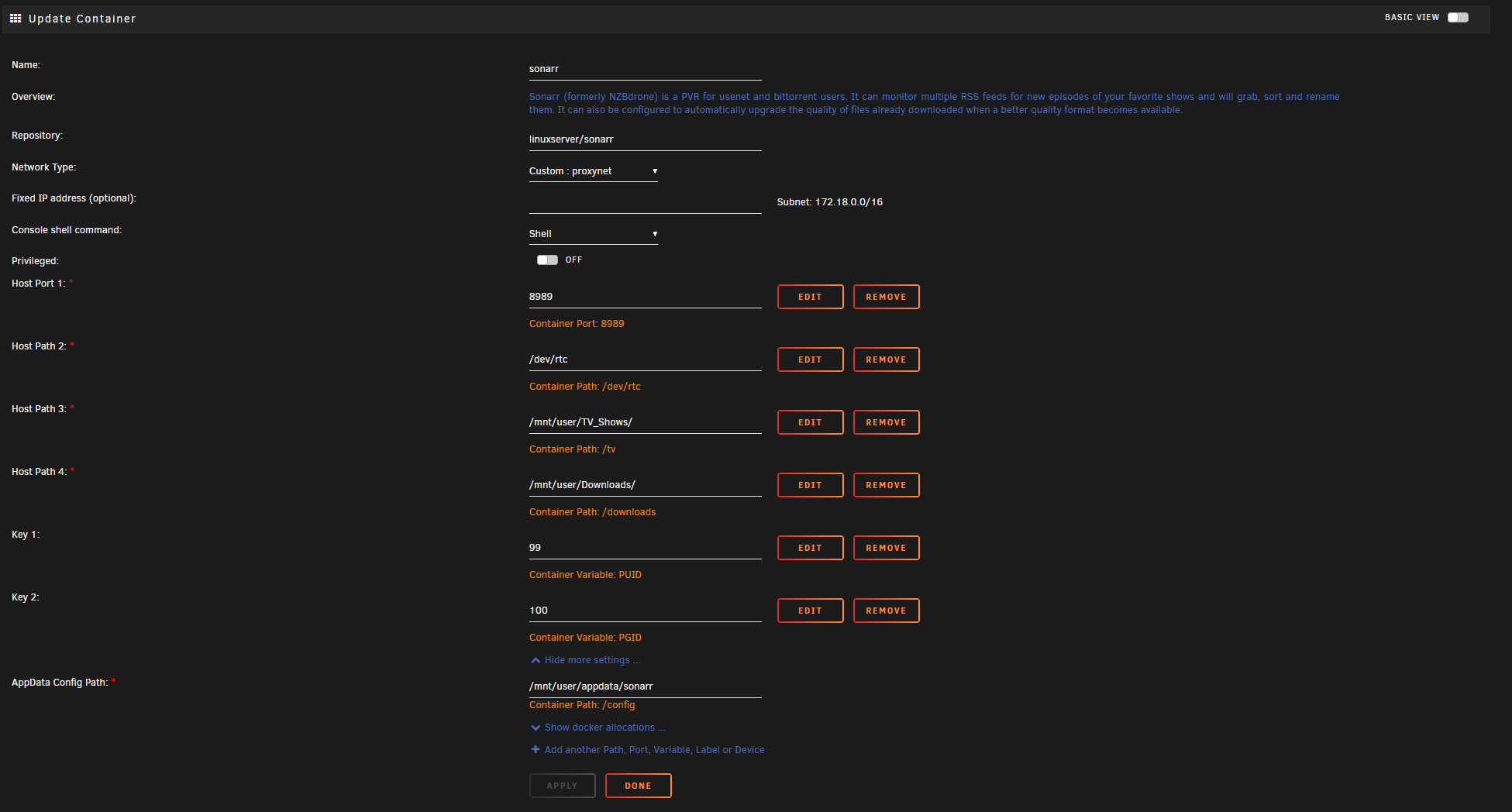

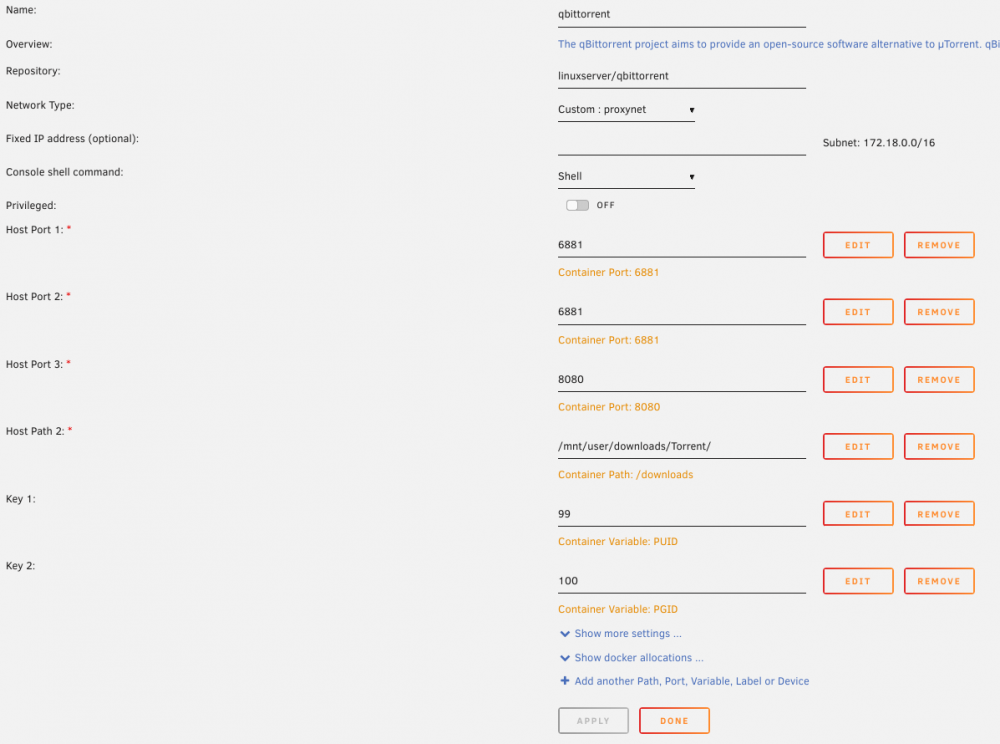

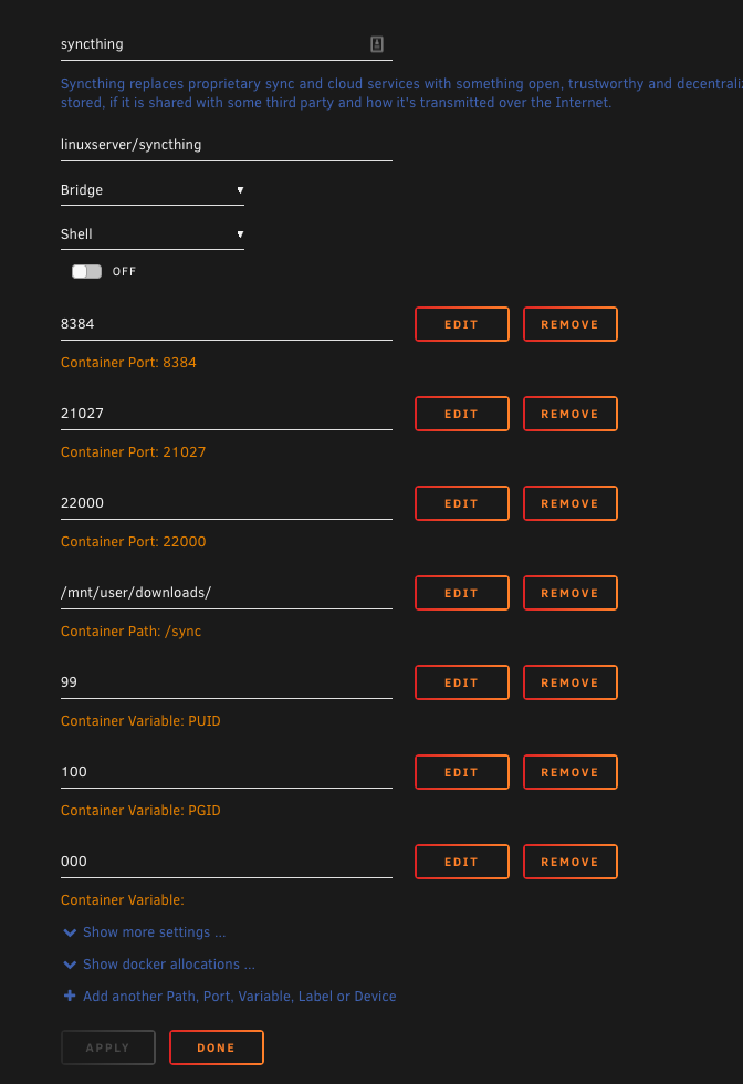

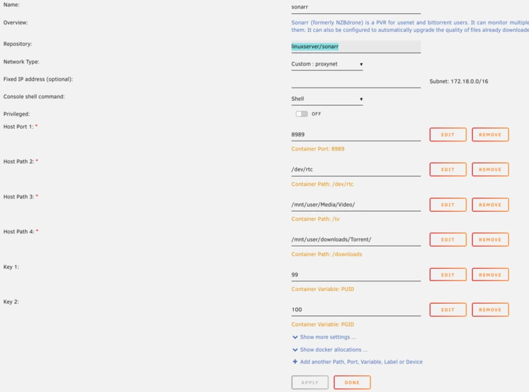

Hi. Trying sonarr v3. Just want to ask if this is a normal process. Didnt notice this in V2. Thanks.
I am working on a unraid box trying to get automated sonarr for my plex server running.  Currently using syncthing to get files off my seedbox to the server.  Sonarr adds the torrent and sycnthing brings it down.  Sonarr can see the progress but fails to import.  It gives me Import failed, path does not exist or is not accessible by Sonarr: /downloads/series/.  the downloads directory and everything in it has been chmod -R 777.  Attached is a shot of Sonarr config and the syncthing config screen.  My seedbox is placing tv shows in the series folder when it is brought over by syncthing.  Everything looks great on the share side but sonarr failes to transfer.  Any help would be great, thanks.
I would start by removing the /series/ folder and only use the /downloads/ folder.  Even if you are somehow downloading or moving tv (only) into the series folder it's creating a path of failure and sonarr doesn't care if your files are in /downloads or /downloads/series/, it will find them either way.
All of your Syncthing downloads should (and most likely are) going into the same /downloads folder so don't create any extra work by using additional subfolders.  If you somehow have your seedbox separating tv shows into a series folder -- stop that. Just making things messy and more complicated.
Try that and see if it helps.
Thanks, that seemed to clear things up.

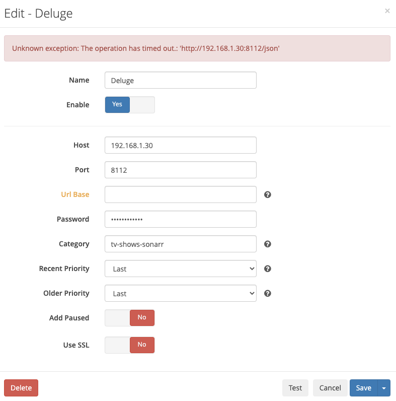

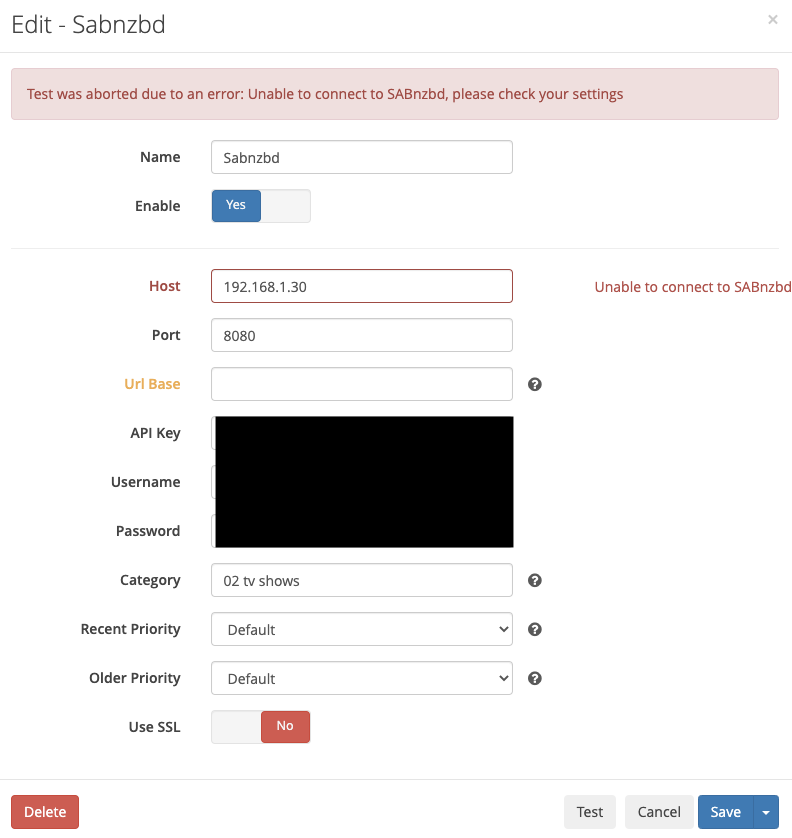

Using Unraid and updated my Sonarr docker to Sonarr version [v3.0.4.1131] last night. I use SABNzb and Deluge as my DL Clients. Get the same error and log entry for both clients. Radarr is working flawlessly with identical settings in both programs. I looked through the Troubleshooting Guide already but I have tried all the steps suggested.
v3.0.4.1132] NzbDrone.Core.Download.Clients.DownloadClientException: Unable to connect to SABnzbd, HTTP request failed: [503:ServiceUnavailable] [GET] at [http://IP Address:8080/api?mode=get_config&apikey=API Key=json] ---> NzbDrone.Common.Http.HttpException: HTTP request failed: [503:ServiceUnavailable] [GET] at [http://IP Address:8080/api?mode=get_config&apikey=7API KEY&output=json]
I can post the full log if needed.
@eranwolf I had this same problem last night but with NZBGet..   I run Sonarr through Binhex's PrivoxyVPN, and have been having some issues with a change he made in the last 48 hours. Telling Sonarr to ignore the IP where NZBGet is got it working for me.
If you're using a similar setup, you might look there.
So I do not run SABNzb through a proxy, however I do run Deluge binhex through PIA. Where would you tell Sonarr to ignore that IP?
Also, I am now seeing Sonarr add shows to my activity queue but it is putting them in a Queued status and doesnt actually download anythign on SABNzb or Deluge. So it can see and my Download Clients it just cannot initiate the download.
Thank you for leading me down the proxy path!!! The update somehow told Sonarr to Enable Proxy. Unchecked the box, restarted the Docker and boom started working. Thanks!!

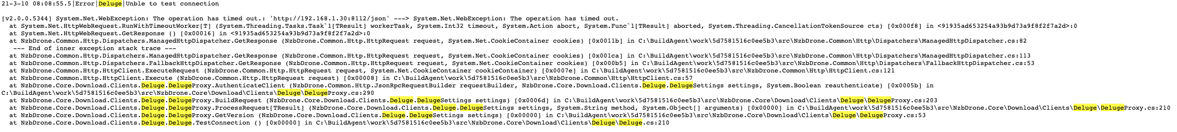

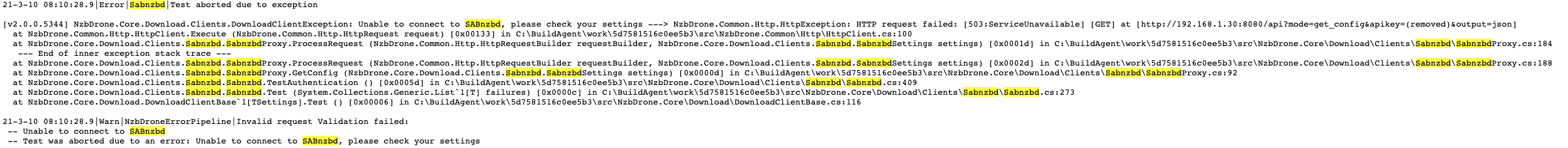

I was recently checking the status of my Sonarr as my Radarr as there was some issues with the downloading of the movies i was monitoring.
I noticed that "all the download clients are unavailable due to failures' - (I also noticed that i have issues with my  sonarr  and lidarr too)
i Went to check the setting and both my delugevpn and sabnzb failed on testing
1859410447_Screenshot2021-03-10at08_08_06.thumb.png.7e2d75fdff523a570139bc5e903d270c.png
in the system status i noted
Sabnzbd
237108252_Screenshot2021-03-10at08_10_47.thumb.png.090c9e1840f98d3eaebcba2511ab096c.png
Deluge
2006538773_Screenshot2021-03-10at08_09_23.thumb.png.bd8394164c01c1f48ae332ac4842ce7c.png
I am not sure how i can go about solving this issue, is it the sonarr or the deluge and sabnzbd?
I have checked my paths and disabled SSL, I tried disabling certification validation for local addresses too
I have not change any settings for quite a while, but i do have auto update on for all my docker apps.
i did set up a reverse proxy previously in letencrypt but i havent moved over to swag. I have tried to but wasnt able to set it up properly.
in the log files it mentions
For Sabnzbd1602864723_Screenshot2021-03-10at08_14_01.thumb.png.7df1cf5b2a1e3c74be772e31ad6760ca.png
For Deluge670175341_Screenshot2021-03-10at08_13_34.thumb.png.bba8e9ff74e22a661d94fb729758a64a.png

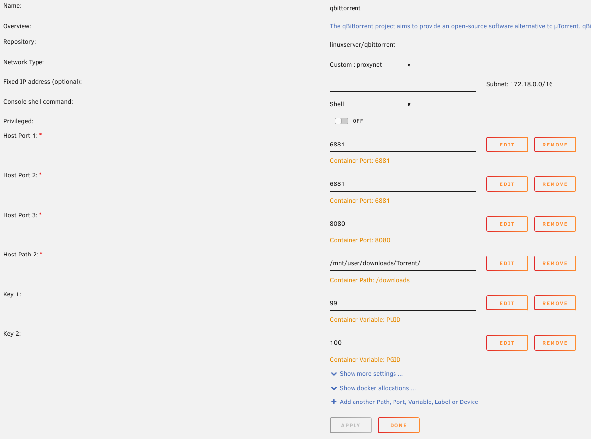

These are my set ups for sonarr and my download client. Qbittorent holds things in /downloads/incomplete until completed and then puts them into /downloads/complete. Again, radarr has the same set up and imports things fine. It sounds like some sort of permissions issue? But I'm not sure where to go next. It was working two days ago, and I'm not sure what if anything I've changed. I've tried restarting the dockers, rebooted my server a few times (for other reasons, but that hasn't solved it), I've tried forcing an update.
