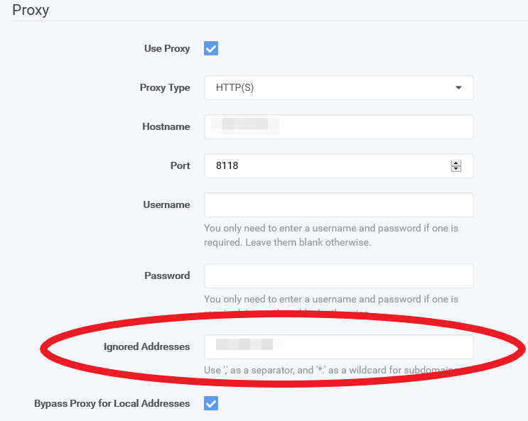

Since the upgrade to 3.0 Sonarr has stopped working I use Jacket, Sonarr and DelugeVPN and Airvpn
I had in the settings area for Proxy, checked. Then https, hostname and port filled out, then bypass proxy for local addresses.
This worked fine until version 3.
In reading posts above, I applied the preview tag. However, Sonarr still didn't work. So I uncheck the Proxy box and restarted and Sonarr now works.
How do I get my proxy to work? Is what I had configured no longer a viable option and I have to find a diff solution?
Thanks in advance.

@DigitalDivide  If you're running Sonarr's proxy through DelugeVPN, try telling your proxy to ignore the IP of your download client.
Didn't work. I assume for ip of download client, that would be deluge vpn and the ip is what I see on the docker tab for deluge. I tried with and without the port but didn't work. As soon as I uncheck Use Proxy it works.

@DigitalDivide I may have made an assumption to what your problem is. Is DelugeVPN your proxy? Are you running the other containers through that?
In my case, I'm using Binhex's PrivoxyVPN to achieve this. After some changes that were made recently to fix some IP leakage, I had to set Sonarr (when using a proxy) to ignore the address of my download client (in my case NZBGet).
If you're just using Sonarr with torrents, I'm assuming Jacket is in the path as your Indexer and Deluge is your download client. I'm not sure if what I'm saying will help. I am not set up like that.. but fiddling with that ignore field seems to be helping various people.

@DigitalDivide Privoxy is a web proxy. I use Binhex's PrivoxyVPN container as an https proxy. So my stuff like Sonarr, etc use the IP:port of that container for proxy stuff.
So in my case, and what I was hoping would work for you, I had to tell Sonarr to ignore the address of my downloader (NZBGet in my case) after a recent update to some of the VPN stuff to account for an IP leakage issue.
You mentioned DelugeVPN..  which makes me think you might be using Binhex's DelugeVPN container. If that's the case, you inherited some of the same changes to address that bug. This is why I asked if the problem actually showed up with Sonarr v3 or just seemed like it might have.
If that's the case (Binhex's DelugeVPN is your proxy), you might try telling Sonarr to ignore the IP address of your Jacket container. If you're using something else as your proxy, I'm not sure what would have changed just moving to v3.  You might otherwise verify that the IP address/creds of your proxy didn't change somehow. You could try pointing your web browser to your proxy to see if you actually have connections passing through it.
I'm not sure what else to suggest, so hopefully someone else can chime in here if we're stalled trying to solve your issue.

@DigitalDivide if you're running your proxy through DelugeVPN, then use the IP you have in Sonarr for your proxy in your web browser. Each browser is set up differently, and I use Firefox. In Firefox it's Tools->Options->Network Settings->Manual Proxy Configuration. You'd have to look up how for another browser.
The point here is to see if your proxy is actually working.  So I'd Google "what is my IP" before and after you enable the proxy in your browser. If they're different (and, really, if you can get anywhere after you enable it) then you know the proxy is working. If it's not working, then that's likely the source of your problem.
I'm honestly surprised that telling Sonarr to ignore the IP address of your Jacket (which looks to be 192.168.1.139) isn't doing the trick for you.
Also, you don't really need to install PrivoxyVPN like I have if you're routing through DelugeVPN. I believe Binhex's DelugeVPN has Privoxy in the container already.  If you look in your log file you posted you'll see Privoxy mentioned in there. You might consider posting in the support thread for DelugeVPN, since the problem you're having seems to be related to passing through that. Maybe Binhex will have some ideas.
Ok, put in the ip I am using for delugevpn into Chrome and I did get a diff ip and am able to browse the web. So, I know that works at least.
Ok, now this is weird. I was playing around again this morning and tried putting in the ip of deluge for the bypass...for the 20th time...and now it works...I have no idea why lol BUT I'll take it.
Thanks for the assistance. Very much appreciated!
EDIT: One question. The IP I am using for the bypass is what you listed above but it's the same ip for deluge, radar, sonarr. The only difference is the port. Do I have that correct?
