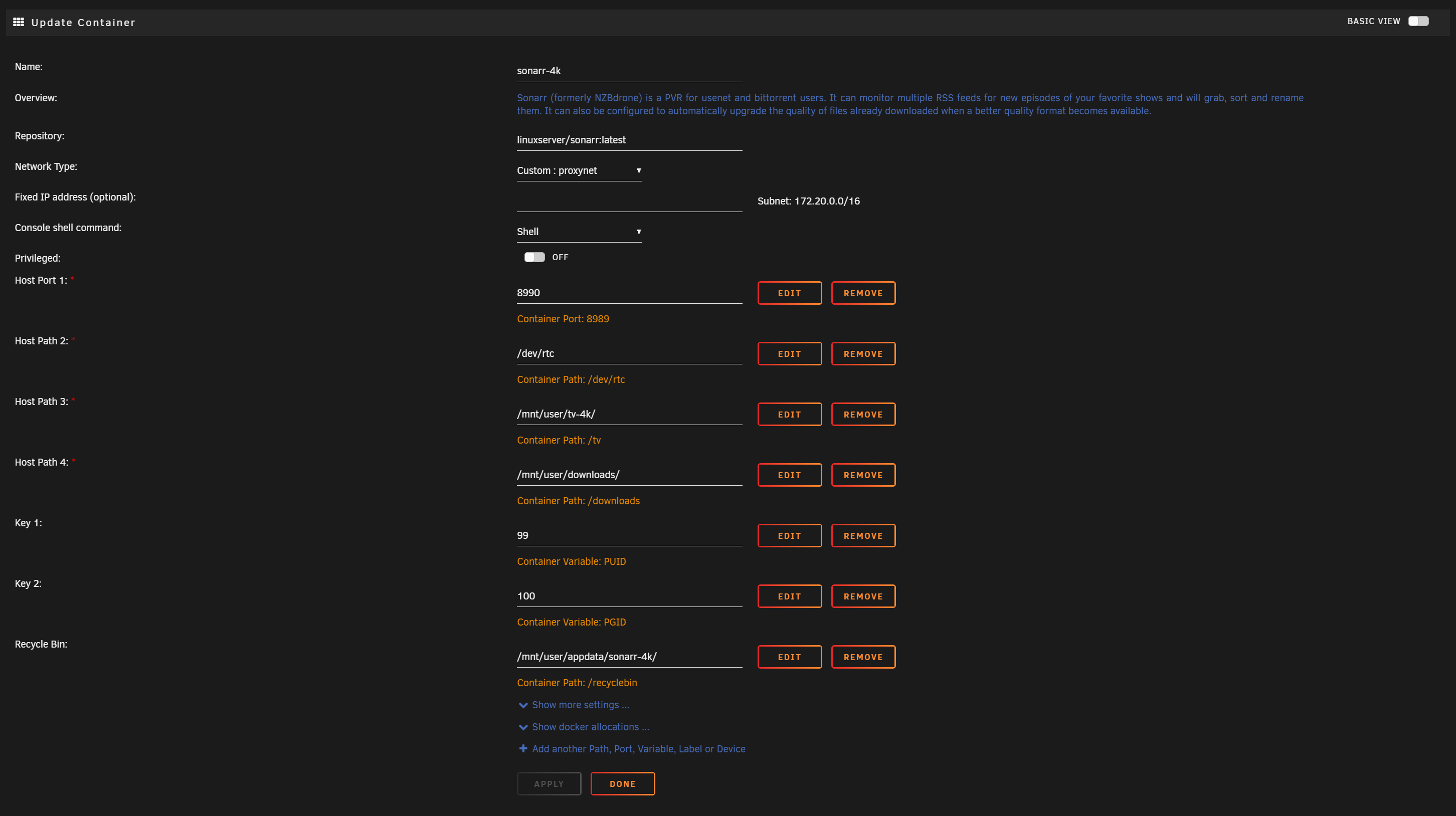

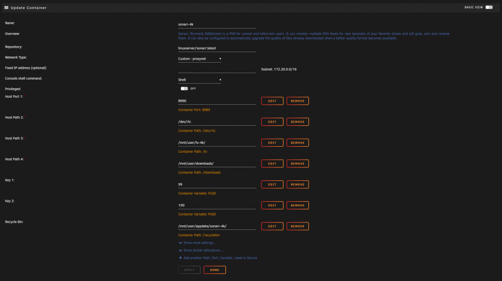

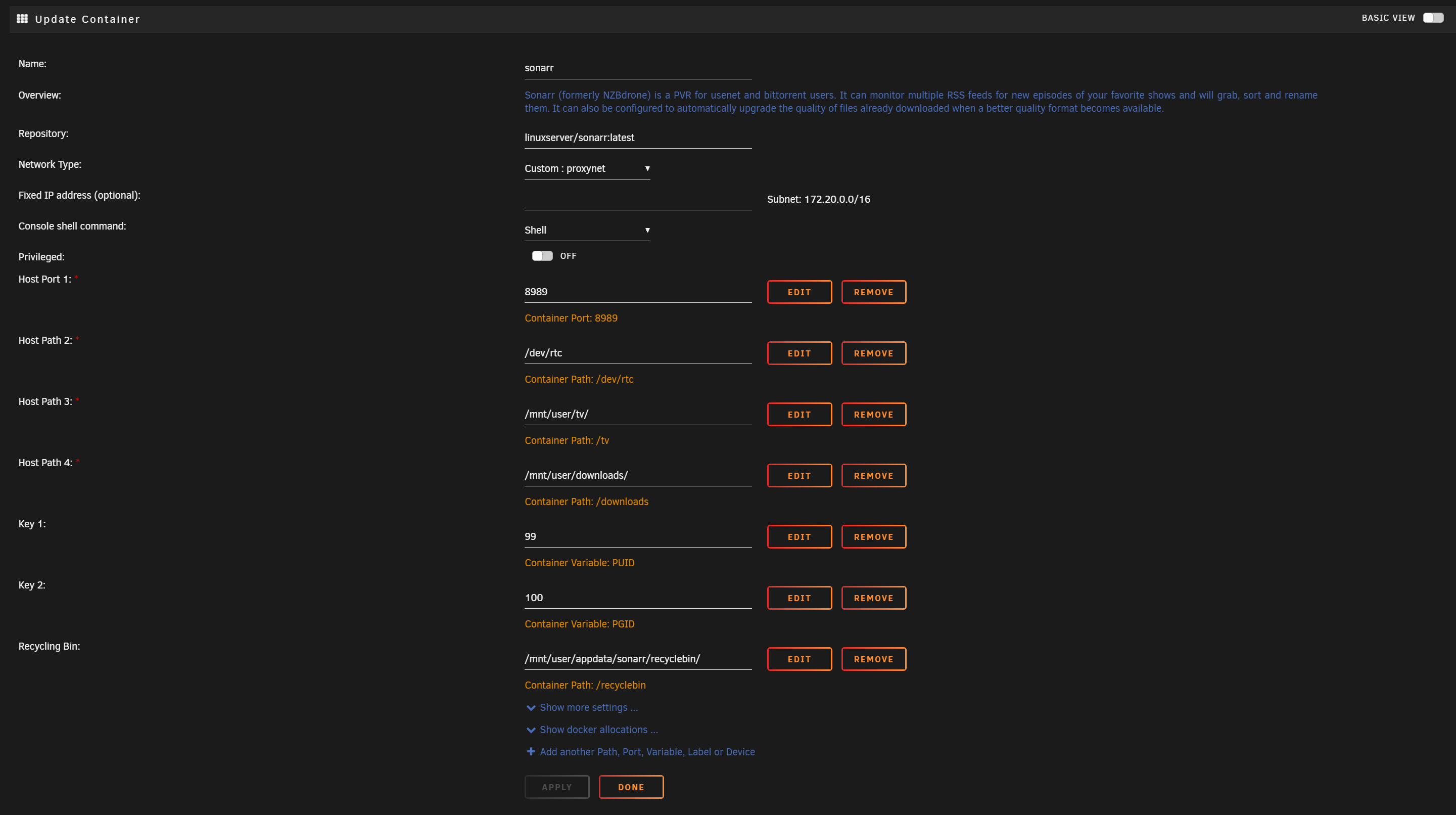

I am having a peculiar issue I hope someone can help with.
I run two instances of Sonarr - one for 2160p media and one for everything else. I am also running a Syncarr container alongside them to synchronize specific titles from the non-2160p instance to the 2160p one. What I am seeing is that whenever these containers are restarted (for example, during automated backup from the Backup/Restore Appdata Plugin), the API key for my 2160p instance changes, which breaks the connection that Syncarr is setup to use. While this is not a huge deal, it's becoming annoying to have to go back in and update the container config with the new API key.
Is there a way to configure Sonarr to NOT update the API key that I am missing? Does it have to do with running two instances of Sonarr from the same docker template? My primary Sonarr instance never changes, which is the weird part. Any help would be appreciated.
Instance 1: Primary, Non-4K media
Instance 2: 4K only media
I feel that this is because you are running 2 of the same containers using the same docker image. Try switching your 4k one to binhex's repo. That's what I did and its been perfect since then.
We also would need to see the location of your docker image there.. but.. give the switch a shot none the less.
