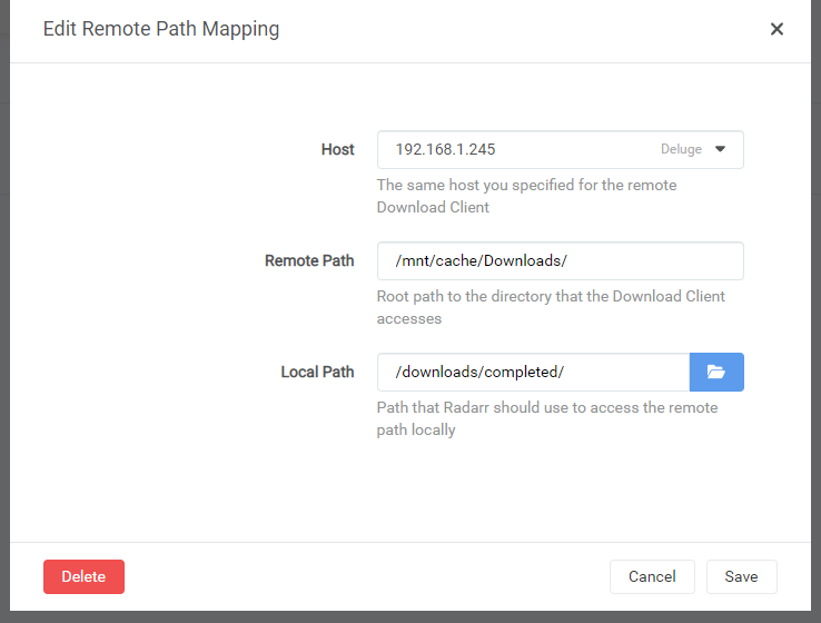

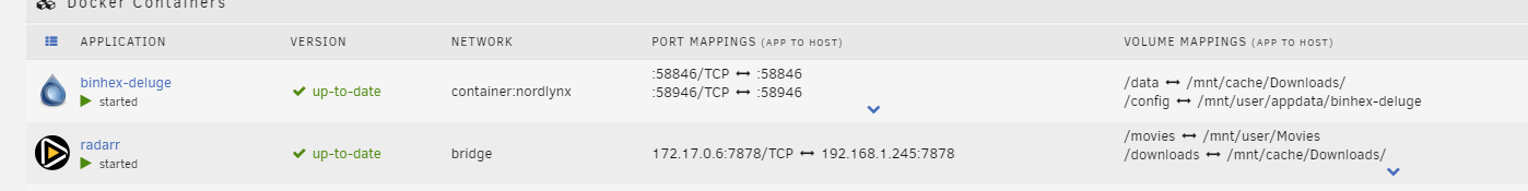

  • When deluge is finished, it's telling Sonarr that the file is stored in /data/completed/..., but you don't have /data/completed mapped to /downloads/completed on sonarr or radar  Add that mapping, and

    I left /data and /config alone, deleted /media and created /mnt ( = /mnt) for Sonarr, Radarr and qBitTorrentvpn.

Hello I am new to unraid and docker in general...
And Im sorry I have read a few pages up, and I still dont understand... I know sonarr/radarr are looking in two different places than the torrent client, but I dont get where they are looking. I keep getting the same error as everyone else that the "Import failed, path does not exist or is not accessible by Radarr: /data/completed/movie_title"
I attempted to change things according to what another user posted above and its still wrong. I need someone to walk me through exactly what to change. Because the file locations are not mapping correctly in Sonarr,  I still get the same error.
Plus maybe it would help us newbies if we had pictures. Because I would assume its correct, but obviously its not, because of the errors I am getting.
Thanks!
Both halves of the mappings must match.
At the moment, you have /data on one, and /downloads on the other. Change all the /mnt/cache/Downloads mappings to the same thing, whether it's /data or /downloads doesn't really matter, just has to be the same for all the download clients.
