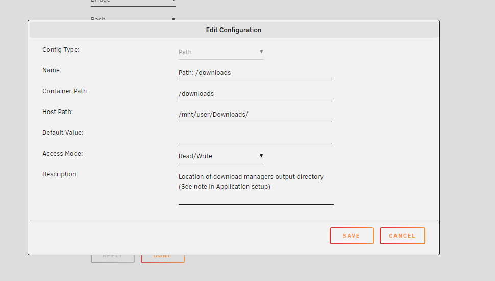

After re-reading your reply I finally figured out you was referencing. Changing radarr/sonarr "container path" folder location to match our download client, within the Sonarr/Radarr container setup config. I kept making the mistake of only changing the "host path" location and getting frustrated. Both the Container path & the host path must match within radarr/sonarr for tv/movies to be updated.

  • When deluge is finished, it's telling Sonarr that the file is stored in /data/completed/..., but you don't have /data/completed mapped to /downloads/completed on sonarr or radar  Add that mapping, and

    I left /data and /config alone, deleted /media and created /mnt ( = /mnt) for Sonarr, Radarr and qBitTorrentvpn.

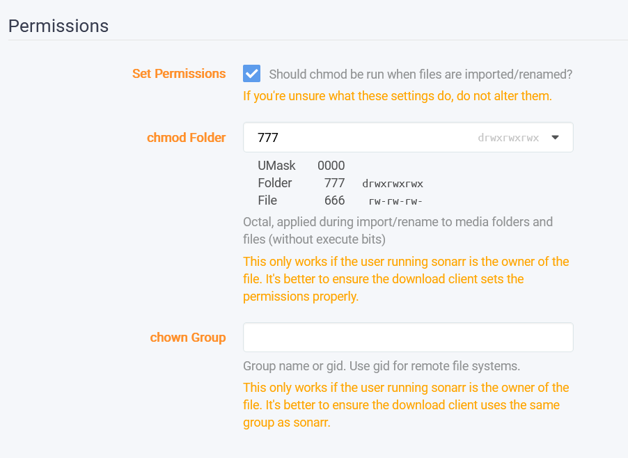

I've had a problem with this app for many months. It works perfectly, except when it create a new folder. Every folder it creates when importing shows has restrictive permissions, and I have to use Docker Safe - New Permissions to reset permissions.
I have to this every single time sonarr adds a new tv show, and it's only when creating folders through sonarr.
Is there a way to avoid having to do this?

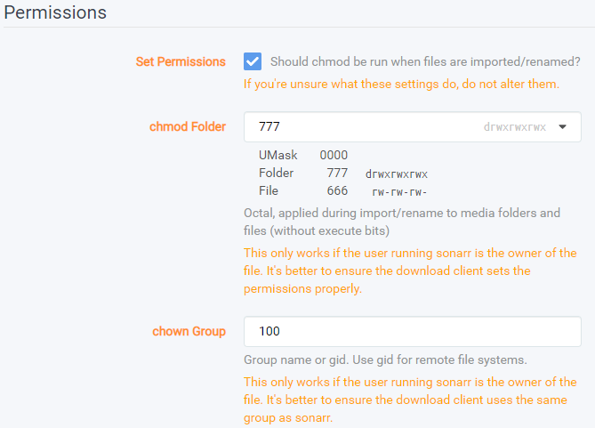

Check the Permissions under Settings > Media Management, I've got mine set like this and haven't had any issues. What's your current permissions settings?

I've had the exact same problem since day one, years upon years now. It really only makes a difference when I try to move files between drives or folders. I get permission denied errors and either have to go to the shell prompt to chmod/chown or use docker safe new permissions. All of my media that gets downloaded suffers the same thing, movies, music, TV shows.
I'll try that. I dont have that box at the top checked, and radarr doesnt need it - i have radarr and sonarr set the same way so I assumed it would be fine.
does the chown Group need any contents or can it be left empty? What does 100 mean here?

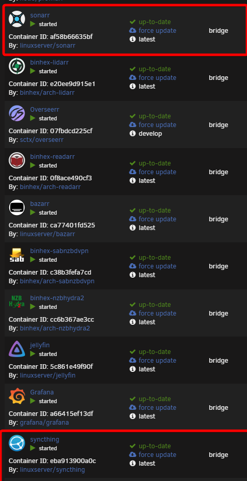

follow up question
I'm running your sonarr and syncthing containers. Is there a way to prevent the stlfolder from showing in sonarr/radarr? I've accidently removed it a few times now, then ofc you have to reset the sync in syncthing.
I think you can leave chown Group empty if you don't use remote shares. Hopefully you have by now got it working... :)

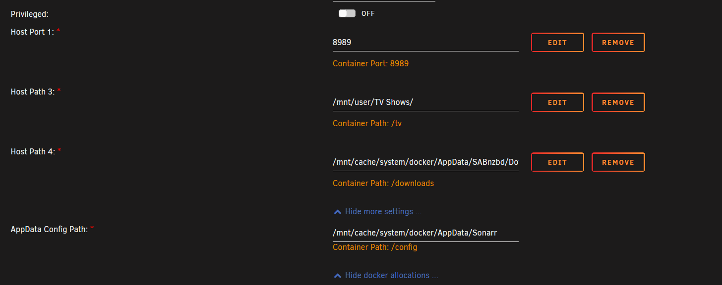

I'm hoping someone can help because I'm at the end of my rope.  Ever since I went from 6.9.2 to 6.11.x, I've been having permission issues.  SAB seems to write the file without issue, but when Sonarr tryies to move it from the unpack folder to the folder with the other shows, I get this error:
Import failed, path does not exist or is not accessible by Sonarr: /tv/Servant.S04E01.HDR.2160p.WEB.h265-TRUFFLE/. Ensure the path exists and the user running Sonarr has the correct permissions to access this file/folder
I then have to do it manually through file explorer.  I guess there is a permissions issue, but I'm not sure where to look or what to change.
I would try this:
It looks like this has fixed it. It's weird I had to do this in Sonarr but didn't in Radarr. But it is working now, and that's what matters :) thanks!
