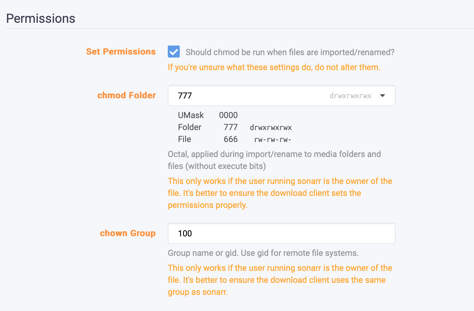

Under settings and then Media Management (make sure you enable show advanced) there's a section if you scroll down so that you can set permissions.

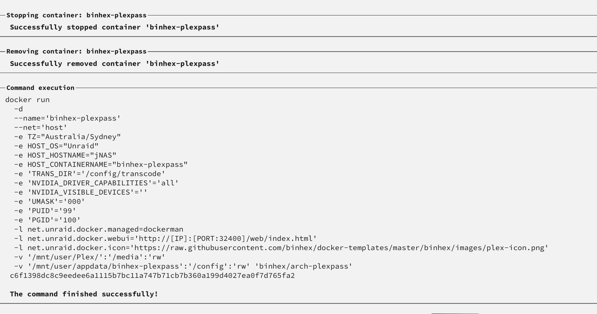

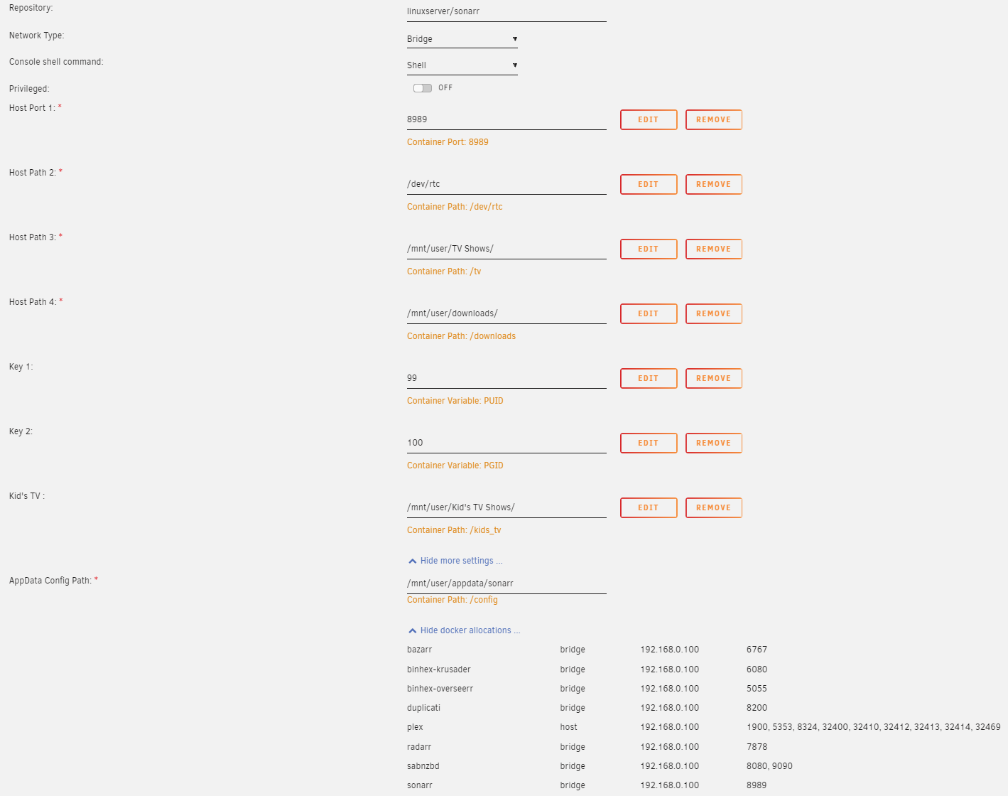

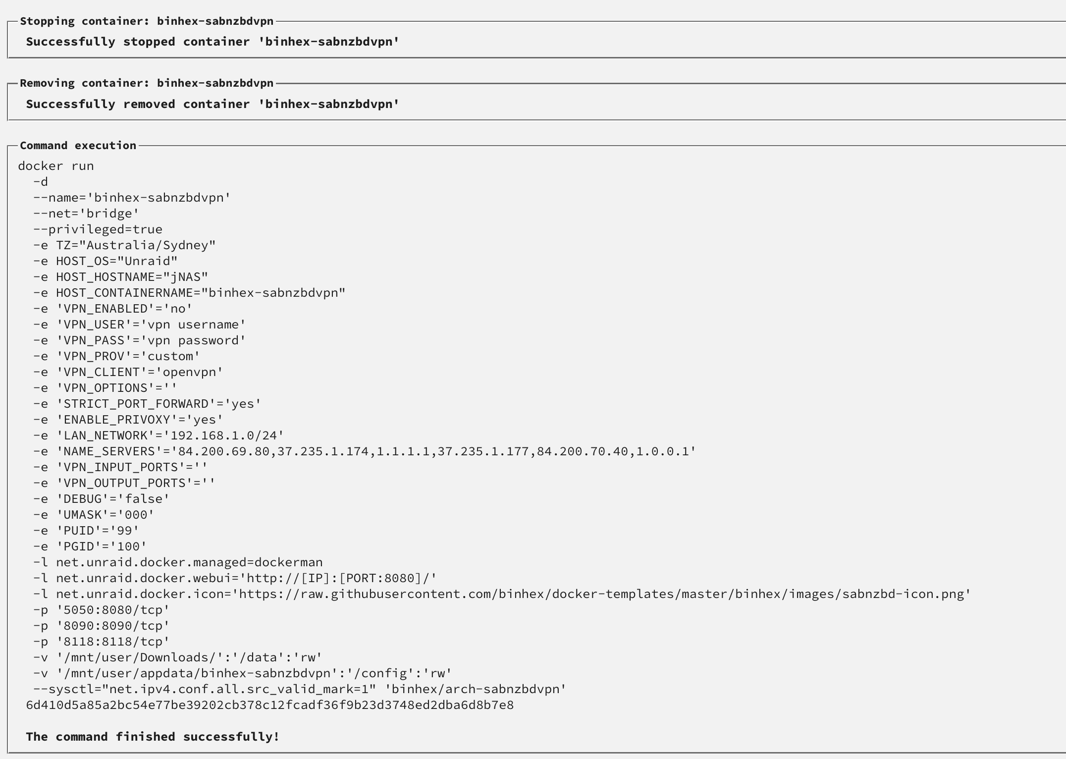

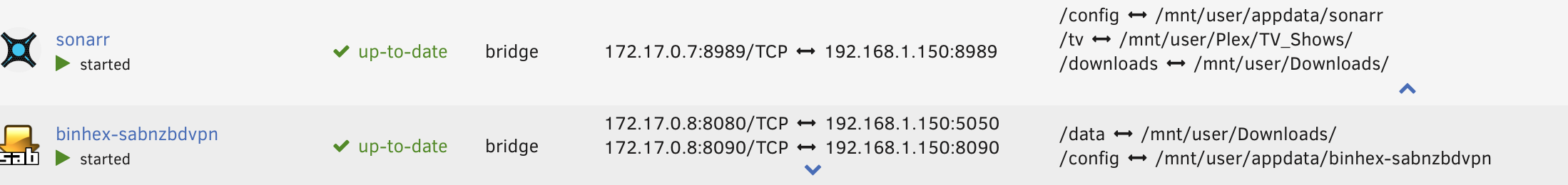

Hi 🙂
Thankyou.  I have still been trying to fix now writer's strike is over.
Plex, SABnzbdvpn & Sonarr commands and other:
Where am I going wrong that Sonarr can't pick up the downloaded file and drag to Plex?
Cheers 🙂
EDITED BIT: Uploaded incorrect pic, had creds.
857039567_Screenshot2023-10-22at20_21_48.thumb.png.74fc58f12aa14e0b59f819e26d2ac049.png857039567_Screenshot2023-10-22at20_21_48.thumb.png.74fc58f12aa14e0b59f819e26d2ac049.png
Edited by RadRom
sonarr and sab must have a common path mapping. Right now you have /downloads->/mnt/user/downloads/complete and /data->/mnt/user/downloads.
Change one or the other to match, both host and container parts of both mappings must be identical. You have neither part identical right now.

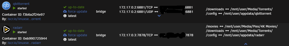

Issue:
When qBittorrent finishes downloading a file, it's suppose to move it from /mnt/user/Media/Torrents to /mnt/user/Media/Torrents/Completed.  Once it does that, Radarr (or Sonarr) is suppose to pick it up and move it to /mnt/user/Media/Plex/4K Movies (or 4K TV Shows).  That isn't happening. Radarr will show the file as green/available, with it's path as "/downloads/(movie folder name)". So Plex never see's it.  It's also suppose to rename the file. It does rename it and create a proper folder for it (Title (year)), but it leaves it in /mnt/user/Media/Torrents.
Using just Radarr as my example for now, I've mapped /movies to /mnt/user/Media/Plex/4K Movies and /downloads to /mnt/user/Media/Torrents/.
With in Radarr, I've added the root path "/movies" and in qBT I have the following settings
Downloads Tab:
-Default Torrent Management Mode: Automatic
-When Torrent Category changed: Relocate Torrent
-When Default Save Path Changed: Relocate affected torrents.
-When Category Save Path Changed: Relocate affected torrents
- Use Subcategories: Checked
-Default Save Path: /downloads/Completed
-Keep incomplete torrents in: /downloads/incomplete
BitTorrent Tab:
-Seeing Limits
--When Ratio reaches: 1
Then Pause Torrent
There's clearly something I'm missing because I have Sonarr set up the exact same way, except with 4K TV Shows folder instead of 4K Movies.
Any advice on where to look?
Edited by Meller
Left out where Radarr says the path is

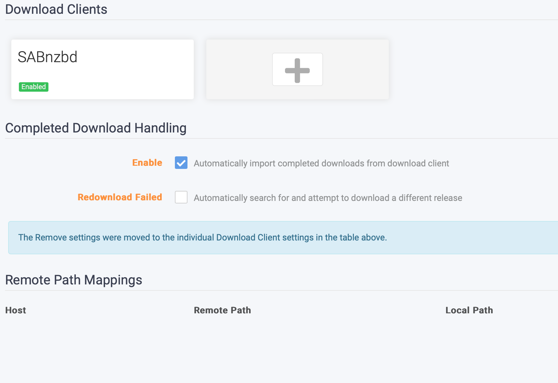

So I feel like I'm having a similar issue to some others, but I'm just not smart enough to figure it out... lol
Everything has been working perfectly up until maybe a couple weeks ago, although I'm just realizing that I have a problem today.
Nothing in my config has changed, other than various dockers updating along the way, as they do.
like most others, I have Radarr, Sonarr, Jackett and Plex all working together, along with SabNZB and qBit handling the downloading.
As I said, everything has been great, until recently.
Today, I ran a manual search for a certain show.  The results came back as usual, and I selected one for download.  It was an NZB.  A few minutes later, I saw that it was complete, but not showing up in Sonarr.  I looked in the unraid file manager, and the file is there, but it's not being moved or acknowledged in any way by Sonarr, as best as I can tell.  The odd thing is that there are no errors in Sonarr.  This is a key difference from previous times I've had trouble.  Before, it's always been that Sonarr saw the file, but had some permissions or mapping issue.  This time, it's like it doesn't knw the file exists, even though it was the one that initiated the download request.
As I said, now that I look, I see that I have lots of files backing up in the downloads folder, waiting to be imported, but Sonarr doesn't seem to know they are there.
I'm not even sure where to begin looking.  I'm not good at parsing logs, or even finding them always.  I'm happy to provide info, if anyone can tell me what you need to see....
I saw a mention above about there being an update from v3 to v4, and custom preference tags causing some issue?  How can I tell what version I'm on?  I do use preference tags, in an attempt to get Sonarr to pull smaller x264/x265 files, rather than huge 1080p rips.  Could that be part of the issue?
EDIT/SOLUTION:  So I found the solution, at least for my specific issue.  Maybe this is your problem as well.  It seems that in the update to Sonarr v4, it's now aggressively enforcing the "Category" thing, whatever that is.  I've never needed, cared or wanted to know anything about "Categories", but without assigning one, Sonarr just refused to import my files.  I found this out by digging through my settings, looking for what I thought was maybe a bad mapping, based on the comments above.  Everything looked okay, though, and had been working just fine for many months.  On the Settings > Download Clients > SABnzbd screen, I tried to run a [test] and got a warning.  It said "Adding a category specific to Sonarr avoids conflicts with unrelated non-Sonarr downloads. Using a category is optional, but strongly recommended.
A category is recommended".
In this case "recommended" means, 100% will not work until you assign one.
I knew nothing about what it wanted for input, so I tried "Sonarr", which it rejected, since it didn't exist in SAB already.  Okay... to I went over to SAB, checked the [Categories] tab, and noticed that they were more like {TV}, {Movies}, etc...
Fine, I went back to Sonarr, put in "tv", and clicked [test].  I got a green check, so I manually ran the tasks, and lo and behold, all my files are importing!
This really could be documented a bit better.  Or better yet, just left alone! :/
TL;DR - put "tv" into the [category] field of SABnzbd's settings (within Sonarr), and see if that fixes your import issues.

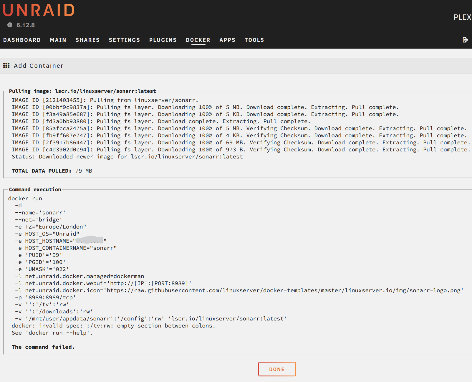

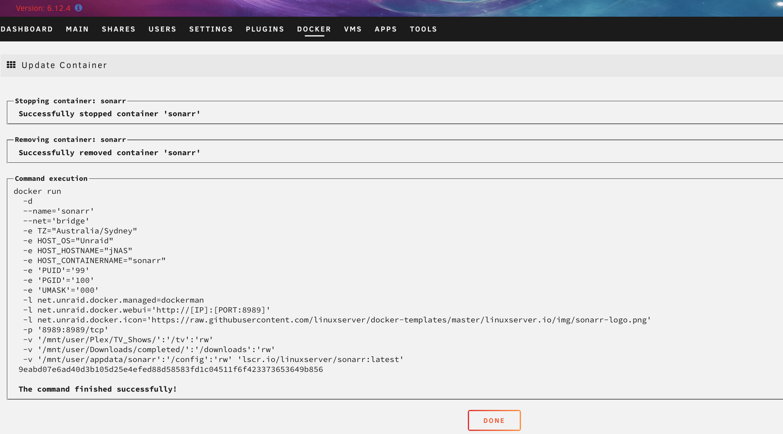

Update to the latest stable failed and now cannot even install it from the scratch. Any ideas?
If it’s still there in docker edit it (if not previous apps and actions reinstall) and you have a path sitting in there that doesn’t have an entry next to it.  Remove that path
Thank you! Removing the empty "tv" and "downloads" paths worked. But not sure why the sonarr docker update went belly up the first place... Could be related that I previously had updated Unraid from 6.12.6 to 6.12.8?

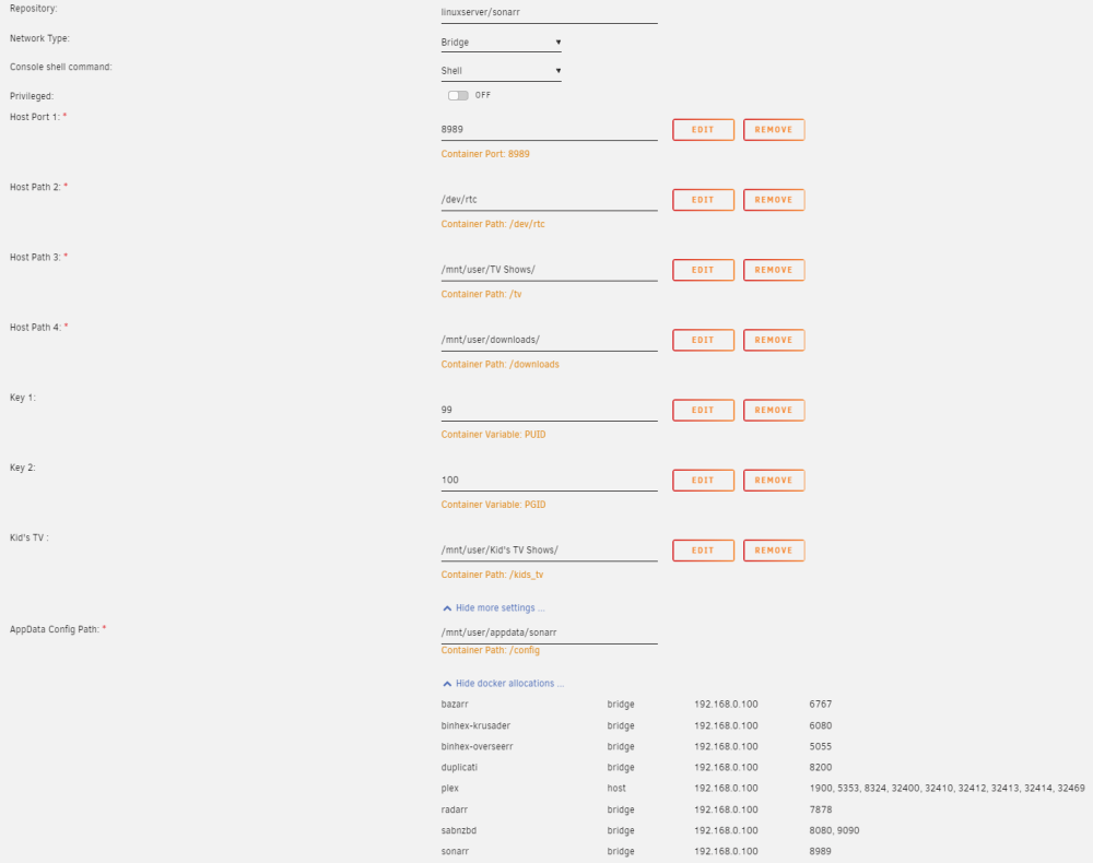

Since updating to Unraid 6.12.8 I've not been able to access the Sonarr webgui. Not sure if it's related but I don't think anything else has changed and I've checked all the settings. I can still access all the other dockers (e.g. Radarr, plex, etc) but this is what I see when I try to access Sonarr:
Here's my setup: image.thumb.png.fa51649f09d025c0fd86a4dc900bf397.png
Any idea what could have gone wrong and how I can fix it? I have tried removing and re-adding the docker, which works fine, but still can't access the webgui. I have also tried temporarily turning off the windows firewall, but this didn't make any difference either.
Advice appreciated!
Edited by ThinkSta
On 3/14/2024 at 4:23 PM, ThinkSta said:
Since updating to Unraid 6.12.8 I've not been able to access the Sonarr webgui. Not sure if it's related but I don't think anything else has changed and I've checked all the settings. I can still access all the other dockers (e.g. Radarr, plex, etc) but this is what I see when I try to access Sonarr: This site can't be reached
Best way to trouble shot is to look in the log file. A quick way is to open the log after you started the docker through the docker menu.
For all the logs look in \appdata\sonarr\logs
