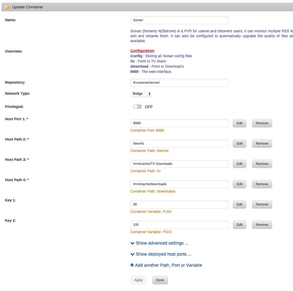

sniper, I'd start by standardising what you mean by /downloads.
For all containers use /mnt/cache/downloads = /downloads
It will make it all far more logical and easier to setup.

I have to agree with CHBMB, having different downloads spots makes it harder to try to figure out why it not working.

Could you please share the docker settings for Sonar, Sabnzbd and deluge from your docker tab in unpaid
Please ensure that all mappings are visible

HI mkeil77
https://drive.google.com/file/d/0BwVQ1QEehpJJSW81aWdQTFlxQlk/view?usp=drivesdk
https://drive.google.com/file/d/0BwVQ1QEehpJJTmNWNkJ1M2tsRDQ/view?usp=drivesdk
https://drive.google.com/file/d/0BwVQ1QEehpJJTGU2cFpzVkZJN0E/view?usp=drivesdk
I hope that what you meant

I noticed you have 2 path configured in your SABNZBD, what I can't see in any of your screenshots is the corresponding container path.
could you please send me a screenshot of both PATH configs of your SABNZBD. just click on edit and send me a screenshot of it.

New sonarr user here, been using sick beard for years but having issues hence the change. In sick beard my shows point to /mnt/user/download/TV when I try to add this path in sonarr to import my shows, it tells me its an invalid path? Looking for help on how to import my shows into sonarr as I have about 100 of them.
Thanks
AM
Thanks
AM
Same as your other containers that you've setup /mnt/user/.... doesn't exist within the container.
Post your mappings that you've created so far.
Not sure I follow you.
In sickbeard I have two mappings:
/mnt/cache/TV Downloads
But what are they mapped to? The sonarr ones of course
The two mappings in sonarr are these:
Post a screenshot of your docker screen in Unraid just the sonarr bit....
Here you go.
OK, so they're mapped to /tv and /downloads.  So you'd point Sonarr to /tv
I have to say though I think you may run into issues with the way your folders are structured.  Presumably stuff gets moved from the cache to your array?
Yes I manually move stuff all the time.
So which mappings for sonarr do I change to TV? Not sure what I am changing or to what  ???
