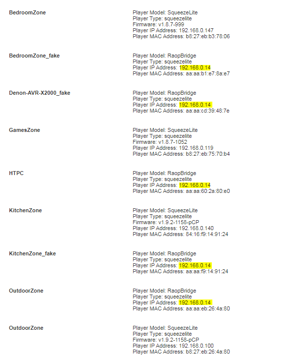

I've been running LMS on my UnRaid box for about 5 years now, things have been running so well until about 6 months ago.  I run multiple raspberry pi clients with PiCorePlayer, and control the system with Android Orange Squeeze.
As mentioned, about 6 months ago the server seems to be creating phantom clients named after existing clients, but having the IP address of the UnRaid LMS server.  They are fully controllable, and I guess if I had a soundcard and speakers connected to the server, I would most likely hear audio from these phantom clients, but I'm trying to figure out why this is occurring.  I've actually just been renaming them as clientzone_fake so I can easily determine the actual client to the fake one.
The most recent has been I just added a raspberry pi and called it OutdoorZone...which the server quickly added the phantom channel.
Any advice on why this is happening...and more importantly, how do I stop it from happening?  I've even logged into mysqueezebox and deleted extra clients showing there, but it hasn't transferred over to the server.
Shown is my LMS Information screen that shows these phantom clients with their actual client and additional phantoms created that just reside on the server such as the Denon-AVR-X2000, and the HTPC.
*EDIT* is it something to do with that RaopBridge Player Type?  Not sure what that is.
*EDIT UPDATE*
Figured it out.  I was using the AirPlay Bridge plugin, and it was configuring these device clients.  Removed the plugin, all went back to normal and only the actaul clients are showing up.

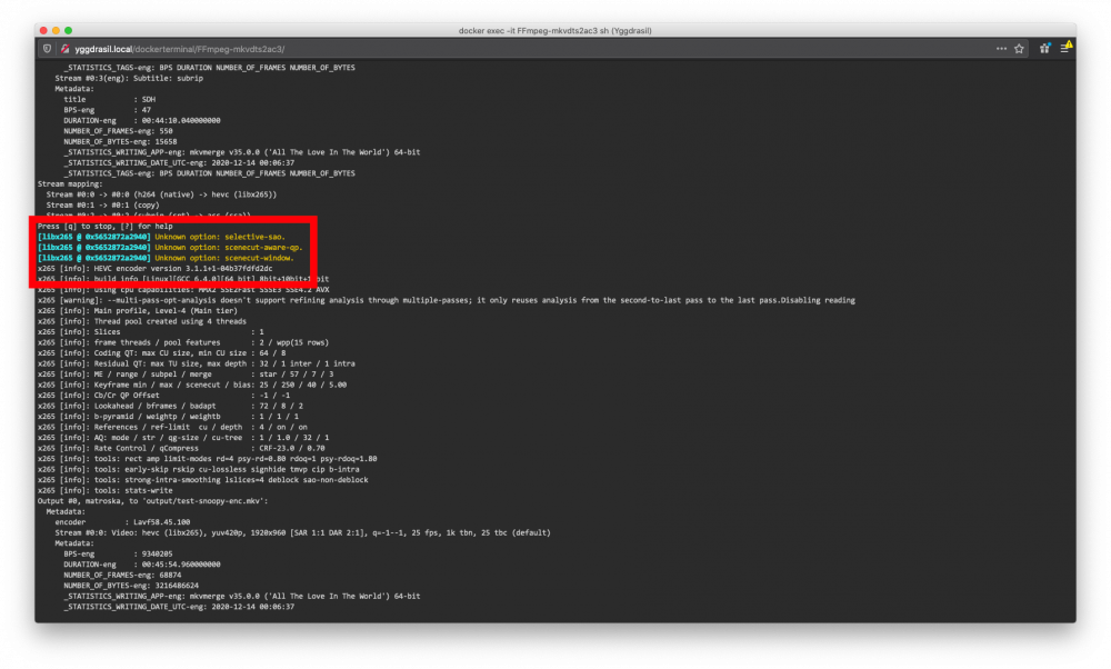

Hello,
I discover your docker ffmpeg, which i am trying to setup.
I don't really understand how the watch folder is working (i drop file in it, but ffmpeg doesn't start encoding) so i tried manually.
And it seems that ffmpeg is not up to date :
- ffmpeg version 4.1.6 inside the docker
- ffmpeg version 4.3.1 on my macbook pro
And, some new commands for libx265 are not supported by 4.1.6 as i receive this message :
[libx265 @ 0x562634b31800] Unknown option: selective-sao.
[libx265 @ 0x562634b31800] Unknown option: scenecut-aware-qp.
[libx265 @ 0x562634b31800] Unknown option: scenecut-window.
Using :
ffmpeg -i watch/HDM6.mkv -c:v libx265 -c:a copy -preset slow -crf 23 -profile:v main10 -x265-params "allow-non-conformanc
e=1:wpp=1:tu-intra-depth=1:tu-inter-depth=1:cutree=1:early-skip=1:limit-refs=3:cu-lossless=1:aq-mode=1:b-intra=1:constrained-
intra=1:rc-lookahead=72:rc-grain=1:weightb=1:weightp=1:deblock='0:0':sao=1:sao-non-deblock=1:selective-sao=4:subme=7:me=3:rec
t=1:amp=1:rd=4:psy-rd=0.8:psy-rdoq=1.80:rdoq-level=1:signhide=1:temporal-mvp=1:strong-intra-smoothing=1:bframes=8:ref=4:b-ada
pt=2:qcomp=0.7:cbqpoffs=-1:crqpoffs=-1:qpmax=54:qpmin=0:analyze-src-pics=1:no-fast-intra=1:pass=3:stats=1:analysis-reuse-file
=1:multi-pass-opt-analysis=1:multi-pass-opt-distortion=1:opt-qp-pps=1:opt-ref-list-length-pps=1:multi-pass-opt-rps=1:scenecut
-aware-qp=1:scenecut-window=650:fades=1"  output/HDM6.mkv
According to the documentation, it should work : https://x265.readthedocs.io/en/master/cli.html
Did you know how can i update ffmpeg ?
Thank you for your work !

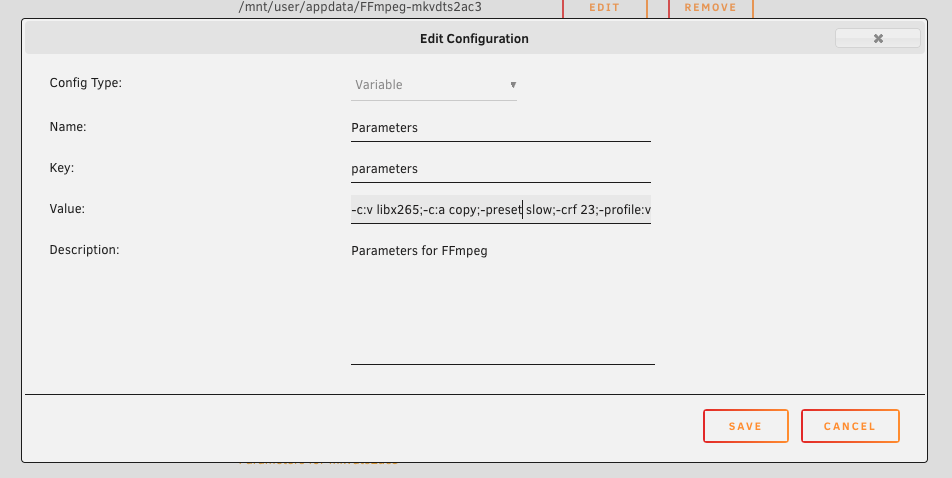

Post a screenshot of your "Parameters for FFmpeg". You will need to have a separator ; between each parameter.

So, i delete ffmpeg, did a fresh install :
1726746660_Capturedecran2020-12-20a12_42_57.thumb.png.ac513f552261e93e4aded57951596be3.png
(with read/write access to /Handbrake/)

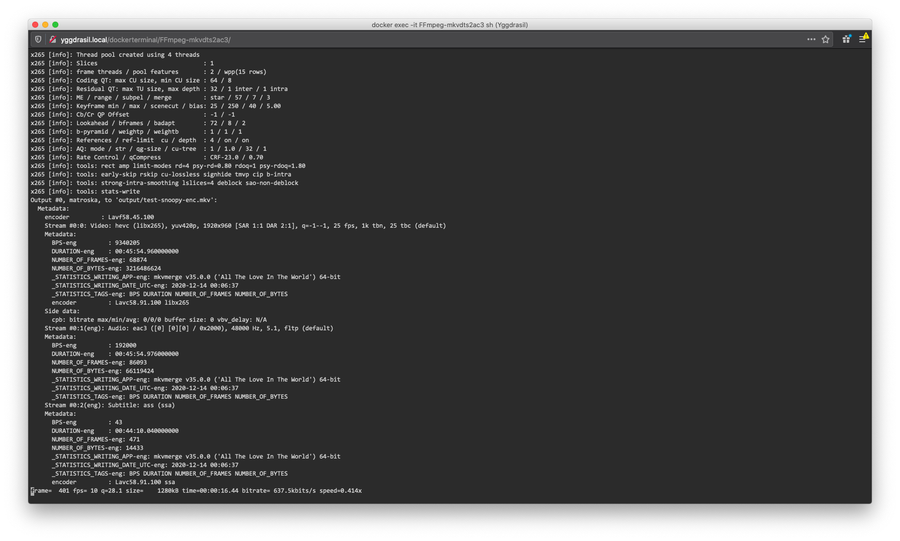

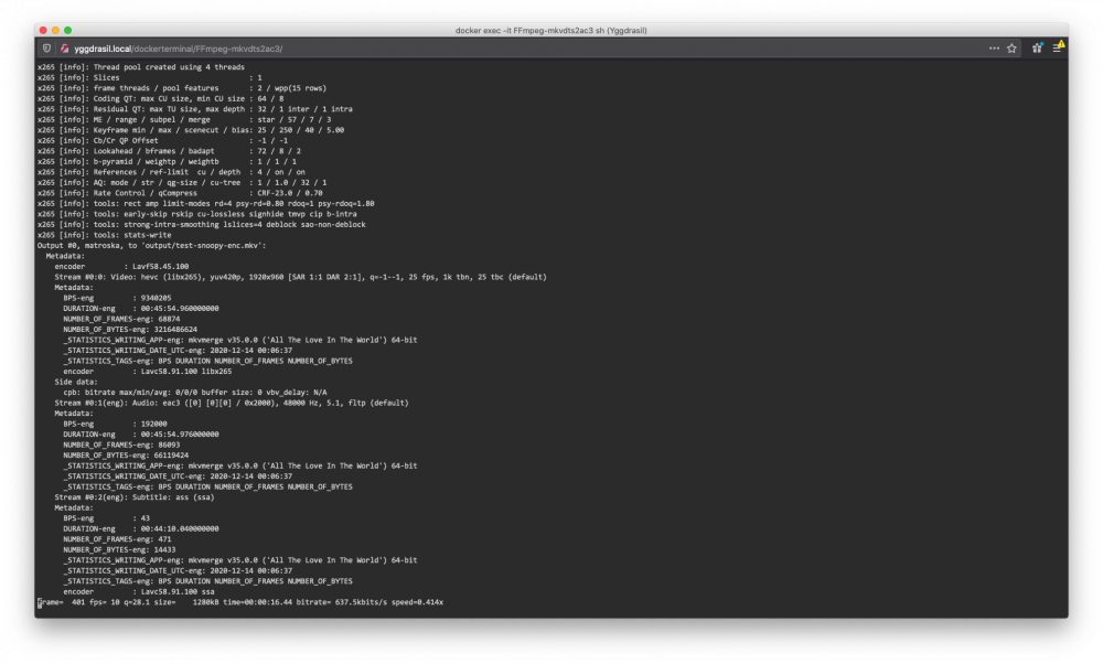

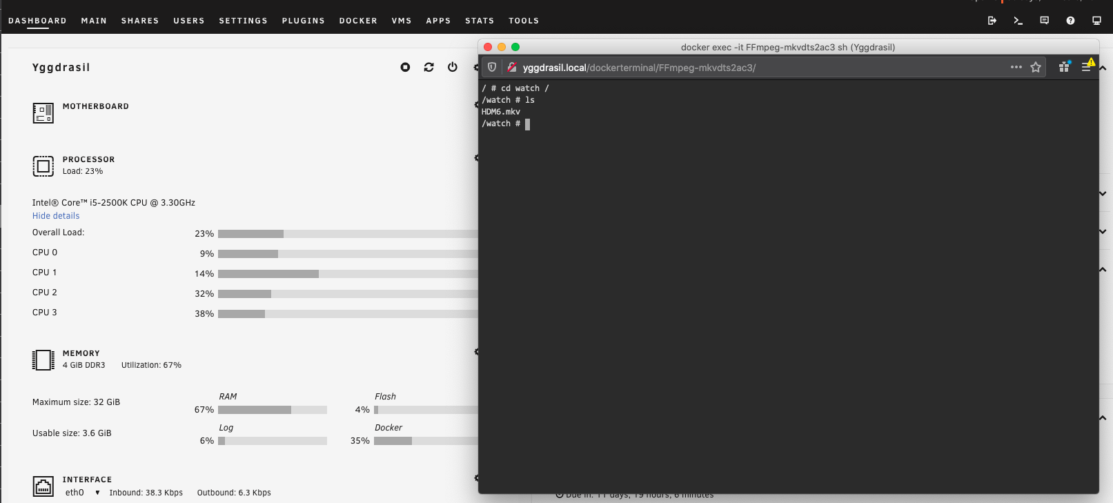

Then, i add a file to output/ for testing and try to launch from the console :
484625542_Capturedecran2020-12-20a12_46_07.thumb.png.75a308708eb47f29c47c4640269bfa4e.png

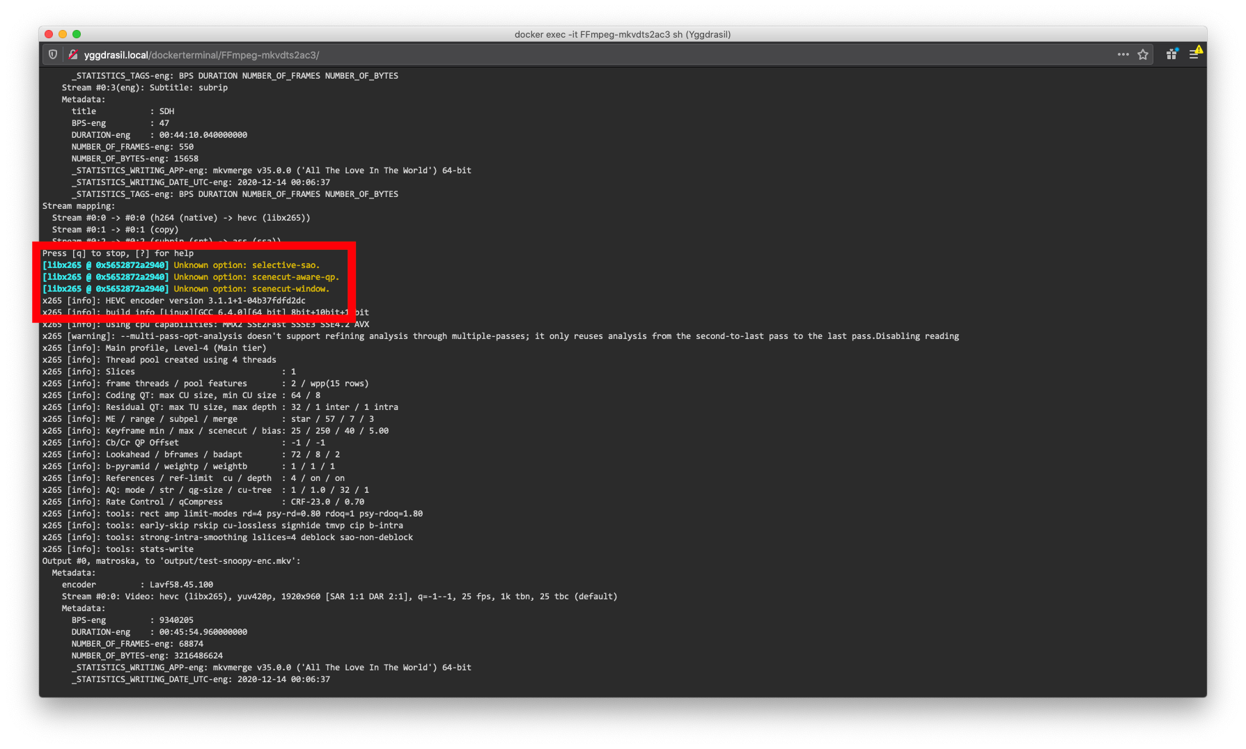

347979001_Capturedecran2020-12-20a12_46_29.thumb.png.8bbcbabdf3a14f71c611377b3ab6372d.png

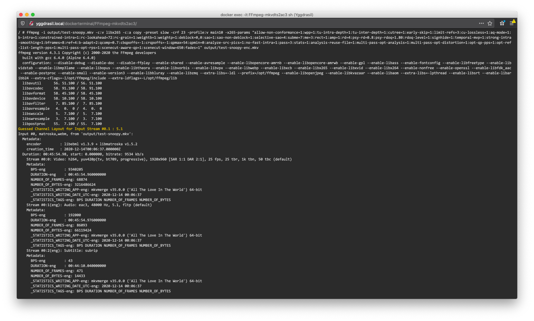

1255636834_Capturedecran2020-12-20a12_46_36.thumb.png.be48102d36ff36033d1fedb1733d43b7.png
1385064729_Capturedecran2020-12-20a12_56_33.thumb.png.49d7dd44b655a060108ef16bc2a12ffb.png
I think here, the only issue is that libx265 is not up to date, so some parameters are unknown.
Then, i edit Parameters :
Full Value line  (same as previously, only with ; intead of space) :
-c:v libx265;-c:a copy;-preset slow;-crf 23;-profile:v main10;-x265-params "allow-non-conformance=1:wpp=1:tu-intra-depth=1:tu-inter-depth=1:cutree=1:early-skip=1:limit-refs=3:cu-lossless=1:aq-mode=1:b-intra=1:constrained-intra=1:rc-lookahead=72:rc-grain=1:weightb=1:weightp=1:deblock=0,0:sao=1:sao-non-deblock=1:selective-sao=4:subme=7:me=3:rect=1:amp=1:rd=4:psy-rd=0.8:psy-rdoq=1.80:rdoq-level=1:signhide=1:temporal-mvp=1:strong-intra-smoothing=1:bframes=8:ref=4:b-adapt=2:qcomp=0.7:cbqpoffs=-1:crqpoffs=-1:qpmax=54:qpmin=0:analyze-src-pics=1:no-fast-intra=1:pass=3:stats=1:analysis-reuse-file=1:multi-pass-opt-analysis=1:multi-pass-opt-distortion=1:opt-qp-pps=1:opt-ref-list-length-pps=1:multi-pass-opt-rps=1:scenecut-aware-qp=1:scenecut-window=650:fades=1"

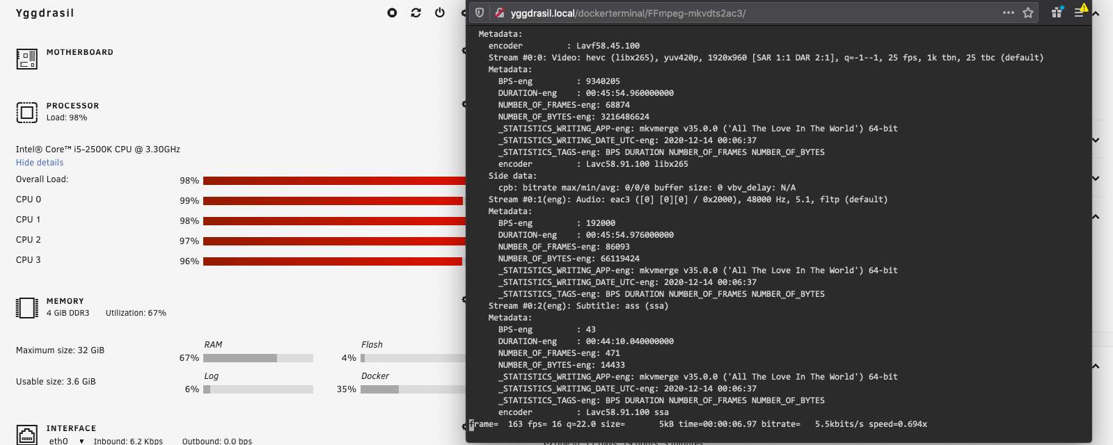

Then ffmpeg restart, but even with a file in /watch, the CPU isn't kick in, so i guess, the encode does not start :

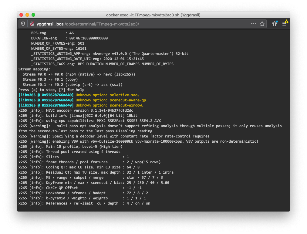

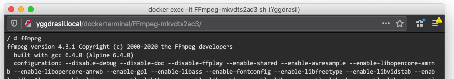

I've bumped the ffmpeg version to 4.3. You should have it when you do an update. Maybe this will fix your issue with unknown options.
As for watch directory not working. What is in the log after the container starts?
Edited by snoopy86
For the log, i didn't think about it and it seems to be because the file is know :
  crond: USER root pid 1406 cmd /usr/bin/flock -n /tmp/my.lockfile /bin/bash /ffmpeg-dtsac3/encode.sh -i /watch -o /output -m /copy
  2020-12-20-12:54:00
  Not a file.
  HDM6.mkv
  Allready exists in files.txt
After renaming the file, ffmpeg start right now with the encode.
BUT
Even with ffmpeg v4.3.1, i still have my issue :
Capture d’écran 2020-12-20 à 21.15.19.png785864363_Capturedecran2020-12-20a21_21_44.thumb.png.8fa0624bfa50dc2bfc57cbbb6095cbda.png
I think this is because libx265 is in version 3.1.1+1-04b37fdfd2dc.
The latest is 3.4.
According to the Version History :
- selective-sao was added in 3.2
- scenecut-aware-qp was added in 3.3
- scenecut-window was added in 3.3
Thanks !!
