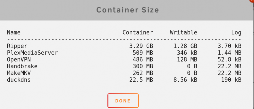

Ripper container increasing in size while not in use.  I got an UNRAID about disk utilisation and noticed that the Ripper container had grown to 5Gb.  I uninstalled and reinstalled but it's grown from 2.7Gb to 3.2Gb in a couple of days.  I'm not actively using Ripper at the moment and the log doesn't show anything untoward.  Any idea what I can do to diagnose / resolve this?  Thanks in advance for any help.

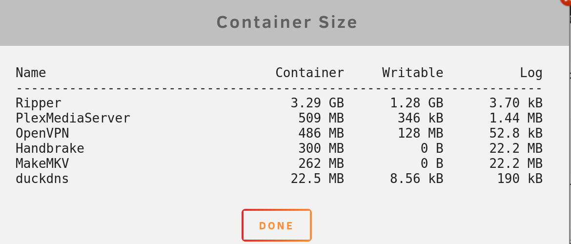

This could be due to the verbose logging of the container.
Try and add
--log-opt max-size=50m
as Extra parameters in the container's advanced settings.
This should drastically limit the container size due to docker logs.
