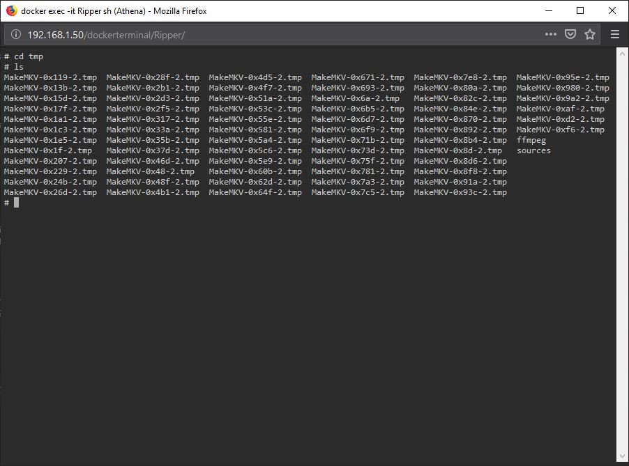

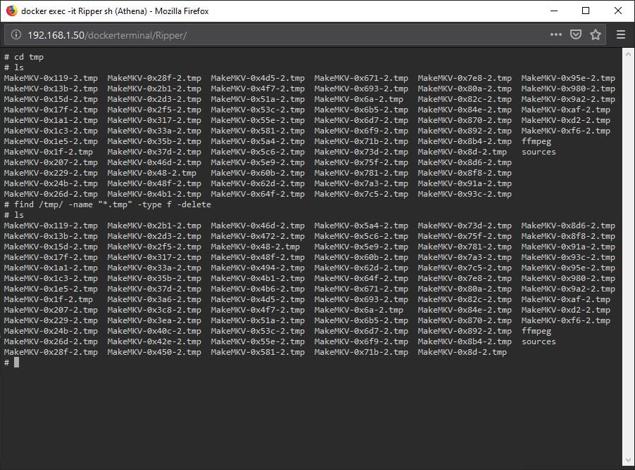

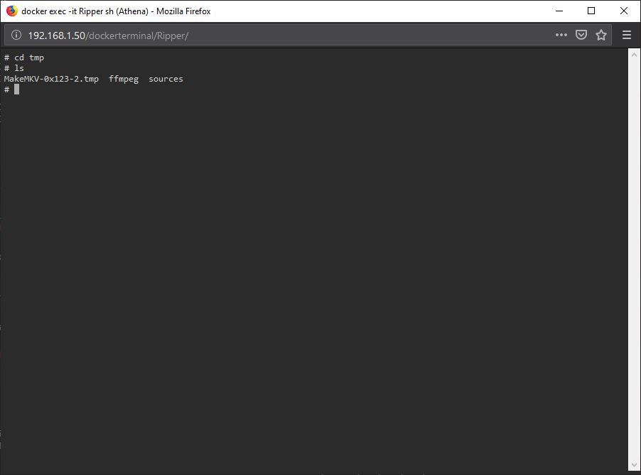

3 minutes ago, rix said:
This looks expected..
I have added this command, that should delete all the .tmp files in the folder:
find /tmp/ -name "*.tmp" -type f -delete
Could you please enter that one in the container shell and post the results.. might be an error displayed or it working perfectly.. either would help me get to the core of this
I ran the command you provided and it doesn't delete anything. I personally to clear the tmp files out ran a "rm -r *.tmp" but I don't know if this is applicable here.
That explains why the files are still there.
Please replace the line seen above with these lines in your ripper.sh then report back:
# delete MakeMKV temp files
cwd=$(pwd)
cd /tmp
rm -r *.tmp
cd $
I updated the ripper.sh file, restarted the docker, and waited a few minutes to see if tmp files started to be created. Only 1 did, so I waited a little longer to see if any more appeared. Still the 1 there. I think that modification worked. 3297096_Rippertmpcodeupdate.JPG.055f5fc40501ceb8bc92d722b2cec985.JPG
Thanks for helping me debug this - I pushed these changes:
https://github.com/rix1337/docker-ripper/commit/a3470835533b126c305e4765edb879b2669aec7d
No problem, glad I could help.

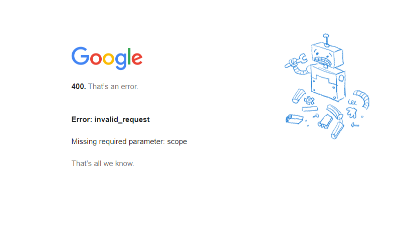

I'm trying to get the Google Play Music Manager docker working.
Installing the image and logging in the first time works like a charm.
But after logging in, I get the following message:
When looking in the log, I see the following:
Looking in the log it says: 2019-12-27 11:43:03,245 +0100 ERROR TId 0x14b62f5df740 Error: Domain (1) code (400) label (Bad Request) url (https://accounts.google.com/o/oauth2/[email protected]) [ExtendedWebPage.cpp:48 ExtendedWebPage::extension()]
If I navigate to the URL, I get the following message.
Can somebody else verify that the docker image is still functioning?
Am I doing something wrong?

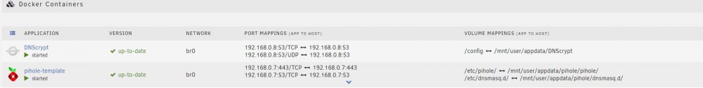

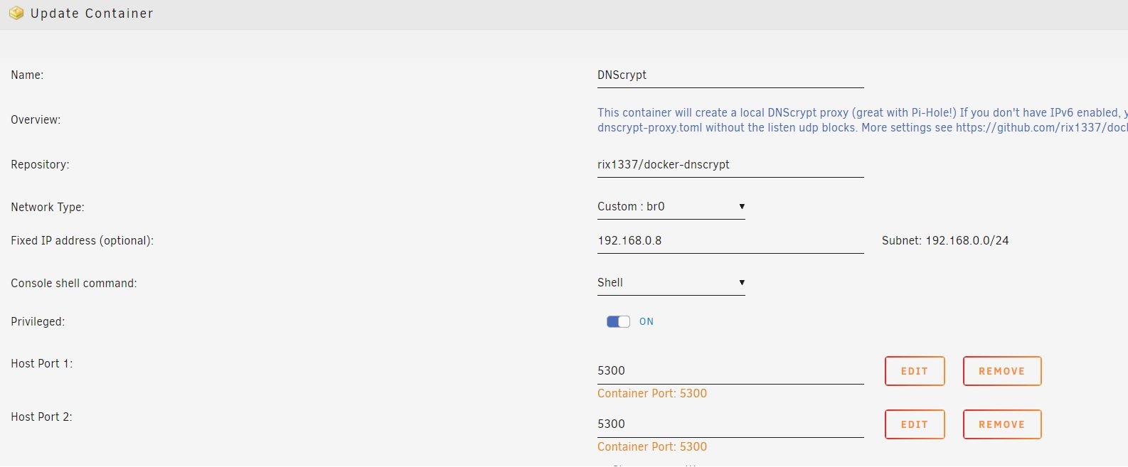

Is there a way to change the port for DNSCrypt? I have Pi-Hole installed and listening on port 53 and need DNSCrypt on another port. However, when I go into DNSCrypt and add in Host Port 1 (5300 / TCP) and Host Port 2 (5300/UDP) it doesn't seem to take into effect and sticks to port 53.
Any idea how I can get DNSCrypt to pick up port 5300?
Its working completely fine on my part.
Have you edited the toml file?

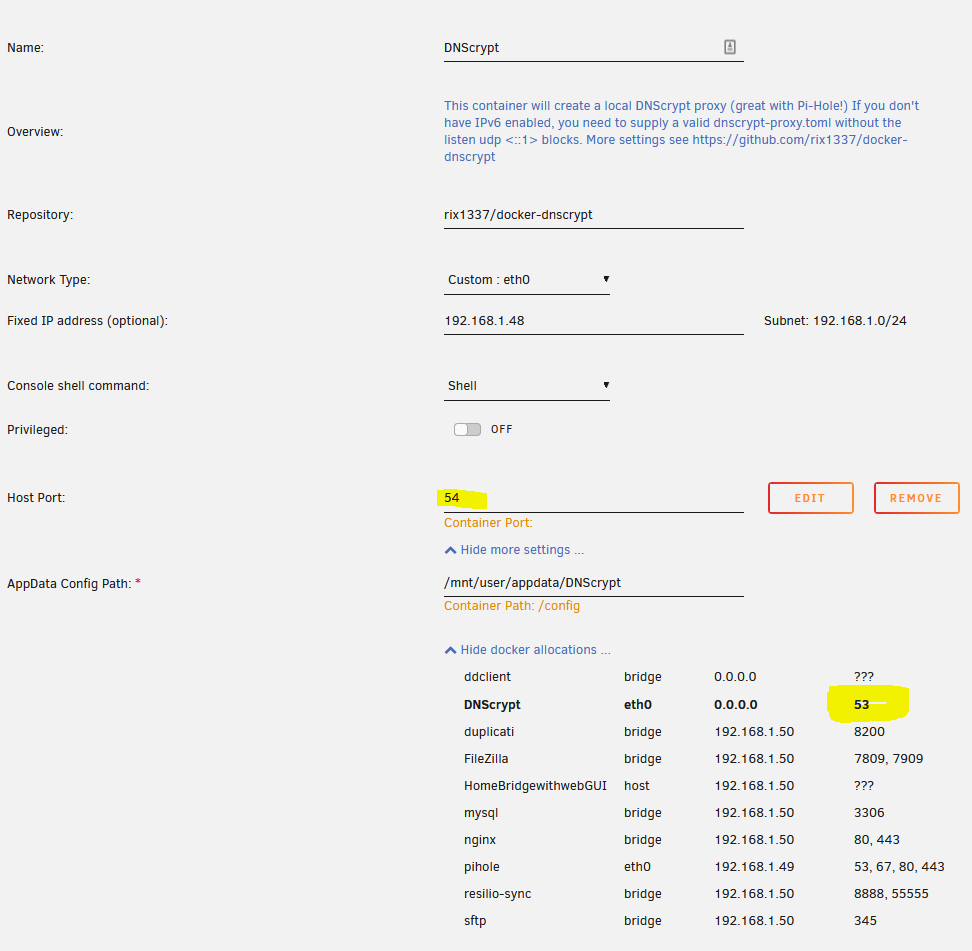

@rix first off, thanks for your efforts here!

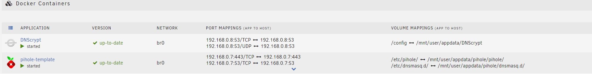

I'm trying to get DNSCrypt going.  I have a working PiHole setup that I've had working, for quite some time, on port 53.  I'm having it look "upstream" to DNSCrypt at port 54.  And I'm seeing two issues.
1. The docker config is configured to 54, yet the docker port allocation for DNSCrypt still says 53.  See below.
My dnscrypt-proxy.toml file is configured for 54:
listen_addresses = ['127.0.0.1:54']
2. At run time it loads my toml file, and it seems content with it, except that if I try to point it to a blacklist file in my configuration folder (see docker config) which is definitely there, it fails.  The comment says it is relative to the same directory as the toml file, so I would expect this to just work. If I remove this and my cloaking file path reference altogether (effectively negating most the point of my use of DNSCrypt), it boots just fine.
  ## Path to the file of blocking rules (absolute, or relative to the same directory as the config file)
 #fails:
  blacklist_file = 'dnscrypt-blacklist-domains.txt'
 # also fails:
  blacklist_file = './dnscrypt-blacklist-domains.txt'
[2020-03-10 14:51:47] [NOTICE] Loading the set of IP blocking rules from [./dnscrypt-blacklist-domains.txt]
[2020-03-10 14:51:47] [FATAL] open ./dnscrypt-blacklist-domains.txt: no such file or directory
Thoughts?
Does anyone know what might cause the two above issues?  Have I hit two bugs here?
