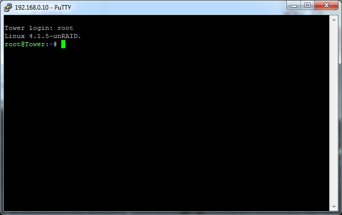

Do you have a keyboard and monitor attached to your unRAID?
Since you say it is pingable sounds like it must be booting. Can you telnet?
Monitor is attached, telnet is successful. If only I had more clues about how-to use linux :) I'm mostly a Windows-guy.

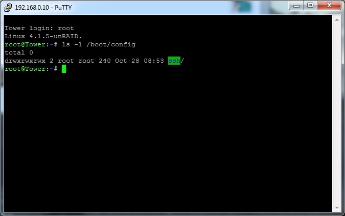

Can you run the command
ls -l /boot/config
and post the results?    That will at least tell us whether you have the correct files at that location.  In this case the important file is the one named 'go' which contains the command to start up the web interface.  It could be missing if you made an error when copying the files from the from the unRAID zip download to the flash drive.

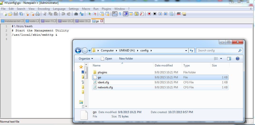

I believe there is something missing :D
But the files are on the USB-Drive as you see on the picture.

Actually that screenshot shows that the contents of the config folder are missing.  There should have been a default set of files put there from the downloaded ZIP file.  Sounds as if the unzip of the files to the flash drive was not done correctly as the ZIP contains files that should have been in the config folder.

As you can see, there are these files, if you open the flash-drive under windows... Could it be that NTFS is interfering?

Not necessarily. I've had the same symptoms once, and others have as well. Posts scattered around the forum. Basically, the system initially boots just fine but the config folder is completely empty except for freshly generated ssh files, so nothing works or works with default settings.
Could possibly be some race condition if the USB drive is slow to mount and the ssh files are created first, preventing mounting of the flash drive.
NTFS? Unraid uses FAT32. Did you follow the directions to prepare the flash drive?
