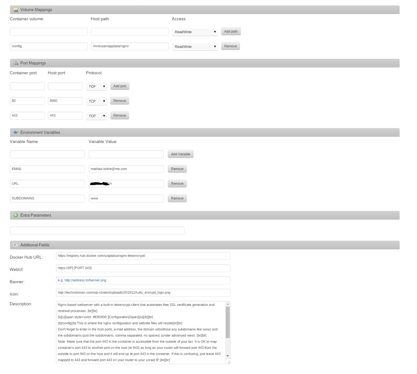

Hello,
i tried to install the docker.
I filled Email, URL and Subdomain and set the ports.
The ports are set on my router too.
When i start the container and try to visit the https://domain page, nothing happens.
What i am doing wrong? I can't see anything in the logs.

Can you post a screenshot of your container settings?
Does the log show absolutely nothing?
Post the contents of "docker logs Nginx-letsencrypt" from unraid terminal

Here are my settings and the log.
One question, this docker is a bridge, not a host.
Does that mean, thast it has an own ip address?
I) forward 443 and 8080 to my unraid ip.
The code is too long. I posted the last lines.

It seems the problem is due to the config location. If it's on a cache only share, try changing it to /mnt/cache/appdata/nginx
Hmm, its not on the Cache Drive.
Some docker containers have issues when their config folder is in a user share. It's an unraid related issue but it's been difficult to pinpoint the exact cause (may be related to the use of hard links)
I would highly recommend using a cache drive for this. If you don't have a cache drive, then put the share on a single array drive and use the path /mnt/diskX/appdata/nginx

When i try to install the docker now, i get the error message.
I see nothing in the unraid log..
But i see, that there is some data left in the system, see the picture.
I deleted the folder (/appdata/nginx) on the system via ssh.
But there must be some data somewhere else.
Maybe if i can delete this data, i can try a new fresh install.
If i try to install other dockers, i have no problem.

If you left click on the orphan image's pic and select remove, they should be deleted.
Then you should be able to install from scratch

I tried this several times.
What i meant was, that if i delete it there (right klick -> remove) and then delete the data via ssh on the cli
and i do a clean install, i get the error and then the screen.
I am confused, why there is "created 6 days ago"
Something is wrong. Did you try rebooting unraid after deleting the container? If that doesn't work, I'd suggest asking jonp in the unraid bugs sub forum
Am having the same problem
Pulling image: aptalca/nginx-letsencrypt:latest
IMAGE ID [latest]: Pulling from aptalca/nginx-letsencrypt.
IMAGE ID [e9c5e611068d]: Already exists.
IMAGE ID [c29de585b225]: Already exists.
IMAGE ID [0b3e3644d782]: Already exists.
IMAGE ID [a3ed95caeb02]: Already exists. Pulling fs layer. Downloading 100% of 32 B. Verifying Checksum. Download complete. Extracting. Pull complete.
IMAGE ID [f9cf24c26853]: Already exists.
IMAGE ID [ff82d8c50b3d]: Pulling fs layer. Downloading 100% of 17 MB. Verifying Checksum. Download complete. Extracting. Pull complete.
IMAGE ID [51436eddac5d]: Pulling fs layer. Downloading 100% of 60 MB. Verifying Checksum. Download complete. Extracting. Pull complete.
IMAGE ID [b37650c48e7a]: Pulling fs layer. Downloading 100% of 1 KB. Verifying Checksum. Download complete. Extracting. Pull complete.
IMAGE ID [d7b08d25ebf7]: Pulling fs layer. Downloading 100% of 288 B. Verifying Checksum. Download complete. Extracting. Pull complete.
IMAGE ID [6b067b8e1951]: Pulling fs layer. Downloading 100% of 9 KB. Verifying Checksum. Download complete. Extracting. Pull complete.
IMAGE ID [683a3e99d41e]: Pulling fs layer. Downloading 100% of 3 KB. Verifying Checksum. Download complete. Extracting. Pull complete.
Status: Downloaded newer image for aptalca/nginx-letsencrypt:latest
TOTAL DATA PULLED: 77 MB
root@localhost:# /usr/local/emhttp/plugins/dynamix.docker.manager/scripts/docker run -d --name="Nginx-letsencrypt" --net="bridge" --privileged="true" -e TZ="America/Denver" -e HOST_OS="unRAID" -e EMAIL="[email protected]" -e URL="XXXXXX.dyndns.org" -e SUBDOMAINS="www" -p 8081:80/ -p 443:443/ -v "/mnt/cache/system/docker/Nginx-letsencrypt":"/config":rw aptalca/nginx-letsencrypt
docker: Invalid proto: .
See '/usr/bin/docker run --help'.
The command failed.
I have tried /mnt/user/system/docker/Nginx-letsencrypt and /mnt/cache/system/docker/Nginx-letsencrypt with the same results
results in a organ image
Myk
Looking at some of my other dockers start after the ports they have /tcp
ex:  -p 8081:80/tcp -p 443:443/tcp  ?
Thanks
Myk
Thats my problem - started it manually adding the /tcp and is working - the template on those to fields is not setup default as tcp.....
Thanks
Myk
