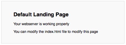

.....here is what I experienced since yesterday:
  • I removed all port forward settings from my router
  • I rebooted router as well as unRAID server
  • I added the port forward settings into the router again and it reported: MyFritz address unknown (this is my DNS provider)
  • After a few minutes the router accepted the port forward settings and provided the address
  • I started the container
... and surprise surprise without modifying any settings from yesterday I saw the Default Landing page (I guess that is the one I want to see, no? Pls. see picture attached) from Nginx. Here is the part of the log reporting success:
- Congratulations! Your certificate and chain have been saved at /etc

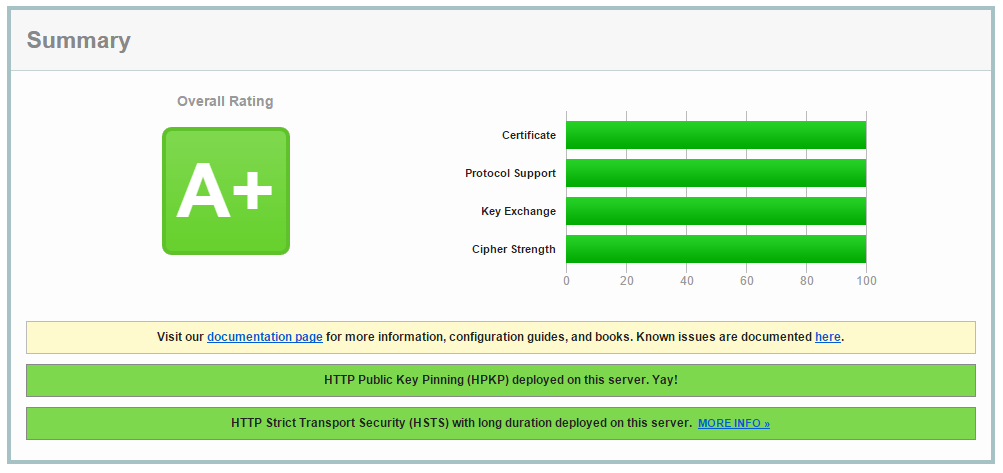

I have just taken the liberty to create a pull that should allow me to use 4096 Bit keys. I have manually replaced my dhparam file but would rather not do manual tinkering with letsencrypt.
Would you be as kind as to add this option to increase the 2048 value?
Thanks
(find attached the reason of my messing with your setup.. the 2048bit key is the only thing keeping me from a 100/100/100/100 score. unneccessary though that might be)
Thanks
Thanks

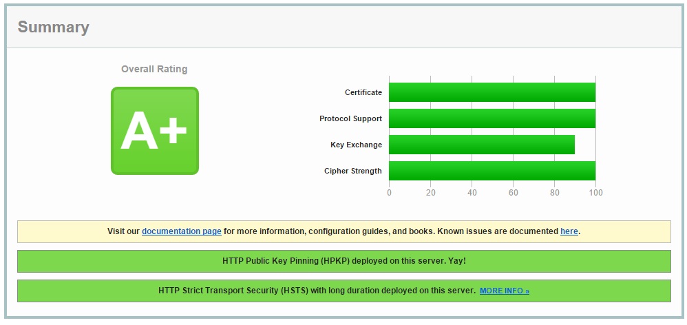

I went into the docker and modified the key generation to 4096bit. (changed /defaults/letsentcrypt.sh)
Still "only" 100/100/90/100, I think the issue ist, that the keychain includes the 2048bit keys from the LE CA itself, but I could be wrong.
*EDIT: never mind, I was missing "ssl_ecdh_curve" settings für 384bit+ setting. Addes that and got 100/100/100/100 with 4096bit keys.
