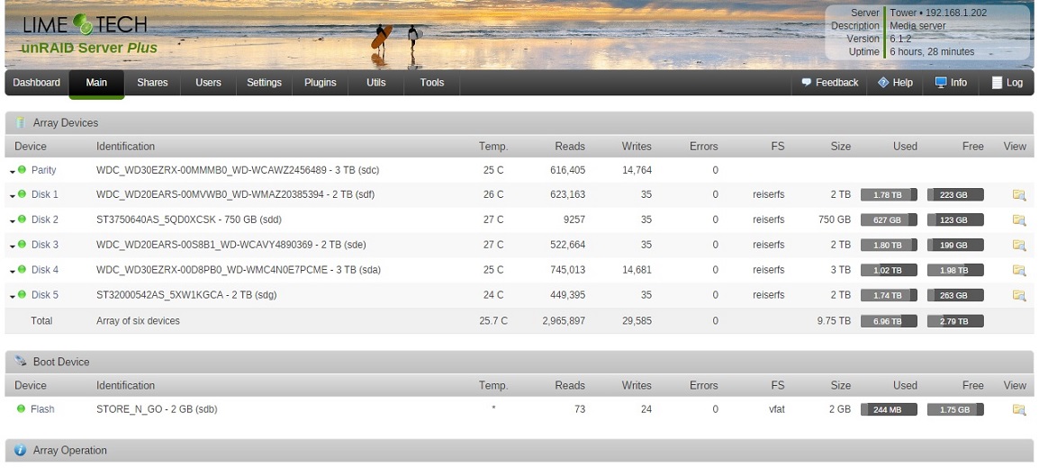

So I had an issue about a month ago that I thought was causing my unraid server to lock up when the uptime hit 7 days (post here: http://lime-technology.com/forum/index.php?topic=43143.0 ). It turns out the timing lined up with an automatic backup I had running. I since turned the backup off and the box has been up ever since then (15 days or so, I believe). This afternoon I started to move some movies to the array and toward the end I got the exact same lockup as before. I didn't post diagnostics because I've had to kill the power to get the box back up and running, but I will post a screen shot of the main screen. When the box came back up I was able to transfer the remaining movie files to exactly the same place on the array that I was trying to before without issue. I also noticed that when the box is locked up 2 drives physically have a red light instead of a green, these are disk 4 and the parity drive. I also noticed that I had one drive with a red "SMART status" in the dashboard tab and it says "1 reallocated sectors", but this is disk 3. I'm not sure it all really adds up in my head, but my best guess is I have 1 or more drives that have issues. Let me know if I can post any other information that would be helpful. Thanks in advance.

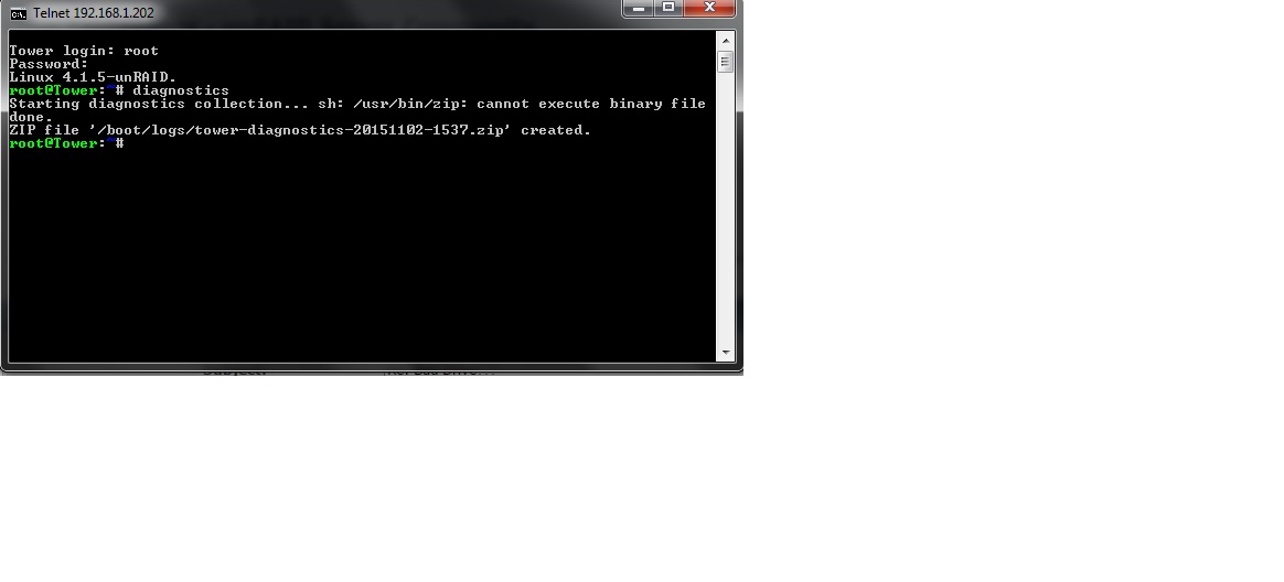

Have you tried running the 'diagnostics' command from a console/telnet session?  If not then it might be worth seeing if any additional error messages are displayed when you try this.  I am wondering if there is some sort of file system level corruption on the USB drive that is stopping the diagnostics file from being written to the flash drive, or something else that is impacting the creation of the file.
Running diagnostics from a telnet session gives the attached, and I can't find the file it says is created. Thanks.

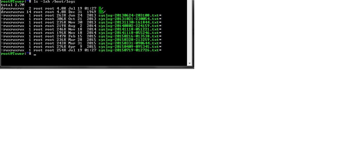

What do you get with this?
ls -lah /boot/logs
The output from the suggested line in telnet is attached. I don't think it's a memory issue since the box only seems to have issue during writes, but I will figure out how to run memtest and get that going ASAP. Thanks.

That line was just a listing of the files where the diagnostics were supposed to be stored, but as you can see, they weren't

I've never had an issue downloading zip files before and I ran the diagnostics a few weeks ago without issue. I'm using chrome now just like I was then. Since I still have a monitor connected, I looked at the output after trying to run the diagnostics and saw lines like:
sh usr/bin/zip: cannon execute binary file
sh user/sbin/dmidecode: cannot execute binary file
Maybe that will shed some light on something.....

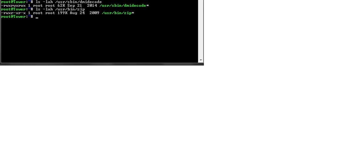

What do you get with these?
ls -lah /usr/bin/zip
ls -lah /usr/sbin/dmidecode
The results of those 2 cmds are in the screen shot. I tried downloading a random firefox zip file from the internet and had no issues with it. I also tried running the diagnostics from several different browsers and got the same error on all of them (chrome, ff, palemoon). Anything else I can try? Other ideas? Thanks.

The commands failing when you try to run the diagnostics command manually is troubling, and could well be pointing to a deeper underlying issue.  The details that you show in your screenshot for the zip and dmidecode files is different to that on my system.  It makes me suspect that you have a plugin or package being installed that is not properly 64-bit compatible, and if this is the case the side-effects are unpredictable.
