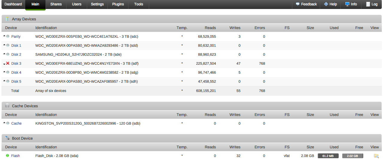

I'm not sure where to start on this. I have been running v5b11 since it came out and haven't had issues. I upgraded to v6 and my disk 3 failed. I purchased a replacement, precleared it 3 cycles without issue, and popped it in my disk 3 slot. Unraid snapped into action to rebuild it. Once it was back online (everything green again), I noticed that I could not access my shares. I could pull up my shares in finder (mac) but each one appeared to be empty. I began researching the reiserfsk tree rebuilding but a scan of 1 of my drives came back with 0 corruption issues so i did not proceed with a rebuild. Now my disk 3 (brand new, precleared x3) has failed again after being installed for a day or 2. I started a parity check at some point and the errors counter flew through the roof. My parity drive is newest of the bunch so i doubt that it's the culprit. Would anyone have an idea of where to start to troubleshoot this? I have 1 particular drive that has very important data on it that I desperately do not want to lose.

Ok, I rebuilt the drive in a different hdd bay with a different SAS cable. It said it was successful and stayed up about a day before redballing again. This is the brand new replacement drive that passed 3 preclear cycles. The drive failed in the middle of a non-correcting parity check. I'm not sure if that's related or not. I am attaching a new log. Any insight or troubleshooting suggestions would be greatly appreciated!
