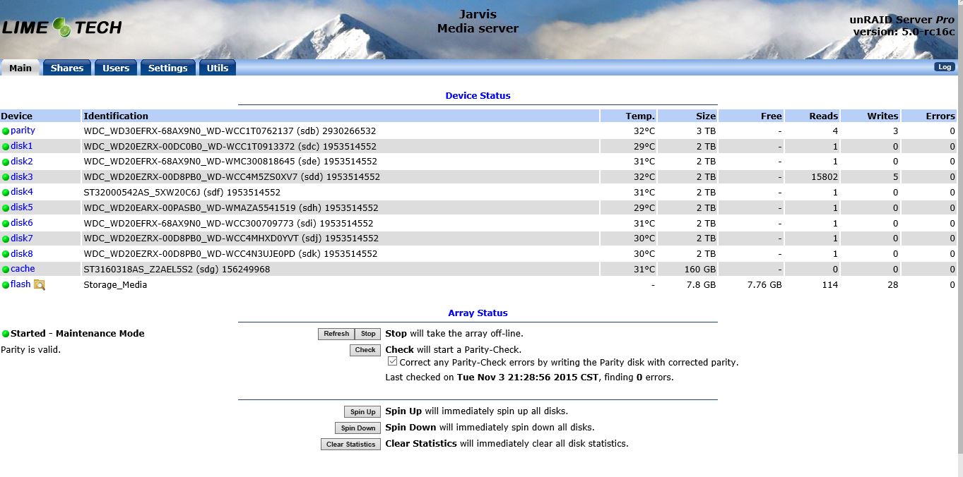

Is disk3 the disk you rebuilt? Did you preclear the new disk?
Post a screenshot of Main, a complete syslog, and a smart report for disk3. See v5 help in my sig.
Read this wiki but don't do anything until we have had a look at your syslog and smart.

I hope this is the Main your talking about :)
