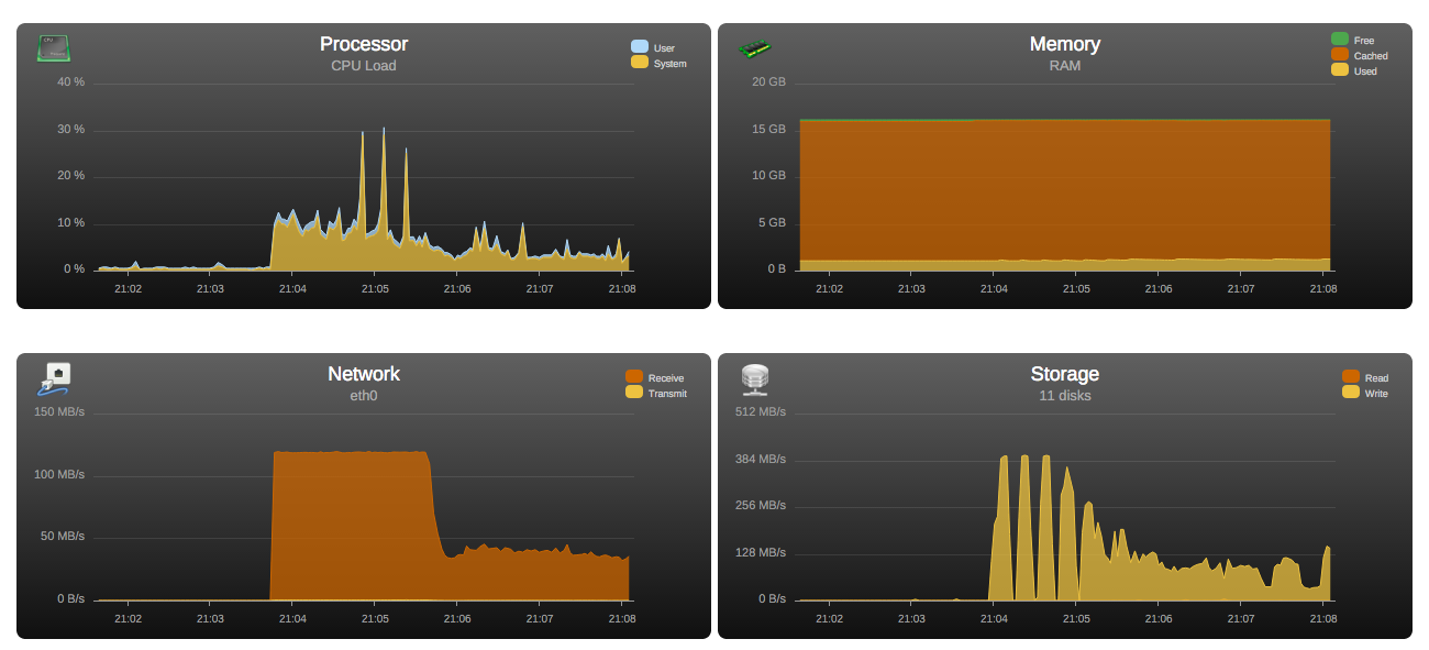

If I copy a couple of movies over to my UnRaid server, the first few Gb go very fast 100-125mb/s. (I have gb network in place).
Then after about 15 Gb the speeds drops to 25 mb/s and doesn't pick up speed again.

I've included a screenshot from a current copy
