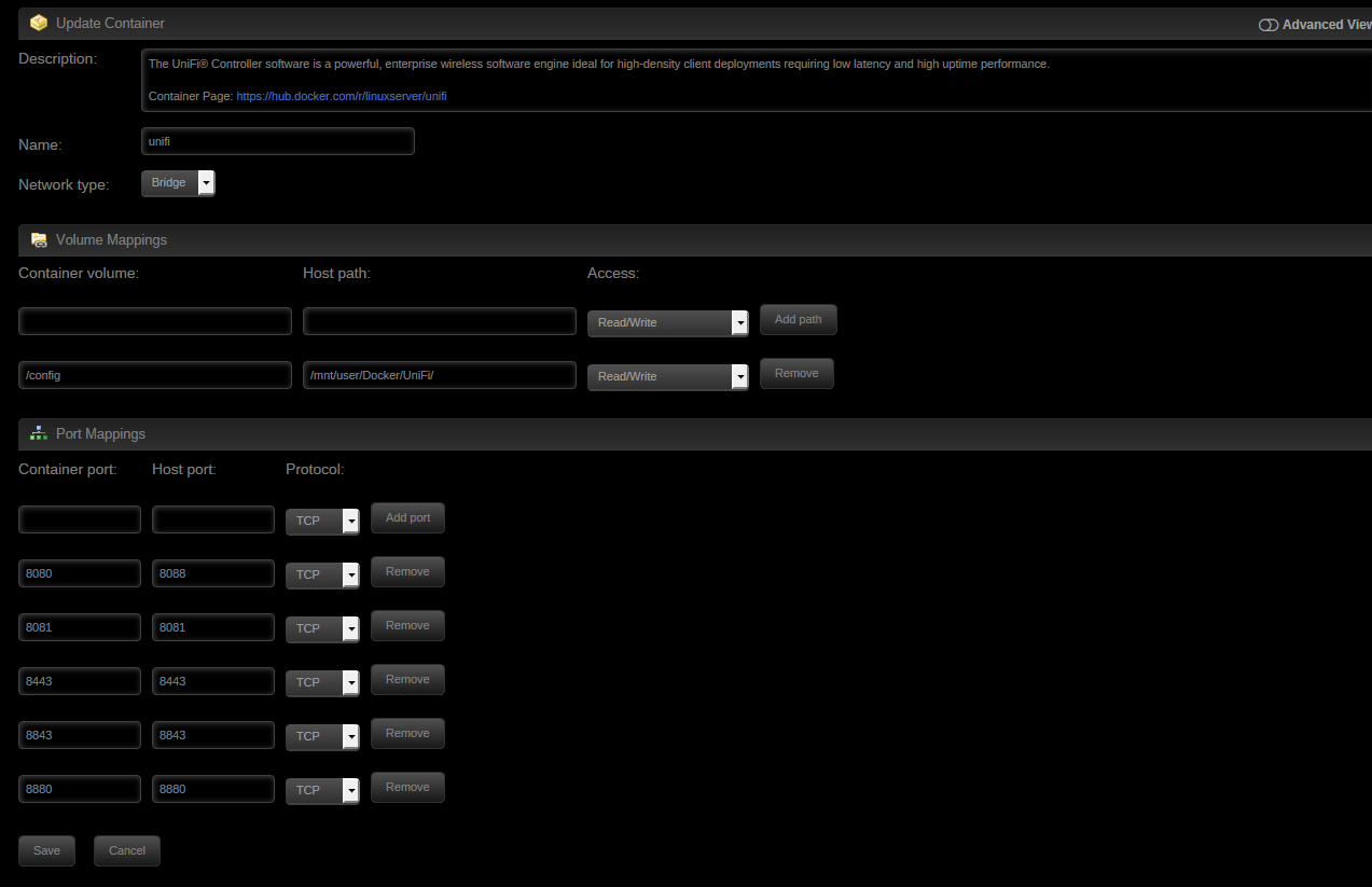

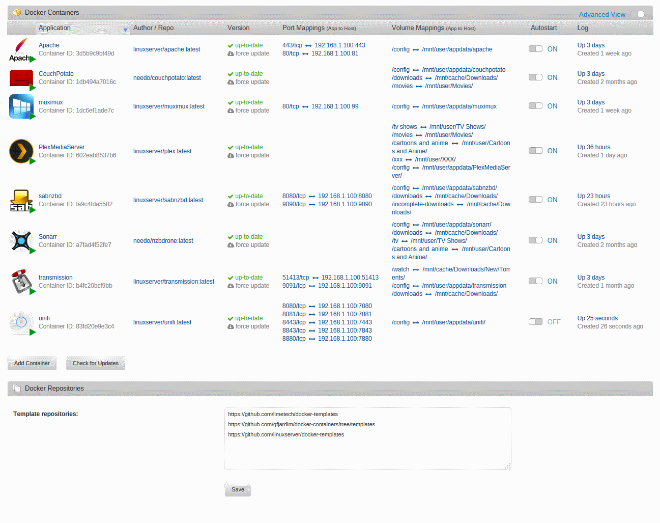

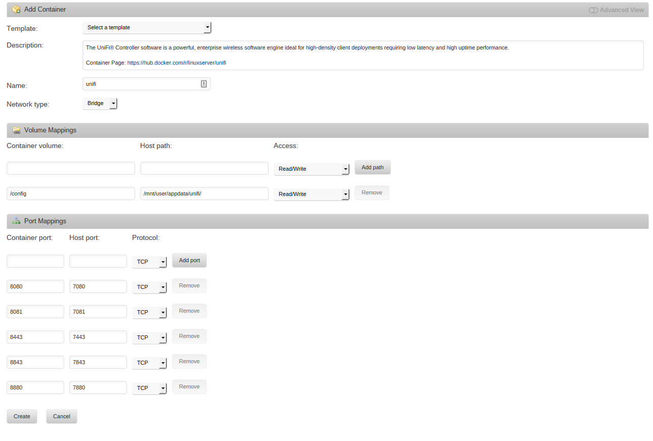

here 3 screenshots of my setup... does this help? can anyone see anything wrong with my setup?
sorry but i am stumped, based on what you posted, it should work
this is what is working for me if that helps
