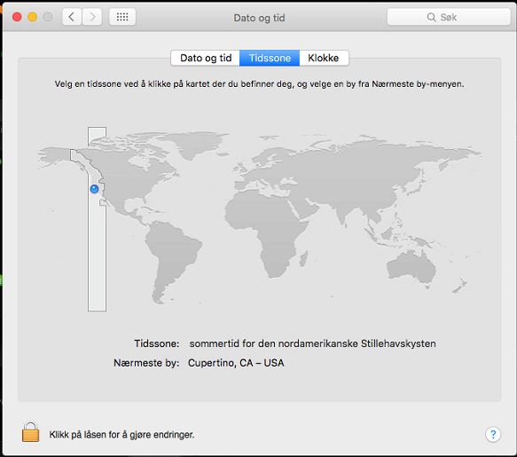

Thanks Archedraft for the excellent walkthrough. I've gotten both Yosemite and El Capitan installed without any issues (haven't messed with passthrough though as there are no GPUs in the system. I use Teamviwer in place of VNC and that works perfectly). Well, except for one little thing.
When I try to set the timezone in Time & Date, there is no other option then PST... I would like to have it set to CET (or at least have it calculate the correct time and dates for DST-changeover), but don't know how. Any suggestions?
You click on the map where you are iirc...
Ok, that was just odd...
I tried clicking the map before and nothing happened. This time I just kept clicking it for a while, and suddenly it allowed me to chose a different region.
Have been a Mac user since 1990 (and mixed Mac and Windows since 2000), and never encountered that behaviour.
Thanks anyways. I was starting to wonder if there was something that needed to be done in the XML or something :) Still kinda new to both unRAID and Linux in general (or the OS X Terminal for that matter). However I'm having lots of fun experimenting with docker containers and VMs
maybe the first time you didnt click on the lock first to unlock it to allow changes?
Yeah, might have been. I was kinda tired at the time, so probably overlooked that :D

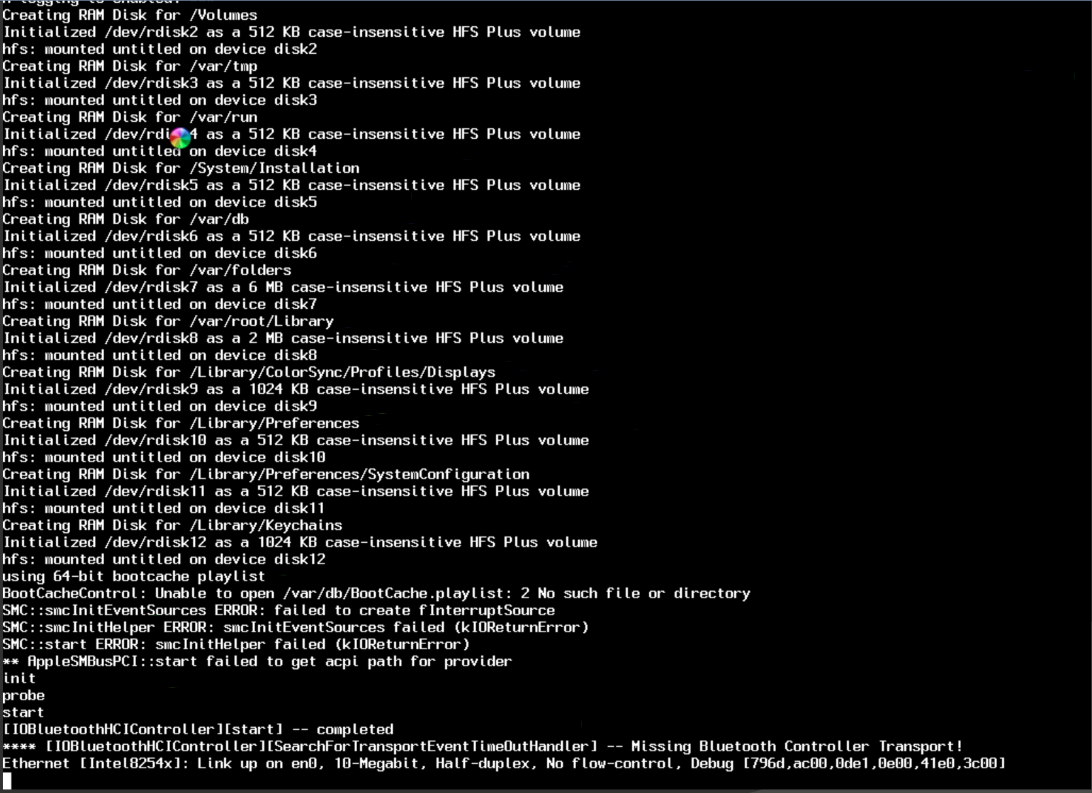

Hi guys,
I have been trying to install an os x vm for a few days now but keep hitting road blocks.
First road block was that I was unable to create a bootable iso because I currently don't have access to a working mac to do it on. So I said, hey, I'll install an earlier version like the snow leopard and use that to make the iso for el capitan. Well, that didn't work either. I tried snow leopard and lion isos and they didn't work for various reasons (snow leopard just got stuck right after the apple logo, with a white background and the spinning wheel of death).
Mavericks came closest to actually installing. With verbose, I can see that it did a bunch of stuff, but then got stuck after finding the ethernet. Attached is the screenshot I got. Still, the spinning wheel of death. I don't even get to the welcome page.
I used the template from the first post with the latest chameleon as the kernel.
Any ideas where I might have gone wrong?
Thanks

After several days, I figured out the fix.
In the xml, I changed the machine element to "pc-q35-2.5" from "pc-q35-2.3" and it showed the welcome screen. Before, it would always get stuck on the Apple logo splash screen.
Archedraft, could you include a note about it in the original post? I believe in the unraid betas this is a required change as I tried it on various versions including El Capitan, Mavericks, Lion and Snow Leopard.
Thanks
