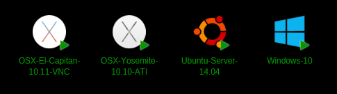

Does anyone know how to replace the Linux icon with an Apple icon?
I do like this....
in my go file I have added this
#Copy icon for OSX VM
cp /boot/osx.png /usr/local/emhttp/plugins/dynamix.vm.manager/templates/images
//Peter
Awesome! (but how do you change it after the VM is created? I don't see a spot in the XML :) )
EDIT
NVM figured it out :)
