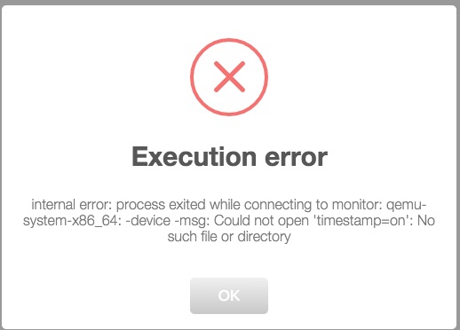

I am on step 20 of Archedraft's guide and I am getting the following error when I try to start the VM after editing the XML.
Here is the XML for my OSX VM.

Just thought I would chime in and say that I haven't had any time to mess with El Capitan recently. Honestly I am still running a Yoesmite VM so I am not sure if the 10.11.2 update broke anything or not. I do plan on revisiting this once unRAID 6.2 is released. I want to try my luck with OS X and OVMF. In summary, until 6.2 comes out and I have time to revisit this I can't really say if this guide is working anymore.

I added the XML back and was able to start the VM, however when I follow step #20 and remove the XML lines I get the same error when trying to start the VM? Any ideas? CHBMB can you check your XML against mine?

Ash, you're missing these bits at the end...
<qemu:arg value='-smbios'/>
<qemu:arg value='type=2'/>
<qemu:arg value='-device'/>
<qemu:arg value='ide-drive,bus=ide.1,drive=MacDVD'/>
<qemu:arg value='-drive'/>
<qemu:arg value='id=MacDVD,if=none,snapshot=on,file=/mnt/cache/vm_images/Install_OS_X_10.11_El_Capitan.iso'/>
</qemu:commandline>
</domain>
Now no more help until you learn how to wrap the code on the forum....  ;D
