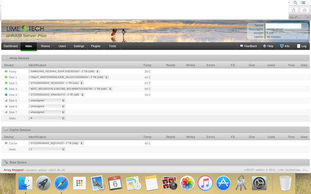

For some reason unRAID thinks that the parity is smaller than the new disk.  Posting a screen shot of the main tab should allow us to see if this is the case.

What's puzzling is disk1 is also smaller than the new drive, and the same size as parity:
