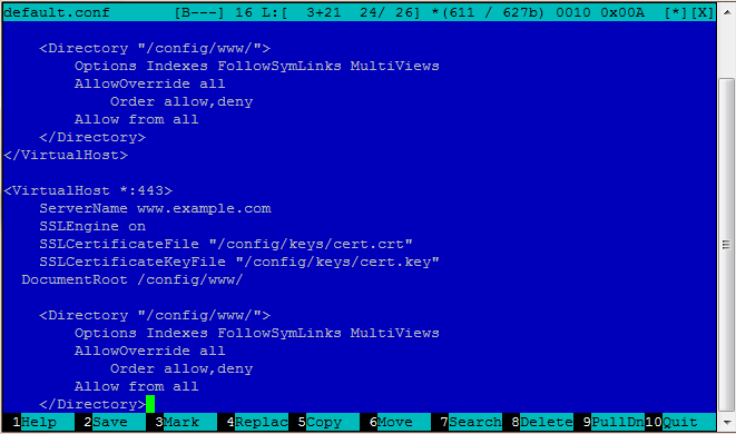

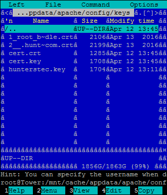

Can you please help me get ssl functioning?  I cannot seem to get it going with a personal startssl cert.
Info
I bought a domain from godaddy.  My domain is "hunterstec.com.  I paid the $60 for a 2 year personal ssl certificate.  I went through all the steps to obtain the cert.  I followed the following link to assist me in installing the certificates that I obtained from startssl.  https://www.linuxserver.io/index.php/overview-reverse-proxy-with-docker/add-ssl-to-your-apache-reverseproxy-docker/  Here is what I have:
a .key called hunterstec.key
a cert called 2_.hunterstec.com.crt
a SSLCertificateChainFile called 1_root_bundle.crt

I am attaching my config screenshot.  What I have tried (and has not worked)is:
I changed the cert.crt to 2_.hunterstec.com.crt and changed the cert.key to hunterstec.key.  Saved the config file.  Restarted Apache.  This did not work.  I then repeated the steps above but also added an entry for SSLCertificateChainFile (this made no difference).  What am I missing?
I placed the files this path
Apache/config/keys
FYI
I managed to get this functioning.  I only utilized the  2_.hunterstec.com.crt and the huntertec.key.  I had to rename both files to cert.crt and cert.key.  I replaced the files located in the keys folder.  I now have a function ssl connection to my apache server using a startssl personal ssl certificate.
