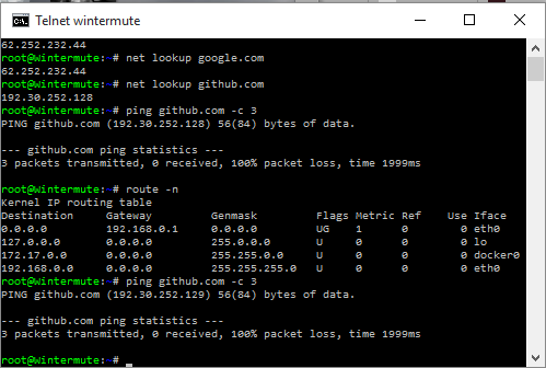

First I tried:
ping github.com -c 3
3 packets transmitted, 0 recieved, 100% packet loss, time 1999s  :o

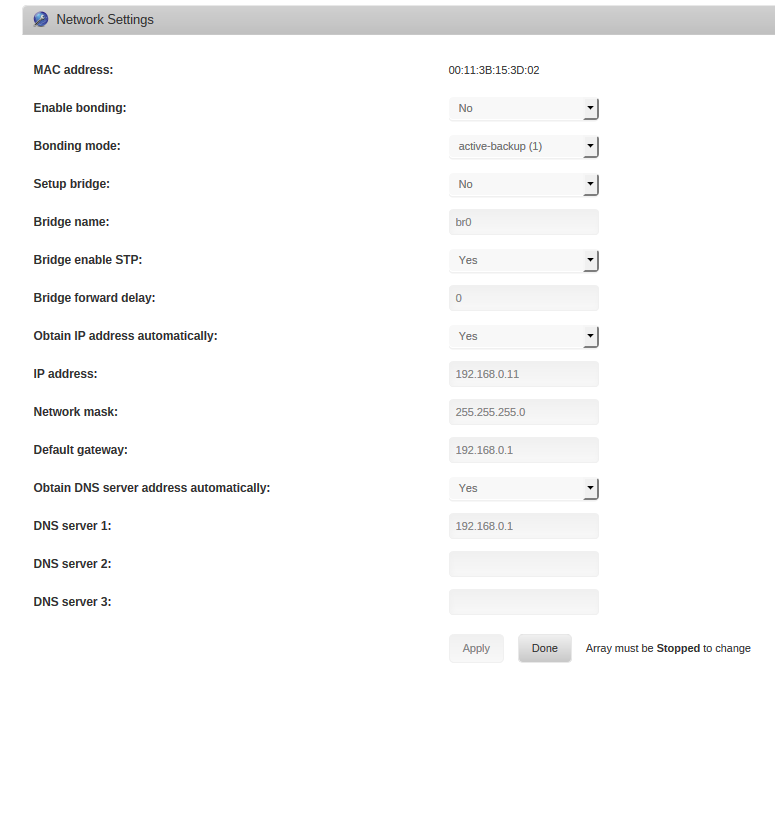

Then I tried manually setting a DNS address in Settings / Network.  8.8.8.8 and 8.8.4.4
Just tried to ping again and got:
ping: unkown host github.com
Which is now more confusing!
I've tried auto-ing the dns and IP again and they go back to 192.168.0.11 (unraid) and 192.168.0.1 (router)
