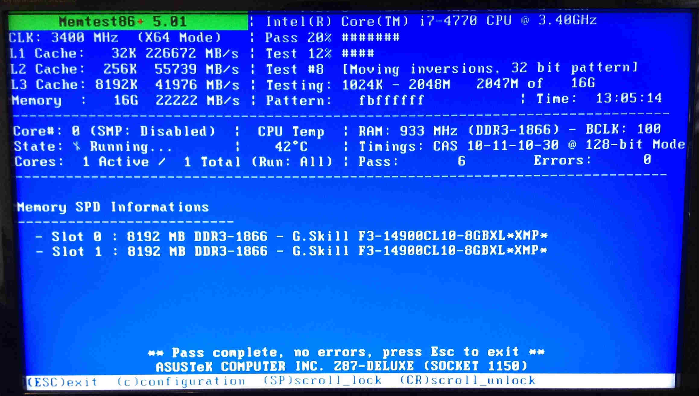

Have you tried running Memtest just to remove that variable from the equation?
Yes...
It took forever...
But no errors...

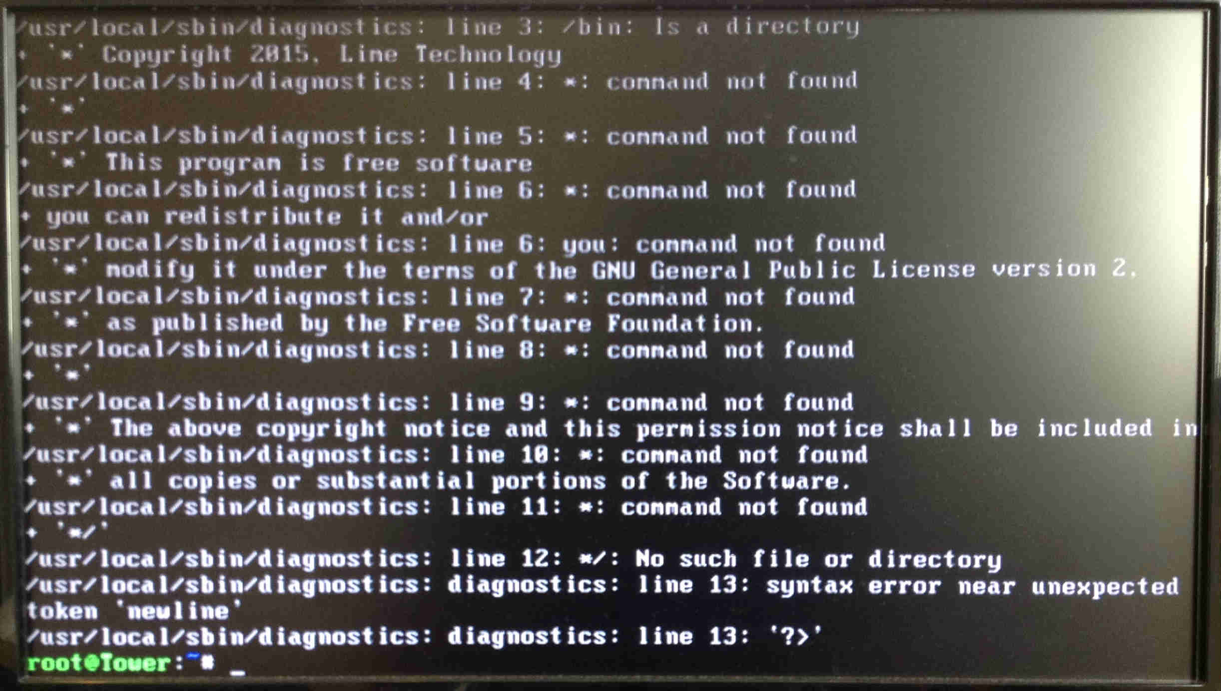

If the 'diagnostics' command from a console/telnet session does not complete then there is something very wrong with the system as it should always complete successfully (even if an error message is displayed while it is executing)..  This is not something I would expect could be fixed by a new unRAID release.  I would suspect something like a RAM issue.
You might get a bit more of a clue of what is happening if the command is run as
sh -x diagnostics
as that should show the details as to how far it is getting.

I've run MemTest86 again for 13 hours... 5 complete passes... No Errors... (attach)

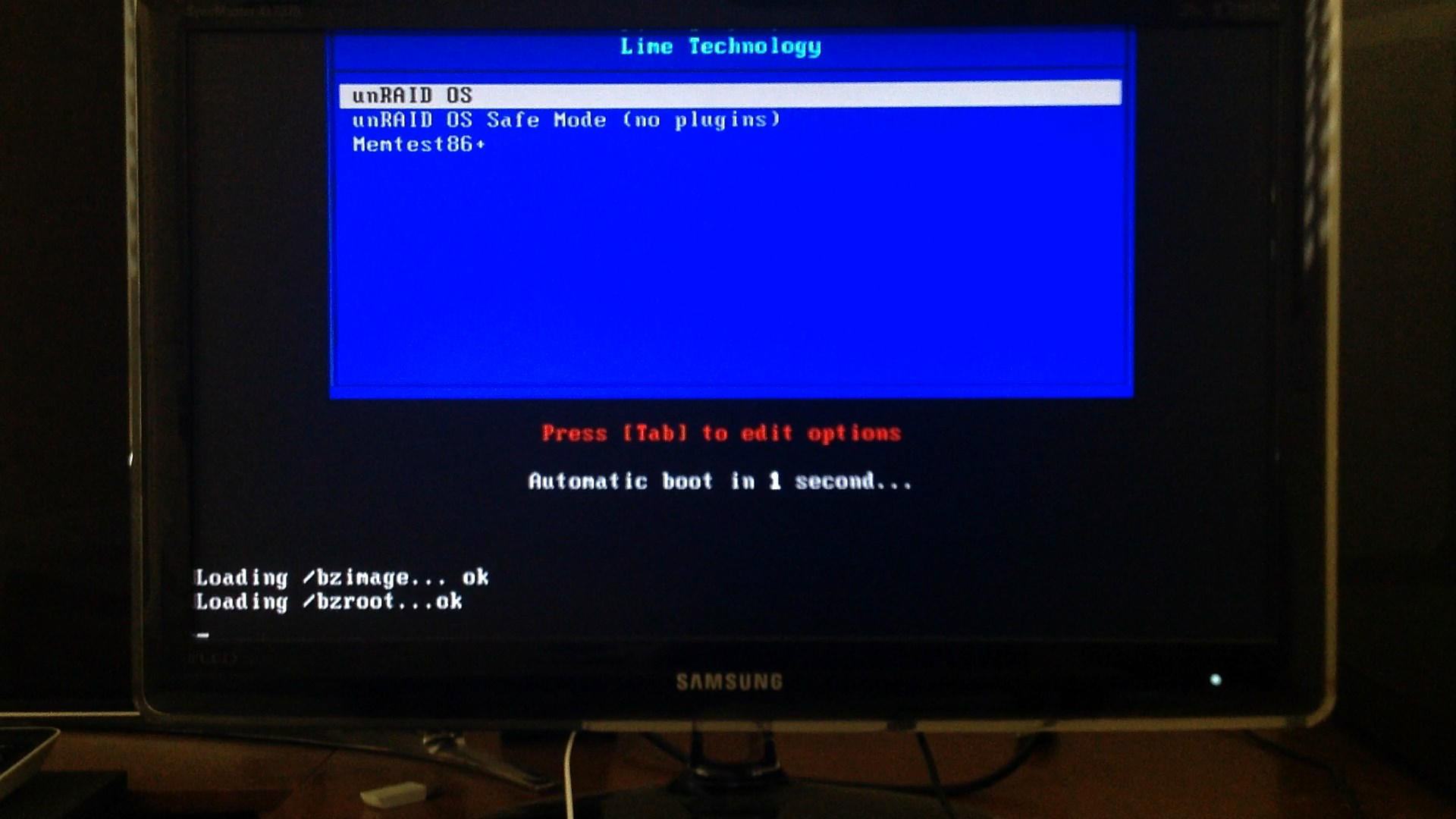

I'll try to record the unRaid boot somehow...
Attach one by one of the images will not work...
Every image is on the previos Google Drive Folder...

(Attach) Result Command.: sh -x diagnostics
Sorry - I only realised when I saw this output that the diagnostics is a php script rather than a shell script.    I am not sure if there is a way to get information about the execution from a php script.
