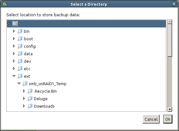

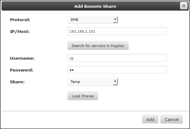

When you did the setup of the network share with Unassigned devices to the remote server, after you entered the IP to the remote server as well as the username and password, where you able to select a share on the remote server? Have a look on the enclosed picture.
In my example the share is Temp (on the remote server) so if you go to CrashPlan and select directory where you intend to store your files you should see something similar to the other enclosed picture.
Thats what i see, but for some reason it still tries to save it local  :(
