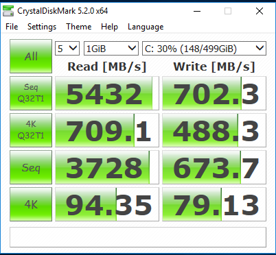

As an additional, i modified by xml so the nvme image user the following
<driver name='qemu' type='raw' cache='none' io='threads'/>
it did make things faster. I have attached a crystal disk mark run on my nvme within 2 vm's booted and running.
The read speeds aren't as high as possible but are pretty quick.

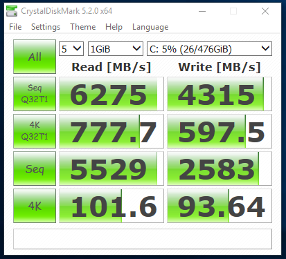

pardon my ignorance.... but from the benchmark image you posted what's the write and read speed I should consider? higher ones seems too high for the supported speed of the device itself (I think it was around 2.5 and 1.2) but lower ones are too slow... I'm confused!
Adding your image for reference:
NzilOFXK+
Well, its not "to fast" or "to slow", its just the whole system from the view of a VM.
2.5/1.2 are the theoretical/tested values in a "normal" system.
Which means the driver of the OS can acces your pci-nvme device directly and that device is directly connected to the cpu with at least 4x PCIe3.0 lanes.
In that system, latency and bandwith would usualy not be reduced or enhanced, so the measured results would be your disk.
Changing anything will end up with other results. Adding multiple virtualized layers (vDisks, vCPUs, vMEM, etc.) will normaly increase latency and depending on the system reduce bandwidth. In that case, you would end up with ~50% to 60% of the raw power the disk alone would be capable of. As you can see in the "too low" values.
On the other Hand, virtualization can add a lot of perfomance. For example changing the vDisks cache mode will result in the "too fast" values. The VM thinks that a block was written, but the VM-Host actually just put it in its RAM and writes it at a later time. So your VM can write to its Disk as fast as the host can put it in its RAM... Great to move big chunks of non critical data around, for example while doing a backup or installing a new system.
That is obviously very unsafe in case of a powerfailure (or similar errors), which would result in dataloss an a potential corrupt filesystem
If you want what you paid for (~2.4/1.2), you need to go with pci-passthrough. The overhead is very limited and you would achieve 95%+ of your nvme disk. But the disk could only be uses by one VM...
Outside of any VM (as a cache device or "unassigned disk") would count as a default config and should give you ~2.4/1.2.
As far as I know, VMware is currently the best vendor in keeping that overhead to a minimum, so you could achieve maybe 70%-80% on an ESXi host, but that comes at the cost of compatibility, consumer hardware won't get you far in VMware.
Qemu/KvM is getting there and LimeTech is doing a good job of optimizing perfomance/compatibility/usability.
My personal opinion is, 60%-70% of the raw speed of NVMe ist still more than enough for any workload and I can share it with many VMs and even unRAID itself. Its still faster than any SATA-SSD would be at 100%.
I hope that answers your question, if not be more specific :)

Well, I finally got my new kit.
This is an nvme P600 Intel drive, mounted and added to Win 10 directly (not part of the array).
These numbers look suspicious to you (write speed seems very slow compared with others)?
Sorry to double post.. Oh boy, I changed from a mounted drive to a direct passthrough... Those write speeds are looking a bit more spicy now :)
I hate to be the one to disappoint your happiness in getting those speeds. :(
The disk speeds you are getting are not right. Programmes like crystal disk etc dont work measuring vm disk speed due to the caching.
You could try using a programme like
https://sourceforge.net/projects/iometer/
or
http://www.iozone.org/
Manufacturer reports your drive specs as read 1775MB/Sec, Write Speed: 560MB/Sec

Haha, I am not quite so deluded to think they were real - in my heart I suspected they were synthetic numbers (I had in the back of my mind 2100MB/s read for the P600, but you are right). I have done some testing with iometer for work, good call, I will run it again at home.
In fact, I was doing dd tests (writing to zero) to prove some raw IOPS speed on a RAID, only for both Dell and VMWare to suggest I use iometer instead.
Even though my Crystal tests are bogus numbers, there is a definite difference in write speeds now it's passed directly to the VM (rather than passing a mounted partition)... The values aren't right, but the trend is upward - so I can take some happiness from that :)
