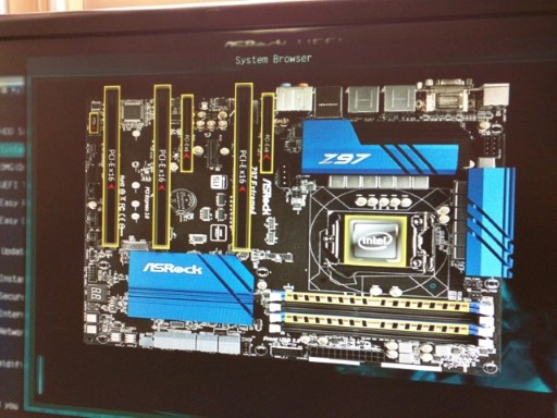

Doesn't come up in UnRaid BIOS doesn't list anything in the slot (ASRock has a system viewer that will list which slots have a card).

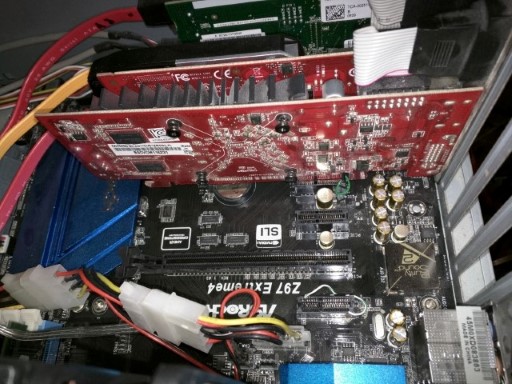

I had a combination of option 3 & 4, and neither card would be recognized. I also have a riser/extension (they are dirt cheap) however prefer to be able to mount the card in the normal way.
So if you do any of the above and the card doesn't come up as recognized in UnRAID (or more importantly in the BIOS if you have a way to check) you may need to short the enable pin.
This is pretty simple to do, and if completing this on the slot, a Cat5e solid piece of wire is a great gauge to use.
You can also short these pins on the card itself if you prefer, it really makes zero difference.

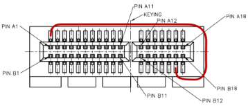

Short out pins A1 to B17 (See pic: 1st pin on longer left back part of slot, to 2nd to last pin on shorter right side of slot away from the back of the case), insert card, fixed!
I now have 4 available cards to use for VMs!
See pics, it may not be the prettiest thing, but solved my issues instantly.
