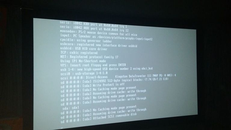

My unraid server won't boot.
I plugged in a keyboard and monitor, and it is getting past the BIOS post, and starts booting unraid, but then freezes/halts before getting to the login screen.
I have re-booted many times, and I have re-seated all power and sata cables.
The bios is reading all drives present.

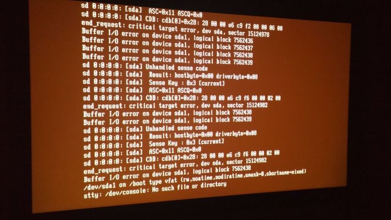

I have attached 2 photos, the one with the black background shows the screen where it freezes every time except for once which is the error screen with the red background, it stopped at this screen one time.
Since you got the red screen of death, the first thing that I would check is to run a memtest for a while (ideally 24 hours, but at least a couple of passes)
Also maybe flash drive corruption. Are you still running 6b15 as your sig says. Latest v6 has automatic fsck for the flash drive.

I put the USB stick in my computer, and it read the drive but it took me multiple tries to successfully make a local backup of the contents, it failed a few times trying to copy bzroot.  I did get a successful copy though.  If I manually copy bzroot over, rather than taking all the files at once, it works.

I tried a reboot and I am back at square 1, it stops booting at the exact same spot as in the attached picture in the first post, with the black background.

It boots once in a while.  The last time you just pulled the stick and effectively reinserted it.
Either something's strange on the data stored on the stick, or the stick itself is faulty (or the mobo is flakey).  Try doing the stick again and go from there.  I would do the stick completely from scratch (just save the key (licence) file.  If you're going to upgrade to v6, effectively you're doing the same thing anyways.
