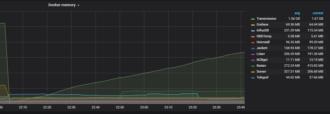

I'm having issues starting today with the transmission container running on my Synology NAS, something had happened in the past few days and I couldn't connect using transmission-remote-gui to port 9091 anymore. When I check the container activity with "docker logs -ft transmission" I see that it keeps looping over and over with some cron jobs:

Other than that all I get from the very start of the container launch is the below. The watch dir not having any space is peculiar, I have no idea why that is, the folder has permissions and theres definitely space left.

Hi running latest the latest docker image of transmission together with the latest version of unraid and I see a linear increase in memory usage in grafana.
see attached image.
how can I fix this? all help is appreciated thx.
