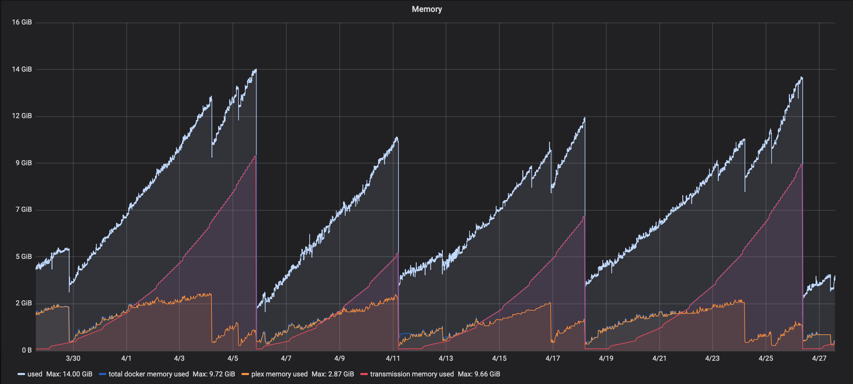

On 6/30/2018 at 2:50 PM, BelgarionNL said:
Hi running latest the latest docker image of transmission together with the latest version of unraid and I see a linear increase in memory usage in grafana.
see attached image.
how can I fix this? all help is appreciated thx.
I saw the same thing, Transmission memory leak over time.  My server would become unresponsive every so often and I'd have to reboot.  Turns out it was Transmission chewing up tons of memory, as can be seen in Grafana.
I fixed this with a recommendation found on these forums.
What I couldn't figure out at first was *where* to put in the '--memory=xG' limit I wanted in place.
I had to flip the toggle switch for  "Basic View / Advanced View" in the upper right, while editing the Transmission Docker.  Then there was an empty field for "Extra Parameters:" where I could put in --memory=4G
I'll let this run a while and see if the system stays stable, and if Transmission can function still when it hits the limit I put on it.
