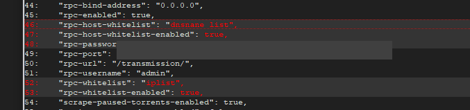

I was facing the issue with RPC "without password" seem like it was in this state multiple months.
Until i found out and removed the former docker, installed latest one.
Now seems like new issue, even i setup "settings.json" it get changed after restart and im not able to use Transmission
I even removed those values from Config in Docker, but seems like they show up again :(
Any clue what else to change to "keep/save" settings i setup? Thanks
EDIT:
I overwrite again the "settings.json", stopped Docker and started - all seems saved now
Also tried restart - settings are kept.
Maybe is some docker "update" in between causing it, will see till next update.
for now FIXED

The container should be stopped when editing `settings.json`. Otherwise, transmission will save its current in-memory version when it exits
i'm aware of that, from some reason even "stopped" changed json and after start old values again...

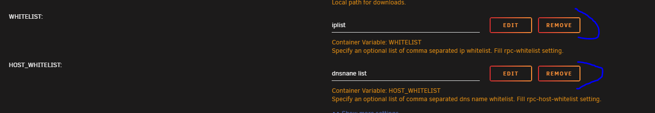

4. remove those "whitelist" fields from docker setup
5. compare old settings.json with new settings.json and modify as needed
No clue what they messed up, acting strange
it's really strange. I removed the container and deleted the appdata/transmission, reinstalled the container, copy the old settings.json to the new one.... no way. Doesn't works. 🤨
dont copy, just edit few values...
it behaves strange and it happend to me even i removed those "white" values in docker, after restart it was there again.
2nd wipe fix it, then is compare and edited settings.json, no overwrite
overwrite cause that not wanted values were there again

No clue what is wrong, but either after some OS reboot or new Transmission update it puts the default value as when you installed fresh Transmission docker and it put the "ip white list" rule ON again, even i removed it in docker and in settings.json
drives me nuts when i find out after some time that again i cant log in

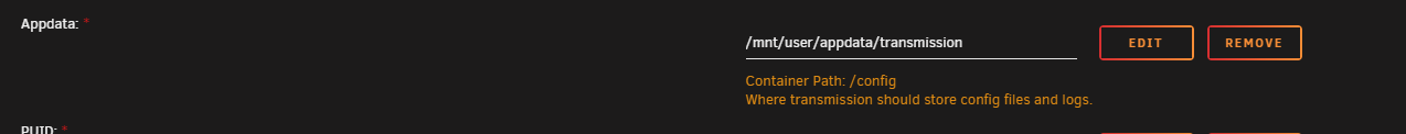

This suggests that you haven't mapped your config to actual storage (appdata)
I did there is = where is randomly changing the "settings.json"
Problem is that it works and seems either after upgrade or OS reboot it get some of the "default" docker settings , as on fresh install. No clue why. No such issue with other docker
