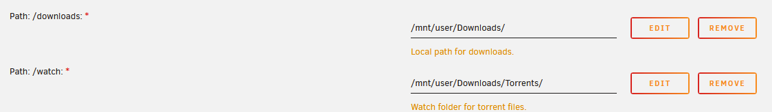

I can't seem to get Transmission to move files to another share. I have these setting for the container:
What I want to do is move files to /mnt/user/Media for instance, but it won't.
I tried setting the /downloads path to /mnt/user/, but then nothing works and my downloaded files don't show up.
What am I doing wrong?
- stop transmission
- move files over from `/mnt/user/Downloads` to `/mnt/user/Media`
- update the transmission settings to point to `/mnt/user/Media`
- start transmission
for transmission, it should not notice any change, it will keep running as if the files are in the same path.
7 hours ago, cherrybullet said:
- stop transmission
No I want to do that in Transmission for selected files, not move the download folder.
Sounds tough. You may have to move all your downloaded files into `/mnt/user` first. Not sure if unraid supports that actually but you could try it and move everything back if it doesn't work out
- stop transmission
- `mv /mnt/user/Downloads/* /mnt/user`
- from within transmission, "change data location" to your desired folder
