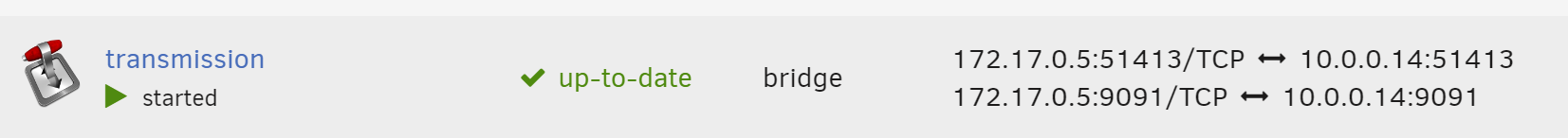

Hello
I tried to read some of the posts to solve my problem to no avail.
I just want to make the Peer listening port work.
Now just to start my tests on the right foot, have a look a the the screenshot please.
Should I use bridge or host mode? I tried to open both 51413 and 9091 ports on UTP and TCP, none worked.
Please help.
