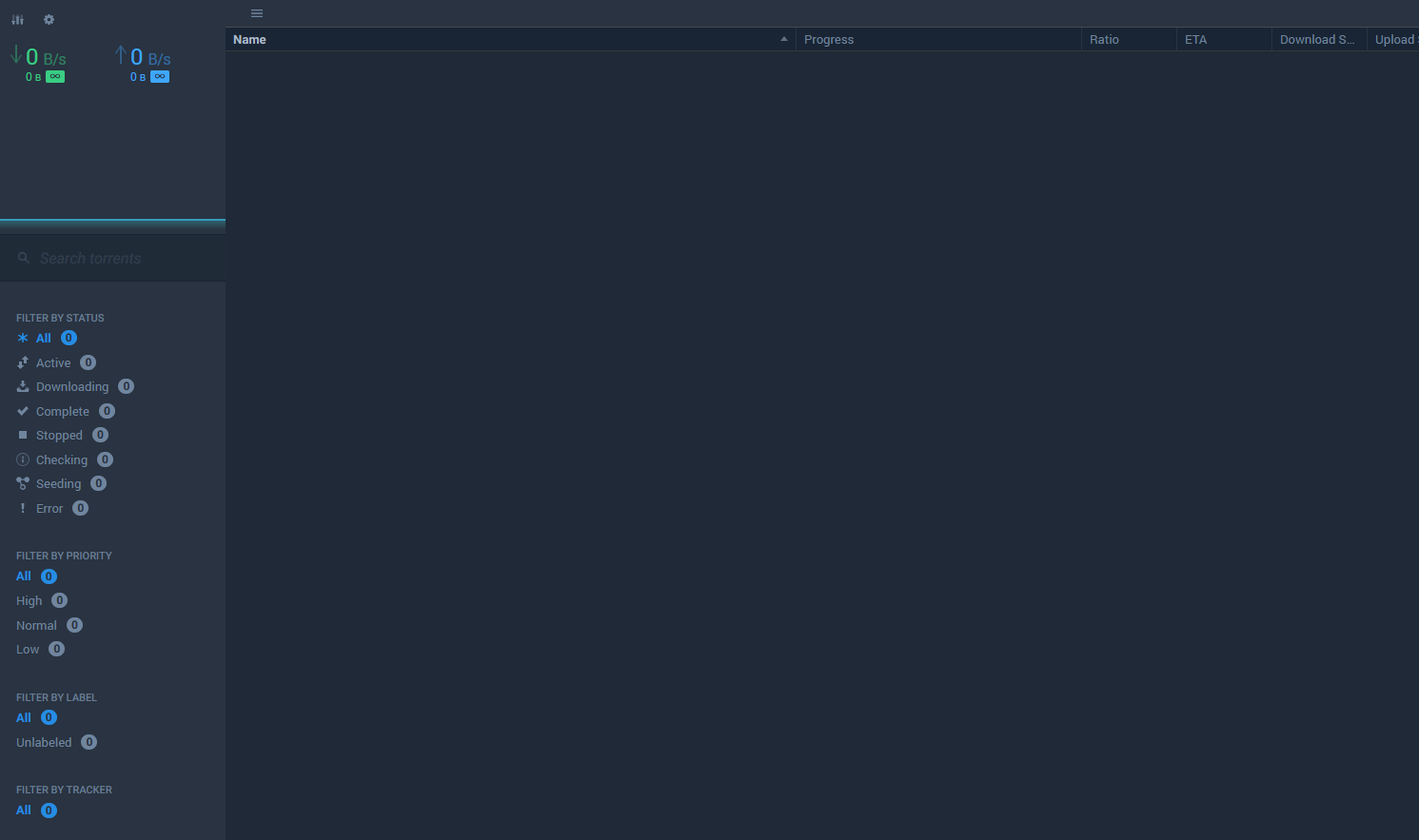

I'm having the following problem. Often Transmission stops updating the browser window and it looks frozen. I say looks because it continues to work on the server side. Then when I F5 the screen I a blank screen. The only way to fix it is to close the browser and reopen it. I tried flushing the browser cache manually, but really the only thing that helps is restarting the browser. This happens in multiple browser and on multiple PC's.

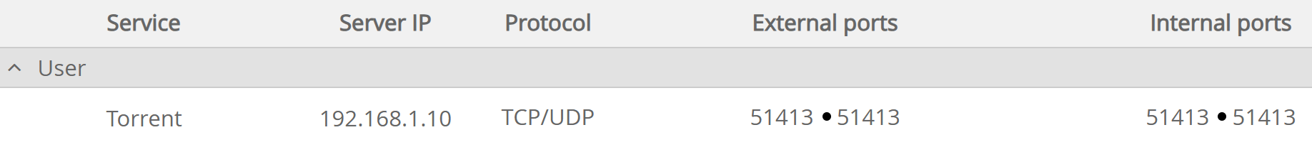

Hello, I asked the same question 2 years ago but never got an answer (or maybe I missed it). So i will try again.
I would like to make the Peer Listening Port work. I have attached a screenshot of the settings in Unraid and my router.
I wish someoe could help with that.
