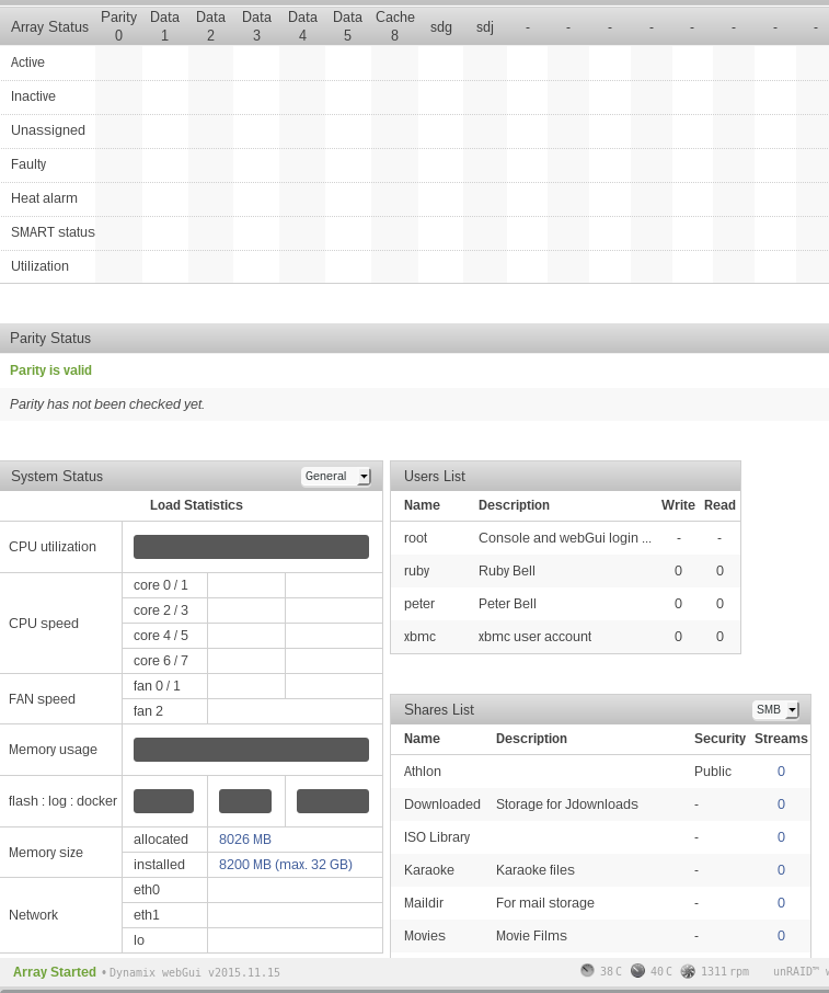

At some time in the recent past (probably around the time of v6.1.3 upgrade), my Dashboard has been missing most data.  I suspect that this problem is only affecting me, since I cannot find any other reports.  I was hoping that the v6.1.4 upgrade might resolve the issue, but it hasn't.  I have tried booting up in 'Maintenance' mode, but that makes no difference (apart from Docker and Shares list data not being available) - I presume that this exonerates dockers/plugins.
The missing info is:
  All the disk statistics.
  The CPU speed statistics.
  The fan speed statistics (although fan speed is reported in the footer bar)
  The network statistics.
I attach a syslog and a screen shot.
Any suggestions as to what is going wrong here?

Added information:
What appears to be missing on the 'non-working' system is some of the data which is subject to live update.  Live update of the UPS status is working, but 'live update' information in the Array status and System status is missing.
Comparing the page source between the 'working' and 'non-working' systems, the source looks to be identical.
I am guessing that the part of the page source which looks like:
<td>core 0 / 1</td><td class='blue' id='cpu0'></td><td class='blue' id='cpu1'></td>
is meant to use the "id='cpu0'" to populate the table with the live data.  It is this which is failing.

Manually deleting cookies one by one in Chrome's developer console. Once I deleted the cookie named "share mode" (which was set to "2") and reloaded the page, the graphs on the Dashboard returned to normal.

The cookie you are referring to is used to select the display of the shares. The value 2 means NFS.

I can confirm this!  Simply switching to 'nfs' in the shares list and redisplaying the dashboard page results in missing data.(and the shares list setting has reverted to 'smb').
Thanks all, for your investigations and feedback.
I've made a correction for the next release.
