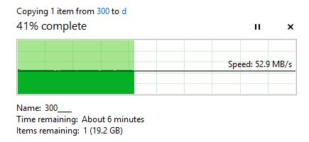

Reading from the RAID is fine. I can copy over the network, at around 60 Mb/s to a gigabit able windows machine and at around 25 Mb/s to an old machine without a gigabit network card. . It's just writing to it that's the problem. That's what prompted my desire to try a cache disk which ended in failure elsewhere for now.

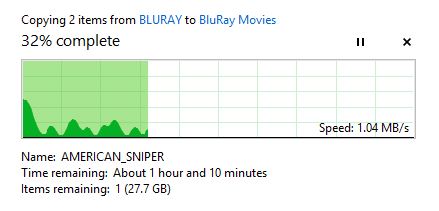

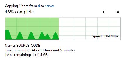

An interesting observation is that when copying from W8.1 to unRAID, a natty window comes up to show the transfer rate in graphical form. I get an intial burst, for a couple of seconds, of 80-100 Mb/s and then it rapidly throttles back to an average of around 5 Mb/s. Another interesting observation is that the resulting graph of the transfer is roughly sinusoidal. Peaking at around 10 Mb/s and bottoming out at around 1.5 Mb/s. I'll post a screen capture of it next time.

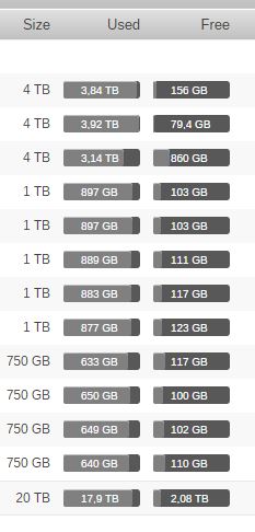

Pretty full, but not so full that it should affect performance I think from reading the guides.

That rapid burst you see when writing to unRAID is likely a cache to cache write and when that quickly fills up it begins writing to the hard drive, and showing your slower speeds.

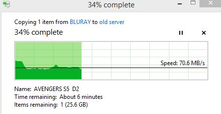

Following Mr-Hexen' advice, I managed to cobble together 4 old hard disks and get them connected directly to the motherboard.
They work wonderfully well! An initial burst of around 110 Mb/s and then settling at around 70 Mb/s. See attached graphic.
This is both good and bad for me as it seems to point fairly and squarely at the 3Ware 9650SE controller card.
