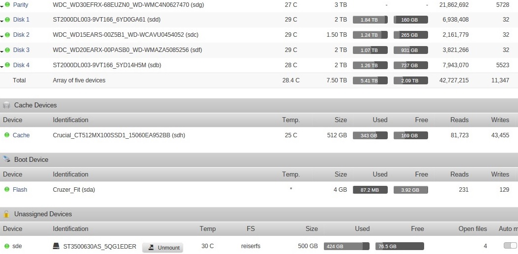

Hard drive layout attached as image.
On bootup, without the array started my Killawatt says 105w or so.  With some load, parity check, docker, and a VM, it bounces between 130w to 160w.  This seems very heavy.  I am figuring 1 dollar per wat, per year.  If this is as high as I think it is, id like to find a way to lower this, with a reasonable break even point on the cost of hardware.
