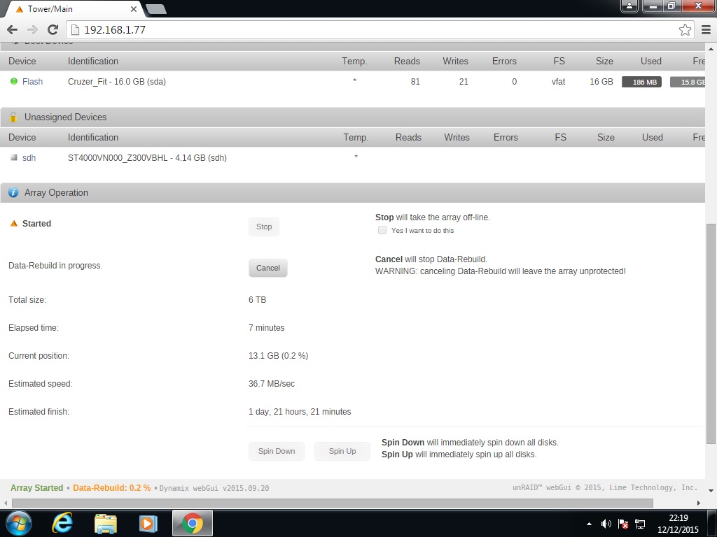

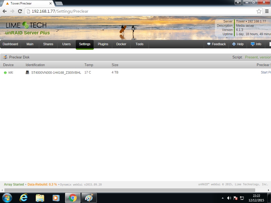

Ok so im rebuilding my data onto the 6tb wd drive and have removed the flaky seagate 4tb from the array.  Now i have restarted the machine the seagate is showing as only 4.14GB not 4TB!!  But in the preclear plugin its showing as 4TB.  Also the serial numbers are slightly wrong.  WTF?
Please find attached screen shots of the SAME DRIVE!
And the second screen dump.
What should i do now?  Thinking of trying to run 3 preclears on it?
Cheers Des
