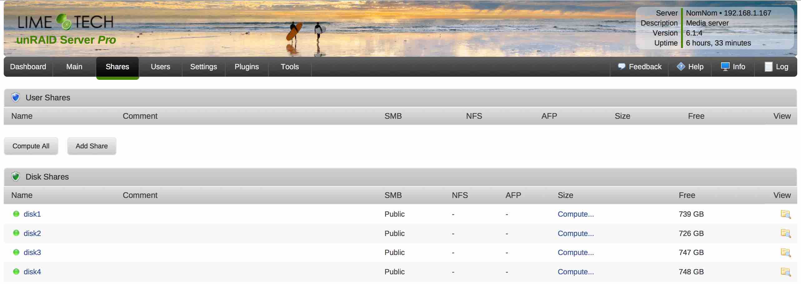

I just upgraded to 6.1.4 from 5.0.6 and for some reason my user shares are missing. I copied the config/shares folder, along with the other important files, from my backup to my USB stick as instructed here: http://lime-technology.com/wiki/index.php/Upgrading_to_UnRAID_v6#Performing_the_upgrade

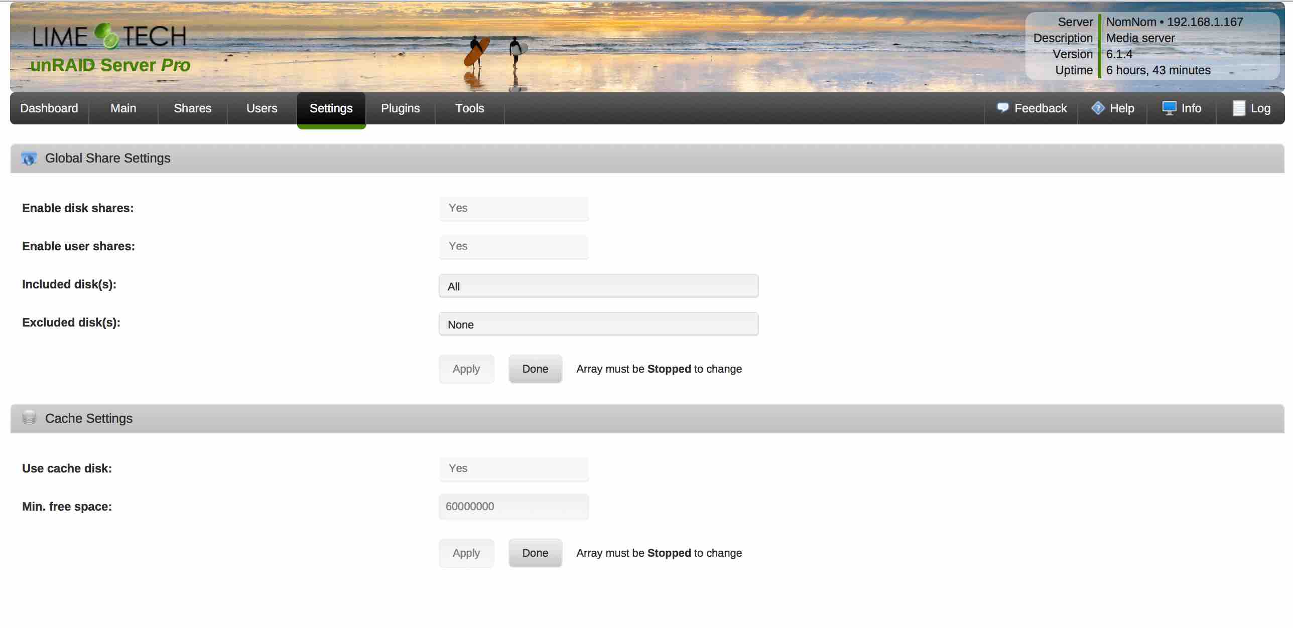

The server boots successfully and I can access the shares through my network but the user shares don't show up in the webGUI. I checked the Global Share Settings and User Shares are enabled. Maybe I'm missing something but since I can't see my user shares I can't modify their settings. I could revert to 5.0.6 but I'd rather be using the latest and greatest.

Can you uncheck the included disks 1 to 5 under Settings -> Global Share Settings, basically this will tell unRAID to include ALL disks and see if that makes a difference.
Are they really missing, or just not showing up in the webUI? If you can still see them over the network then it might be an adblocker in your browser interfering with the webUI.
I had the same issue and it was an ad blocker, Ad Block Plus

After seeing trurl's comment, I added my server name to my Adblock Plus local white list.  Refreshed the page, and lo and behold, there are all my shares!
So this started when I updated to 6.1.4, but honestly, it may have been updated from older than 6.1.3 - maybe as far back as a late 6.0.x.  Something about how that info is populated in the WebGUI is being blocked by ABP.

Starting from version 6.1.4 the disk and user share list is dynamically populated. To the user there is no difference but under the hood it is a very different approach.
Seems adblockers are intercepting the dynamic concept, though nothing suspicious is done.
Interesting point, because I never had troubles viewing my disk shares, just the user shares.  I wonder what the difference is to ABP.
Apparently the name given to the table body in the user shares list:
<tbody id="share_list"></tbody>
