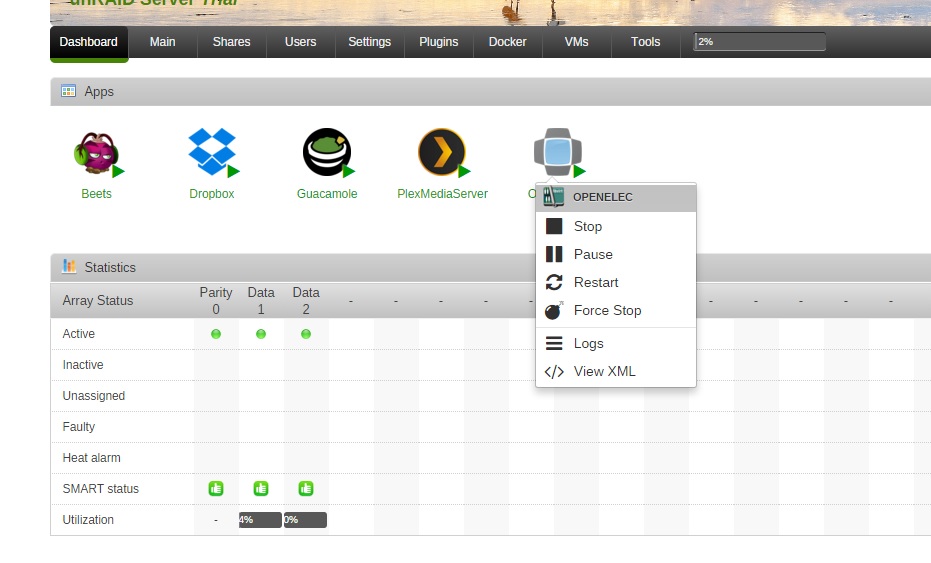

I do not have that option.  I have attached the menu as it appears when I click on OpenELEC.
Apologies. I forgot that this was OpenELEC. What monitor do you have plugged into the graphics card?
