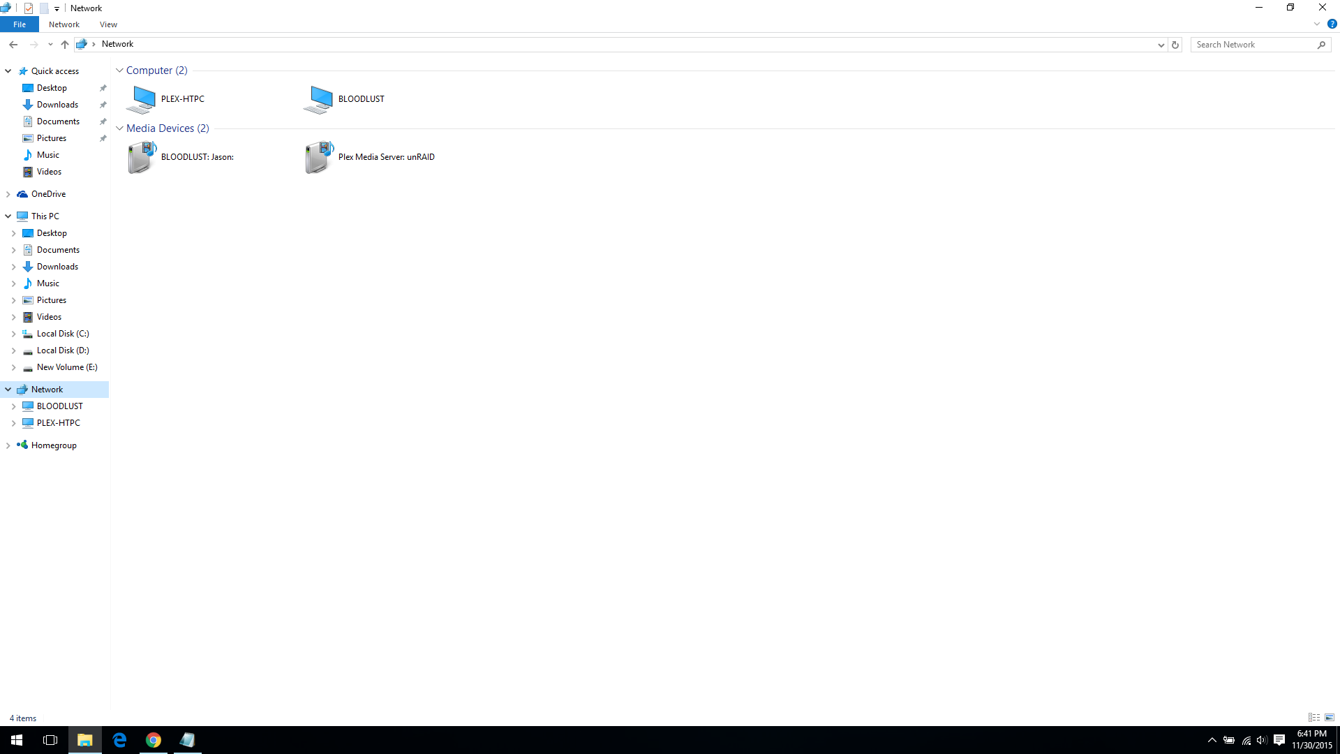

I've done some searching but have not found an answer.  Decided to go ahead and upgrade to Windows 10 from 8.1 today.  However, My Unraid server no longer shows in "network" so I can transfer files.  What I don't get is all my other networked computers show just fine and I have access too.  The Unraid box however is not there.  Any suggestions?
Also, I can connect to my unraid server from the browser of my Win 10 pc, Just can't see any of the drives in the network.

Is your unRAID server setup to be the Local Master?  ('Settings', 'SMB', 'Workgroup Settings')  And is it the Local Master?  If you are running version 6, you can install the "Dynamix Local Master" plugin which will tell you if your server is the Local Browser!  (This plugin will also tell which computer is the Local Master.)
You really want your server to be the Local Master as most of the time, it is always on and that will simplify the 'election' process that must go on SMB networks!  If you want to virtually guarantee that your unRAID server ends as the Local Browser, you can either  create a 'smb-extra.conf' in your 'config' folder on your Flash drive  (or add it to the file if it already exists) with these lines:

What the problem with Win 10 is that MS has increased the default value of of the 'os level' with each new generation of Windows.  Thus, one of your Win 10 machines will become the Local Master on the SBM network if the default remains unchanged.  This becomes becomes a problem if (or when) the Local Master is shutdown.  A new election will be forced and it may take thirty minutes to an hour before the change is picked up by all of the other computers on the network.
I have the same issue and have ended up doing the same as Squid for now. The Win10 November update did this to mine. Has worked fine from 8.1 through initial 10 upgrade. Server has been and still is Browser Master for the LAN.

Yes, The computer is the local master and shown/verified by the plugin you asked me to install.  As you can see from the screenshots, my server which is named "unraid" still is not showing in windows network, My other two computer attached are.  Since my unraid server is the master I'm assuming I don't need to create the config file you stated?  I'm assuming that's not going to fix the problem of my unraid shares not showing up.

I'm a networking noob I suppose.  I really don't follow what you are asking me to try.  Do I type the unraid server address into my browser?
Explorer Window  (\\server-name or \\192.168.xxx.xxx)
Right click on Quick Access and pin current folder to Quick Access

That seems to work.  All my shares are there and I seem to be able to access and transfer data.  So that brings me to the question of why didn't this just show up as my other computers?  Is there any disadvantage on having it setup this way?  I apologize for stupid questions, I'm not that keen on networking.....  I do very much appreciate everyone's help.  Was worried I was going to have to format and go back to 8.1.......
