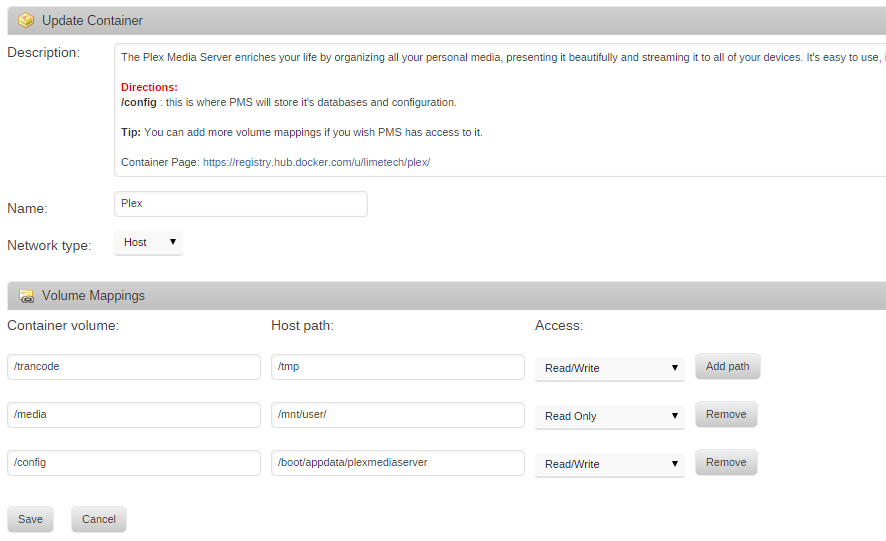

Ok, you understand the risks and like to pursue... It can be done!
Step 1
Create a docker image on your flash device (see attachment). Instead of using the pull-down menu, type the name of the file directly. E.g. /boot/docker.img and give it a size which fits on your flash device.
Step 2
Enable docker, this may take a while
Step 3
Go to Docker tab and create an application, e.g. Plex (see attachment). Also here folder references need to  be typed directly.
Step 4
Start the application and ignore the warning messages...
Some explanation about the folder assignments:
/config -> /boot/appdata/plexmediaserver    (this will store all Plex config outside of the docker image, into the folder appdata/plexmediaserver on your flash
/media -> /mnt/user                                      (use "media" as the reference folder inside Plex when creating media libraries)
/transcode -> /tmp                                        (use RAM memory as temporary storage for transcoding, you need to configure Plex to use /transcode, see Settings - Server - Transcode - Advanced)
I would also recommend to change the backup directory of plex to live outside the docker image, see Settings - Server - Scheduled Tasks - Advanced. Change to e.g. /config/backup
Thanks so much! That's actually pretty easy, and I almost had it right the last time I tried. I will give this a go and confirm whether or not my drives stay spun-down when the result is firm.
