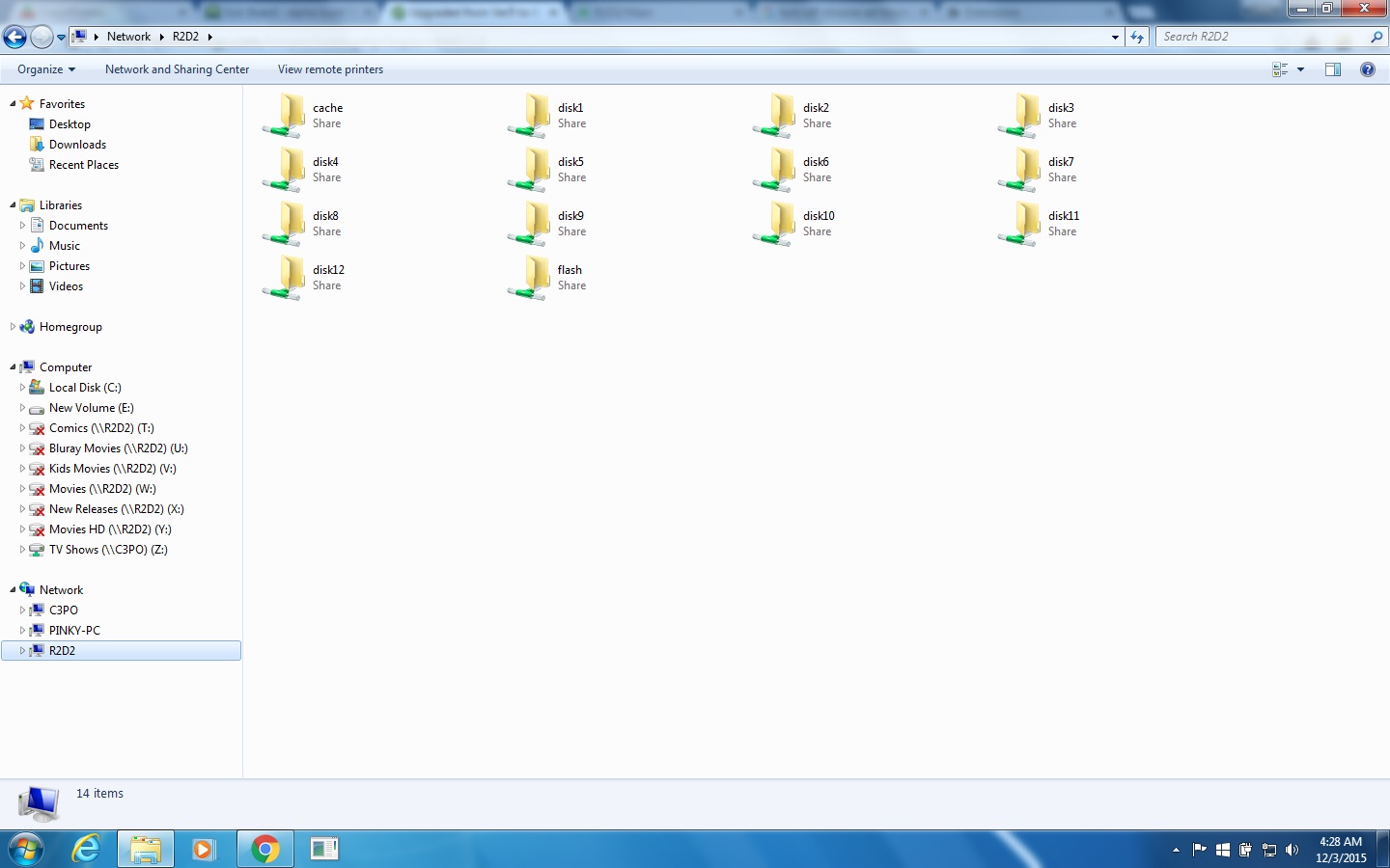

I've included a screen grab of what I can now see in windows. As you will notice only drive shares at this time. :-\
Your include/exclude assignments for the user shares don't look right, e.g.
shareComment="Full Bluray Rips"
shareInclude="Disk17"
shareExclude="Disk1,Disk2,Disk3,Disk4,Disk5,Disk6,Disk7,Disk8,Disk9,Disk10,Disk11,Disk12,Disk13,Disk14,Disk15,Disk16,Disk18"
  • both include and exclude is used, recommend to use one or the other but not both
  • it contains references to none existing disks
As a first step I recommend you set include/exclude settings for EACH user share back to default and see if shares start to appear.
Next re-apply either include or exclude as needed for each share.

The shares configuration is stored on your flash device in folder /config/shares.
You can open and edit the <share-name>.cfg files and reset the include/exclude settings to:
shareInclude=""
shareExclude=""
You might need to restart your system to make these changes effective.

Thank you Bonienl I was able to download Notepad++ and edit my shares as you stated above and saved each file. I then rebooted the server and shares are now visible on windows machines on the network as well as in the Unraid WEB-Ui.
SOLVED
